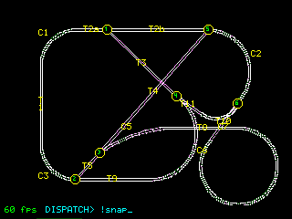

Vibe Virtual Model Railroading
I wanted an application to exercise and test PicoDB . About 8 weeks ago, someone mentioned an interest in model railroad control. After I finished PicoDB, I thought that might be just the ticket. I had an HO gauge layout when I was a teenager, but have hardly given a thought to it in 60 years.
I started work on it with Gemini on February 14. The exercise has been a success--the virtual model train works, and PicoDB serves it (and we found and fixed 4 obscure bugs in PicoDB).
The program, PicoRR.bas, is 2058 lines long. The PicoDB library is 2545 lines. That's 4600+ lines of MMBasic code from Gemini since January 13--50 days, 92 lines a day (but with 2 sets of guests visiting and a porch built on our shed which subtracted about 10 days total).
Here's a youtube video of 4 trains running. The frame rate is only 1-2 frames per second, but if this were translated to an 8-foot by 6-foot layout, the speeds would be pretty much in range: PicoRR Demo  (doesn't hurt to run it an 1.5 speed).
Here's the script which drove the video:

This is running on Peter's Pico2 HDMI PCB:
You drive the trains by typing commands (on PC/laptop keyboard--I don't have a keyboard attached to the PCB) at the "DISPATCH>" prompt on the Screen/LCD. For instance, s6+ve1 20 will flip switch 6 out of spur2 and start up the train behind Engine E1.
Here's the quick help ("?" at the "DISPATCH>" prompt) for dispatch commands at the keyboard.
                   MODEL RAILROAD OS - HELP MENU

There are 3 layouts available at present:
Fuller documentation is in the zip file, which contains everything needed to run on a Pico2 HDMI, 640x480 Mode 3. I think it will work with VGA, but haven't located the boards I know I have somewhere. I have it displaying, but not yet running, on LCD 320x240 and 480x320.
The library (which contains the PicoDB database engine) needs to be saved with LIBRARY SAVE.
There are two driving files: roster.csv (which defines engines and cars), and segments.csv (defines track segments and switches):

I wanted to add a new layout that I had found an image of:
I spent a little time with Gemini and a then little time with Chat trying to get them to produce the segments.csv file that I needed. They were terrible at it--I couldn't even get them to make sure that each segment was connected at both ends to another segment. (I did think that I might have been able to teach Chat to do it.)
So I produced the file by hand--not an easy task. An approximation--topologically ok.
I got it to where it would render, but trains would jump around crazily. So I realized that the original layouts (produced by Gemini through my describing them--much simpler than this one) all had their x1,y1 ends with lower x (or y if x1=x2) first. I had not done them this way by hand, and just randomly as was easiest. Each segment has a Next1 and a Next2 (and switches a Next3) indicating the segments the current one is attached to. So I went through and swapped Next1 and Next2 until they aligned with x1,y1 and x2,y2. The trains all ran fine.
Then I tried the A command (for assemble--build a connected train). And here's where the bad part began. It assumed that the segments were always drawn from the left to the right (or from upper to lower for vertical segments).
I went through several attempts yesterday to get Gemini to get it right. Today, it was a miserable 6 hours and still no success. This is the first time when I really could have done it faster myself--if I had written all the code and understood it.
I don't know where the problem lies. My feeling is that less compute is going into the answers than was the case 4-8 weeks ago. gadgetjack has speculated that AI coding is not good if you're not paying for it. My guess, and it's only a guess, is that you're not going to do as well as I had come to expect if you don't own the compute yourself--either because you're paying more than the $20 subscription, or because you have what it takes to run Claude Code locally.
I have my machine set up, but haven't started to use it. I was hoping to get this step working before making a big change to teach it what it needed to know (and to begin to teach myself what I will need to know).
So I still see the potential as huge. It just may not be as available as it first appeared to be. With so much effort going into building the models, and such explosive growth among users, I suspect that users are going to be shortchanged for some years until the availability of compute and memory increase significantly.
