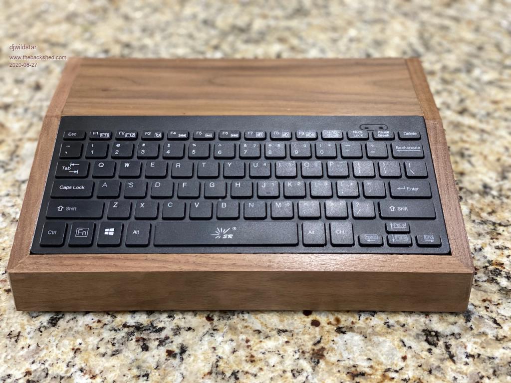

I've just finished a little woodworking project, and thought you folks might be interested.
Like many of you, must first personal computer was a ZX-81 (I built it from a kit) when I was a teen.  I later added on a RAM cartridge, and hacked on a full-size keyboard.  The result was rather temperamental, since any disturbance would jostle either RAM pack or the keyboard wiring.  My father built a wooden case to house it and solve the reliability problem.
So when I got the CMM2, I knew I had to build a small all-in-one case reminiscent of the home computers of the 80's - about the size of a notebook.  I found a compact wired USB keyboard that worked with the CMM2, and decided that I would also wanted speakers and an audio amplifier inside the case.  I also didn't want to lose access to the I/O bus, so I had to bring that out on the back panel.  These features wound up dictating the overall size: the keyboard sets the width, the CMM2 + speakers + back panel clearance set the front-to-back depth, and the I/O panel set the height.
The first photo shows it from the front.  The keyboard (plus the width of the side panels) sets the overall width to about 12.125" (30.8cm).

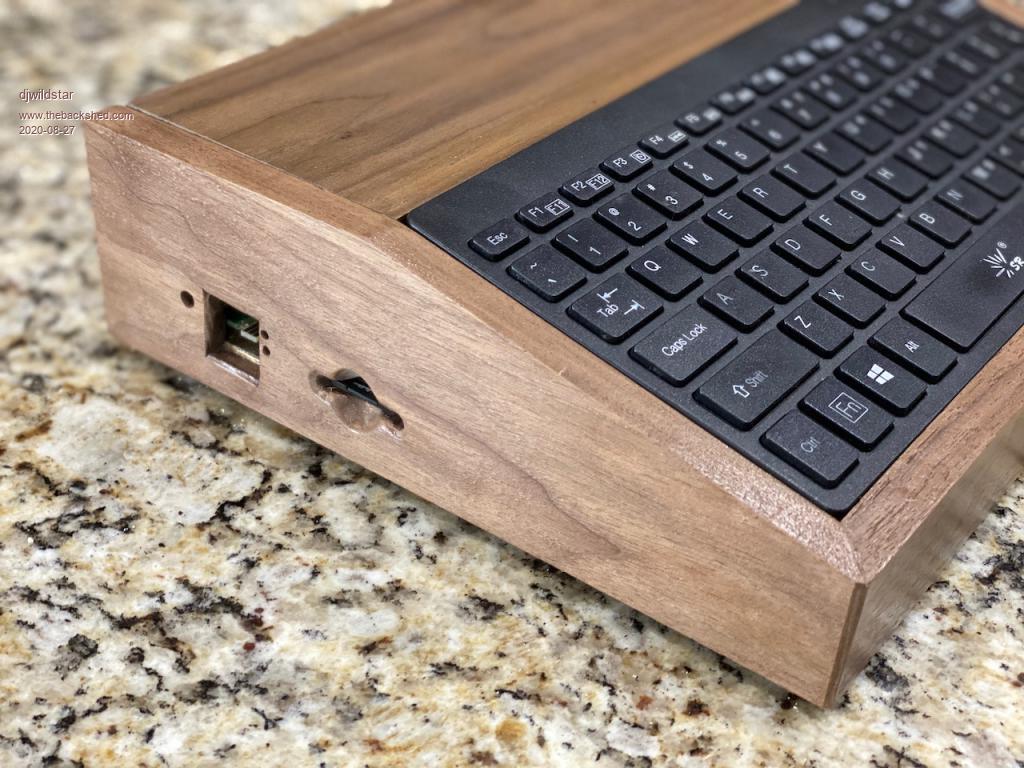

The CMM2 is mounted on the left side, with cut-outs for the SD card and game controller connector.  There are also holes for the IR sensor and the LEDs.  The left-side photo shows these with an SD card inserted.  The round depression lets you insert and remove the card easily (and reminds me of a floppy disk drive).

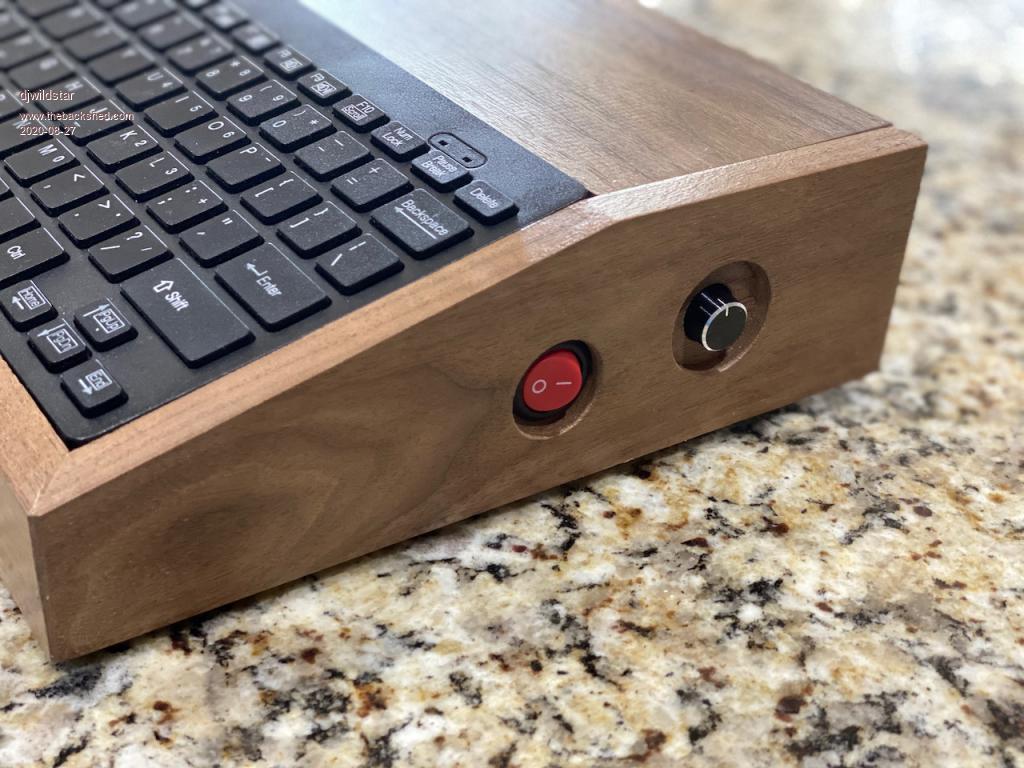

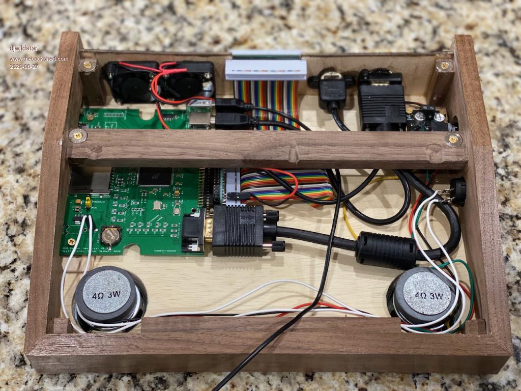

The overall front-to-back depth is set by the CMM2 and speakers, and is about 9.5" (24.1cm). I put a power switch and volume control on the left-hand side.  The amplifier is rated at 5W per channel, and drives a pair of 2" speakers mounted under the keyboard (it can get quite loud).

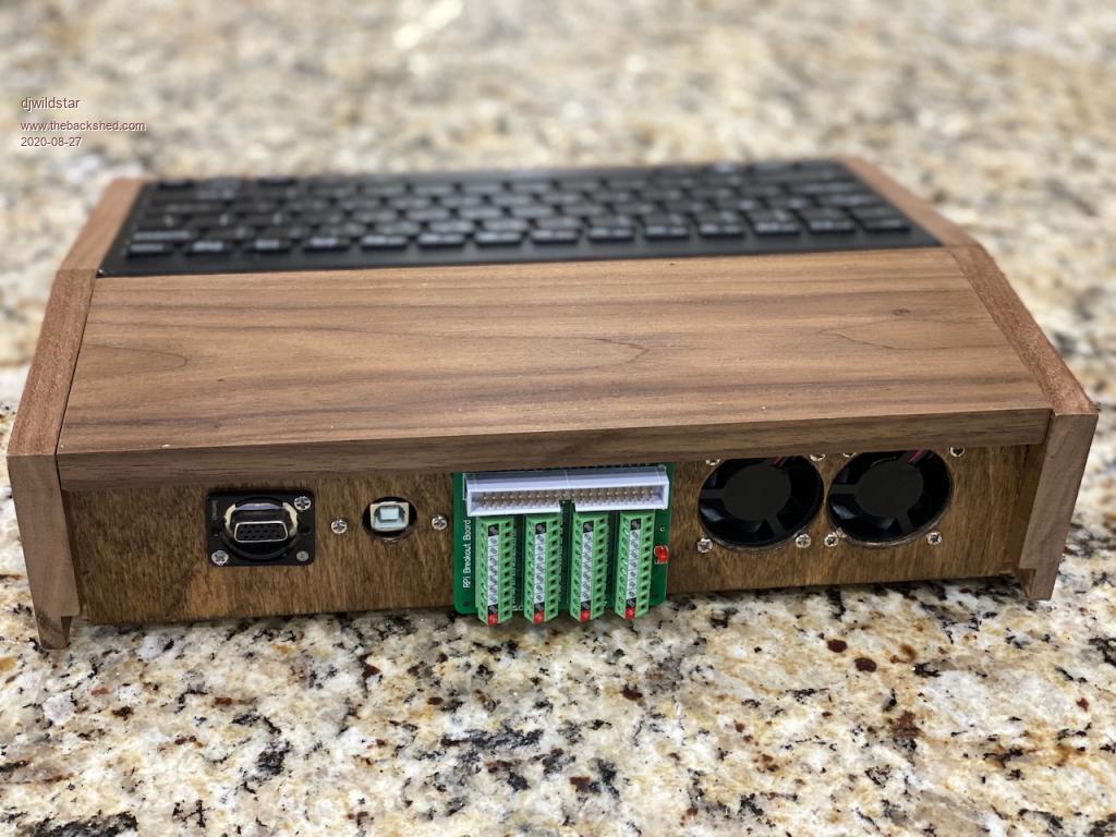

The back panel has a pair of fans (I was concerned with heat build-up in the case due to the audio amplifier) as well as a Raspberry PI I/O board, and sockets for USB power and VGA output.  The I/O board set the height of the case to 3.0" (7.62cm).  The keyboard is a friction fit into the front of the case, and is held in place by a small lip on the top.  The top is held in place by four high-powered magnets, but is eailsy removed for access to the CMM2.

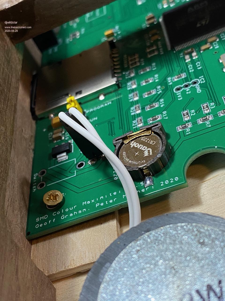

My CMM2 board did not come with a power switch, so the only modification I made was to remove the soldered bridge between the switch connector holes with a pair of jumper pins.  This let me put the power switch on a 2-pin connector (and jumper the pins if in the future I want to use the CMM2 board outside of the case).  There is an internal Raspberry PI I/O splitter, and I added a pair of pins to tap +5v and Ground.  Having the I/O connector inside the case potentially allows me to add expansions inside the case in the future.

For those of you who want to build your own, here are my plans.  Sorry that the dimensions are all in inches and fractions, but I'm in the US so all of my machinery is calibrated this way.  Tools required are a tablesaw, router table, and hand drill as well as my trusty block plane, chisel, and carving gouge (for the SD card recess).  If you have one, a drill press would be particularly helpful.
When working on the cut-outs for the CMM2's game controller connector and SD card port, I printed a full size control panel template and stuck it to the side using repositionable adhesive.  I then cut to the template.  Because of the thickness of the wood, you will have to cut a larger game port opening than the standard front panel - it needs to be large enough to clear the sides of the plug and the clip on the top (on the other hand, this makes it impossible to plug the controller in upside-down).  I used a drill to define the ends of the SD card slot, then drilled out most of the waste in the middle, and finished off with a fine chisel.  I cut the round recess by eye to fit my fingers.
The main change that I would make in hindsight are to stack the USB-B and VGA connectors vertically, instead of placing them side-by-side.  This will leave enough space to the left of the DROK amplifier board to utilize the audio jack.  Due to lack of space (and reports of faulty audio jacks on these amplifiers), I soldered the audio cable directly to the L, R, and G pads on the amplifier board.
If you don't have an old-school VGA monitor handy (I do), you might want to add a VGA to HDMI converter inside of the case, and have an HDMI jack on the back panel instead of VGA.  This would also save space.

But why the 2x fans ? Are you looking at overclocking the STM32 ?

@volhout -- I'm not overclocking the STM32, but I was worried about placing it in an insulated box with a 10W heat source (the sound system).   So I did some math:
For case cooling, the rule of thumb is that the increase in temperature inside the case in degrees F is (3.16 * Watts) / CFM.  I estimated power at about 1W for the CMM2, up to 10W for the amplifier and speaker system (because it is a 5W+5W stereo amp), so 11W plus an unknown additional amount for the keyboard and any future expansions.  The USB power supply I'm using can deliver 21W, so that sets the upper limit.
The fans I used are 40mm 5v 2500RPM fans that are rated at about 3 CFM airflow.  However, it is likely that airflow in the case is restricted.  The main air inlets are a series of holes underneath the STM32 and the amplifier.  Total inlet area is about 0.8 square inches, so that we are probably getting only about half the rated airflow from the fan.
Assuming room temperature of 74F, this means the CMM2 may have to operate in a 97F to 118F (36C to 47C) environment.  This is acceptable but a bit warm for my taste.  A second fan provides some "insurance" against airflow issues - in a restricted case, it won't double airflow, but it will definitely improve it, probably to somewhere in the 2.0 to 2.5 CFM range.  This should bring temperatures inside the case down to 89F to 103F (32C to 39C), which is better.

Maybe reverse one of the fans? Have the one closer to the corner blow inwards and put a baffle between them?
I really dislike the way fans are used on typical equipment. A fan blows outwards. Which means (dusty) air is sucked in through whatever opening are in the case.
When I build industrial equipment, I try to arrange for a fan sucking air IN through a filter. That way, the unit has slight positive pressure with clean(ish) air, which then leaks out through all the holes. As a result, after months or years of service, the inside doesn't look like a badger nest.

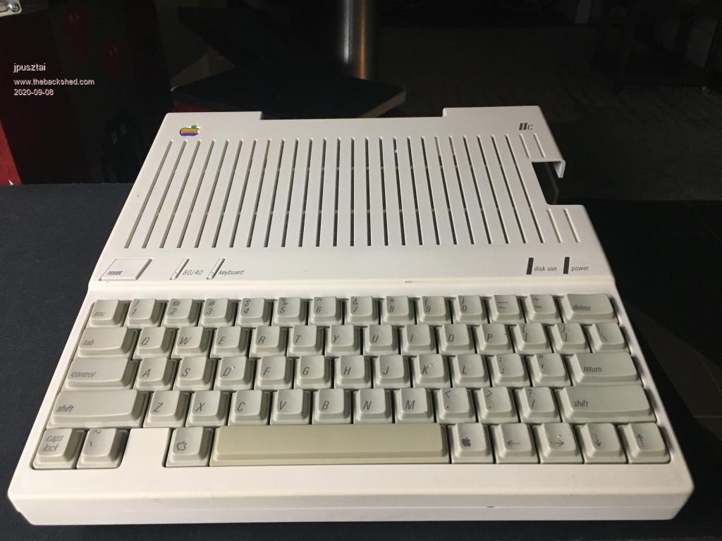

My wood-working skills are not that hot, so I'm taking a more "commercial" approach - here's my CMM2's new home, all gutted and Retrobrited and ready for an Apple //c keyboard-to-USB encoder.
There's actually enough room in there to fit both a CMM2 and RPi, in which case I'll have a portable "Emulation Station" that can run a "real" CMM2 and dozens of emulated 8-bit platforms.
