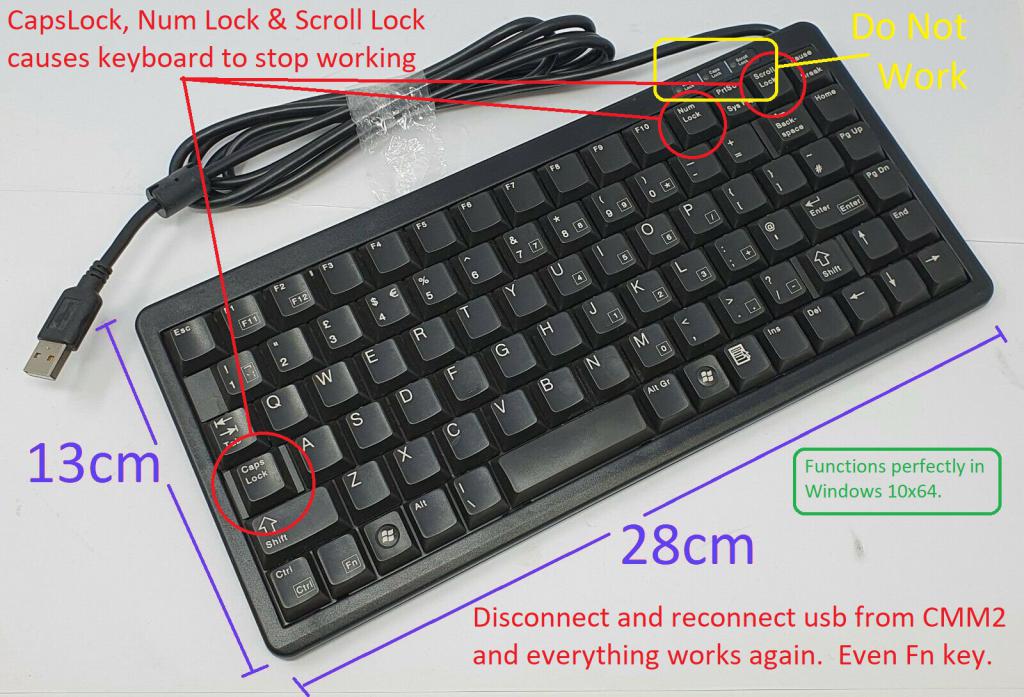

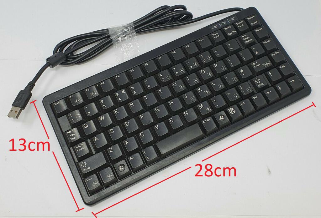

  Nimue said  Plus - got me thinking about a modern USB mechanical keyboard but they cost £££....
I purchased a Cherry Compact G84-4100 Mechanical Keyboard, which I have tested and seems to work fine with my CMM2.  Mine cost me £20 delivered on ebay, and there are a few listings at similar prices when I checked today.
The switches are Cherry ML which are not to everyones taste being short travel, but I already had a similar PS2 keyboard (purchased in 1998) which used to be my daily driver (until the trackball died) so I knew I liked them.  I still use the PS2 board as my goto when building PC's on my workbench, so I know they are durable.
Added bonus the G84-4100 looks great alongside my CMM2
For reference I am typing this on a Zalman ZM-K500 which has switches from Kailh and are low activation force linear non clicky switches designed as an equivalent to Cherry reds.  To be honest I prefer the Cherry ML's for typing.  The Zalman came free from a PC rebuild job, so the price was right, but I would not recommend it for serious typing and I have not tried it with the CMM2 as it lacks an easily accessible \ key (to get  that character I need to use an undocumented AltGR+# key combo).  Its fine as a cheap "ten keyless" gaming keyboard but not much use for serious work.

The Cherry G84-4100 looks like it is exactly the same dimensions as the small laptop-style keyboard I used for my case build.  Here in the US, Cherry is charging $75-$100 (the equivalent of about £60-£80) for the version with the American keyboard layout.
Knowing it works and will almost certainly fit the case, I might give it a try anyway.

WARNING ... READ THIS FIRST
EDIT: Peter has fixed this here. Keyboard works although no status LED's. Firmware Update Required
I have done some further testing with this keyboard.  In my original post (which I cannot edit) I said:
  Womble said  I purchased a Cherry Compact G84-4100 Mechanical Keyboard, which I have tested and seems to work fine with my CMM2.
I have discovered today that is not quite true !!!!
pm sent to djwildstar
The clue is that the indicator LED's do not work.  I am so used to having NumLock turned off in the bios on my PC's that my daily driver keyboards by default do not display any status lights.  My Bad
Whilst using the G84-4100 today I accidentally hit the CapsLock key and everything stopped.  That started me down a thorough testing route, and much head scratching ...
Basically if you hit any of the CapsLock, NumLock or ScrollLock keys, and only those keys, the keyboard locks up and stops sending characters to the CMM2.  Programs running on the CMM2 carry on running, just will not register ANY keypresses.
The fix is to disconnect the keyboard at the USB-A plug and reconnect it, and everything magically starts working again.
I can only assume there is something in the keyboard that knocks it over.  I opened up mine to look inside and see if I could disconnect the LED's but they are part of the key matrix pcb.
I am considering wiring in a "push to break" in the keyboard 5v wire, but have not been brave enough to do that (yet).
The usb keyboard controller is separate from the keyswitch pcb (connected by a soldered ribbon cable) and the usb cable is connected with a plug so can be shortened for use  inside a custom case.
Apart from this GOTCHA the keyboard does do keyboardy things.  I really like the "feel" of the Cherry ML key switches, and I intend to continue using it with my CMM2 for the time being.
Can I recommend the keyboard ... probably NO
but it does work (sort of).
Edit: Now Fixed , so YES, this is now my preferred keyboard for the CMM2
As part of my testing I aslso tried the keyboard on my Windows pc, and there it performed faultlessley.  The indicator leds work, and all the keys function as they should.
One to look out for second hand or for cheap ... but do not pay full price!!!
I do not know if this is peculiar to the Cherry G84-4100, or if other Cherry keyboards do this.  It might be because this board will work with the supplied PS2 adapter. YMMV.
