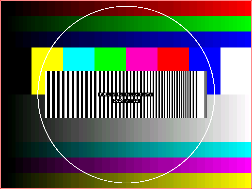

I may have found a listing / printing display bug with the new-ish video modes. I am running 5.05.06b17. This behavior does not occur in Mode 1, but is reproducible (on my machine...) with Modes 9 or 12 set as the default using OPTION DEFAULT MODE X.
>list commands
>list functions
or
>list functions
>list commands
In both cases, the second listing is slooow, like it's coming through a modem. All subsequent "list" commands, including a program listing, are equally slow.
Once the CMM2 is in this "slow" listing state, it also appears to affect a simple series of print commands, like in the attached file.
Starting from a normal state, listing the attached file four or five times in succession also puts it into "slow" state.
Issuing a "files" command or switching video modes reset to a normal state.

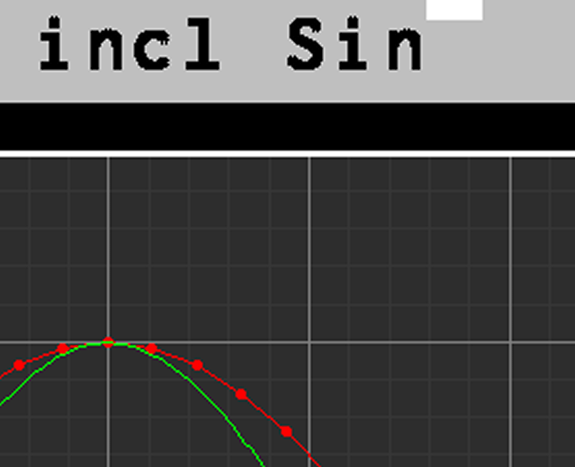

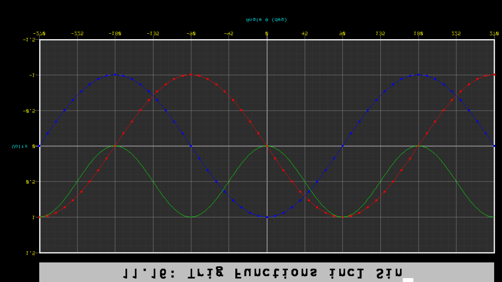

First, I've been playing with the newer video modes, and found an amusing bug since I received the CMM2 a couple of weeks ago with early August firmware: Image captures are flipped vertically.  Here are two BMPs, the first from well before the recent firmware (using mode 9:16), and the latter from after (using mode 11:16).  They display upright, of course, on my LCD display.  The lower one uses OPTION Y_AXIS UP (a potential clue!)
and
Second, if you take a close look at what should be the upper right part of the title (flipped and enlarged below), you'll see a white box.  I had hoped this would be a Superscript 2 (for Sine Squared).  The documentation shows this as Character &HFD (I included it in the TEXT command with a "STR$(&HFD)" concatenation).
Happy to share the code that generated the plot.

Posts: 6266
Posted: 11:18pm 06 Oct 2020
  Quote   The documentation shows this as Character &HFD (I included it in the TEXT command with a "STR$(&HFD)" concatenation).
PRINT "sin"+CHR$(&hFD)

vegipete
Joined: 29/01/2013
Posts: 1128
Posted: 11:20pm 06 Oct 2020
Try "Print Chr$(253)" instead.

Posted: 02:27am 07 Oct 2020
OK - I've narrowed it down a bit.  The superscript 2 (CHR$(253)) works fine in fonts 1 and 4, but doesn't in 2, 3, or 5, regardless of video mode.  Here's a clip of the SAVE IMAGE using Mode 12:
Strangely enough, this image was not flipped vetrically; I had done a power cycle before grabbing this one, and had not (yet) done an OPTION Y_AXIS UP command at the command line or inside a program.
The program that generated this example is:
