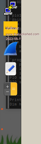

Posts: 3561
Posted: 08:03am 11 Aug 2022
Hi Jim,
Is there anything I can do to help diagnose following behaviour:
1/
In MMEDIT V5 (the latest version downloaded this morning) Linux version, running Ubuntu 20.04, just updated Ubuntu, I can scroll down the the text in the editor screen, but I cannot scroll up again (using the mouse scroll wheel).
You see that the editor tries to scroll up (1 or 2 lines) and then scrolls down 1 or 2 lines again, resulting in not scrolling at all.
Tried this with maximized window, and with windowed window.
Maybe related, the scroll bar at the right hand side of the window does not seem to be matching the length of the text in relations to the lenth of the visible window. A 300 lines program could have a scroll bar the is 2/3 the height of the text window (that should be 20% or so).
2/
Another observation is that the last line of text is partially invisible (outside the bottom window edge)
3/
The icons do not default show up in ubuntu 20.04 when opening the program (both MMEDIT and MMCC). Just empty fields (the red dot represents the fact that the program is opened). Maybe that is something I have to manually add (the link between icon and executable?).
Not sure if this makes any sense to you,
Thank you for creating MMEDIT, it is most valuable, and I use it a lot since it creates a good bridge between pico and the PC.

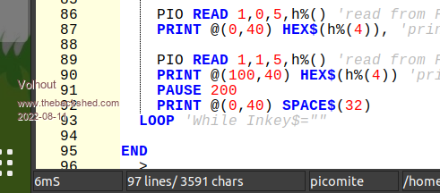

Posts: 3561
Posted: 07:22pm 11 Aug 2022
Hi Jim,
One more observation. Using picomiteVGA attached. Linux MMEdit.
Whith a program that has
DO
 some code
LOOP WHILE INKEY$=""
END
when I send this to the picomite to run it makes only 1 loop, then ends.
When I run it on the picomite (F2) then it loops until I hit a key.
Any idea? Are you sending extra characters that get captured by the inkey$ ?
Edited 2022-08-12 05:27 by Volhout
Posts: 5915
Posted: 10:00pm 11 Aug 2022
The last one is easy.
MMEdit defaults to sending CRLF.
In MMCC, change that to LF.
INKEY is catching the second eol character.
I might have to change the initial default to LF.
Back to your first post.
Scrolling with mouse. My mouse behaves correctly.
Is your mouse high resolution? There were a few discussions on the Purebasic forums about problems with HiRes mice. I will have to try and find that discussion to see if there are any clues.
Can you try a different mouse?
Does the vertical scroll bar move smoothly when dragging it? On my installation, the scroll bar doesn't always work until I resize the window. I will work on that problem.(only a problem on Linux I think)
Loosing the last lines.
Can you change the 'TabBar Height' entry in MMEdit.inf from 0 to 10. It is towards the end of the inf file.
That should help a bit but I will do some more tuning for Linux.
Missing Icons.
I haven't tried to set any icons in Linux. Too many different ways depending on too many variables. The only constant is my limited experience with Linux GUIs
My Linux Mint Mate and RPi both give me console style icons for MMEdit.
If you can come up with a bash script that does the job, that would be handy.
