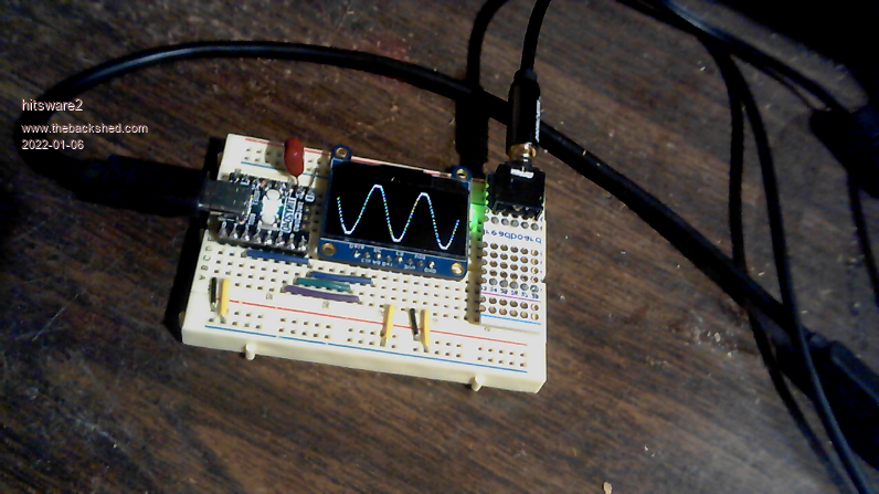

Here ' s mine .......
Dim y(127)
ADC open 50000,1 ' adjust horizontal
CLS
ADC start y()
For x%=0 To 127
Pixel x%,100*y(x%)-133 ' adjust vertical
Next x%
Pause 200
my site
