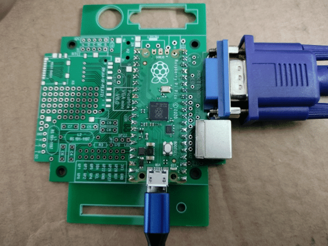

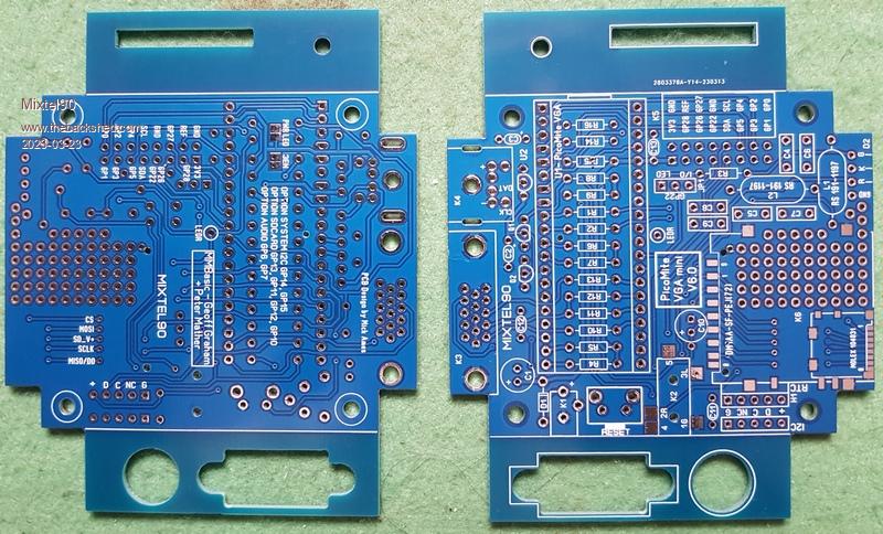

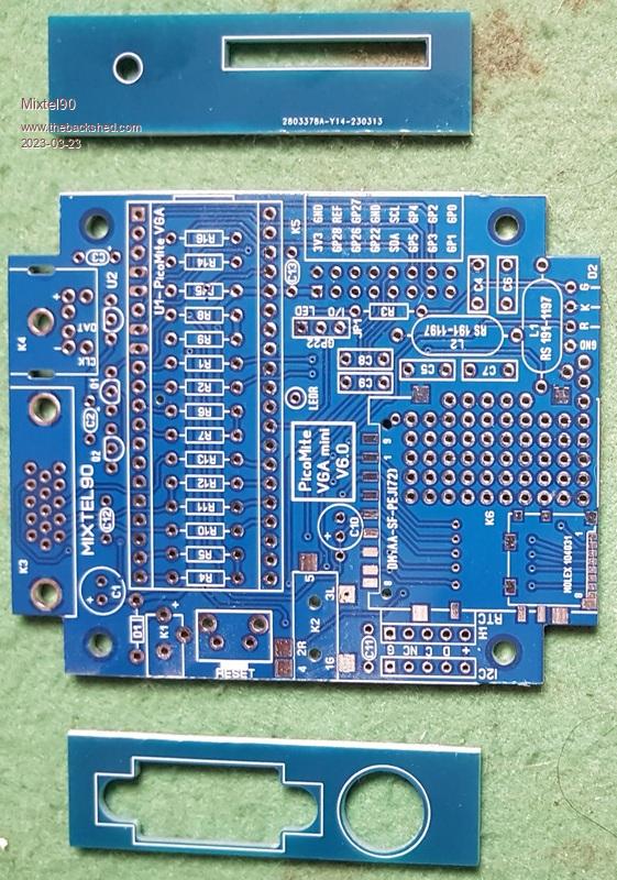

And so, the slow boat from China pulls into dock. I now have some PCBs. :)
All the holes seem to line up. I've tried a Pico in it and I *think* it's just about low enough now to be able to cut a slot for the USB plug. This is using turned pin connetors instead of the usual headers.
I've not got a standard SD socket to try it with. If the slot is a bit out it will just have to be filed down a bit. :) The board is just a tiny bit tight in the box. I'll probably take 0.5mm or so off just to ease things. The cut line isn't usually absolutely bang on when you use the score & nap in the vise system. It's pretty good though.
Incidentally, I too had JLPCB contact me about "the hole". I tried to explain that they should keep the hole but get rid of the adjacent pad if it was too close. Eventually she decided that it would be ok as long as the hole wasn't PTH. Anyway, it's come with both the hole and the pad, with the hole non-PTH and it seems to be ideal. They are very good indeed!

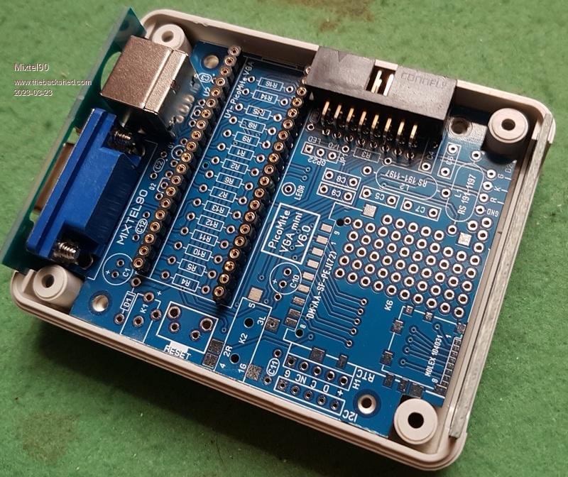

Posts: 7832
Posted: 02:39pm 23 Mar 2023
I've found a couple of errors so far. Neither too serious.
One end of C13 isn't accessible - it's underneath the box header. It can go underneath though, it's only a decoupler and could possibly be omitted. I'd forgotten it was a box header when I put C13 there as an afterthought.
The two-way link for GP22 has holes that are too small for a male pin header. I've made this mistake before and didn't learn from that! Some female header and a simple solid core wire link is fine. It's not as if it's something that will be changed much, I don't think.
The outer edge of the box header *does* project over the edge of the PCB but it won't stop the PCB from going into the case as a slot has to be cut for it anyway or it can't be used. :)
EDIT:
This particular uSD card socket isn't good in this particular position in this box. The inserted card doesn't project far enough for it to be pulled out unless you have long nails to catch into the little ridge on top. It *is* usable with that proviso. Mind you, I only included the uSD card so that I could practice soldering them as you can always use a uSD adaptor with the standard SD card socket. Unfortunately I've not got a standard socket so the prototype will have uSD. Well, one of them will anyway. :)
Edited 2023-03-24 02:07 by Mixtel90

I've got some of the stuff on the board now, but I'm searching for my bag of plastic boxes! I know I have a few left somewhere... I don't want to take construction much further as I'm at the point where I need to notch the bottom half of the case. It gets a bit more awkward when there is stuff that's preventing you marking the top surface of the board on the inside of the case so that slots can be cut to the correct depth.
EDIT:

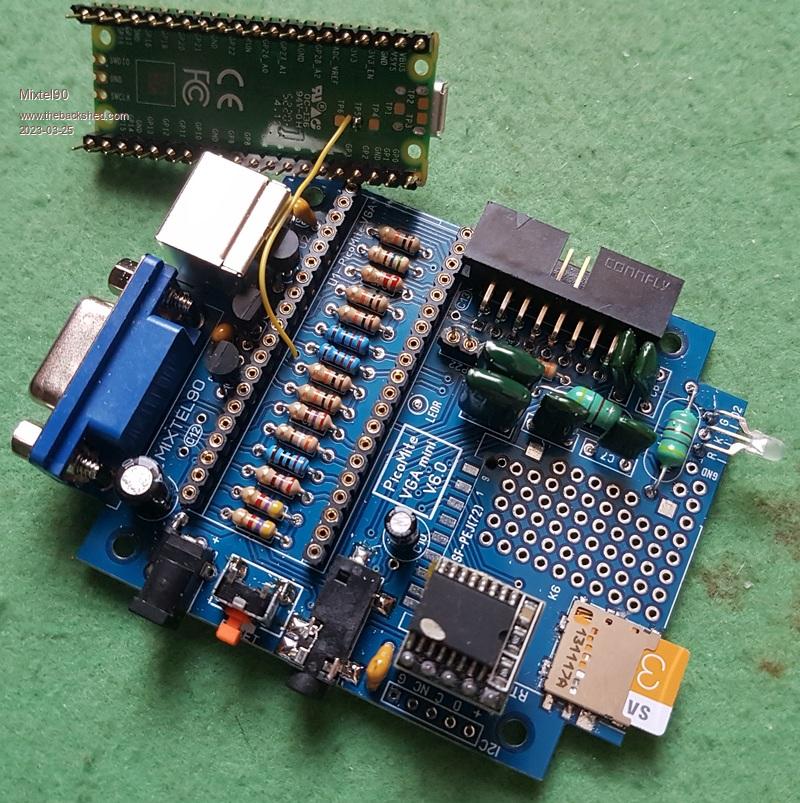

I've found my boxes! A lot more PCB construction has taken place. A few more slight gotchas:
C2 is too tight for a 1uF polybox cap. As I've nothing closer I'm using 100nF as it's relatively close to C1 anyway and I'm not after ideal noise performance from the regulator.
C3 won't fit either - it's too close to the PS2 socket. However, the regulator spec says a minimum of 1uF and the reg is feeding into VSYS - which isn't far away and has 47uF on-board. Once again I've put in 100nF to help with the high frequency mush.
ANOTHER EDIT:
I now have a more-or-less working prototype. SD card and RTC aren't working. The former I can understand as I've probably got bad SMD soldering. The latter I'm not sure about - needs more investigation.
All the case holes have worked out rather well, including one for the USB connector. Reset is a little "insert pointy object" hole.
Maybe more pics later.
YET ANOTHER EDIT:
Bad RTC was a dead module. Some reflow work fixed the uSD card socket. Sound is noisy (as expected) but it's working ok.
 I've done the mod that uses the front panel red LED as heartbeat  and it's ok. The on-board green still lights, but only just. The front panel green LED works properly when controlled by GP22. Audio will drive 32R headphones up to "too loud for me" levels.
I'm going to update the PCB to version 1.2, taking the above points into consideration. Most of this is done now. I'll update the construction pack soon, as I feel i should clear up some things in the manual too. I'm happy with it, and the current PCB can be used perfectly well if you already have some on order.

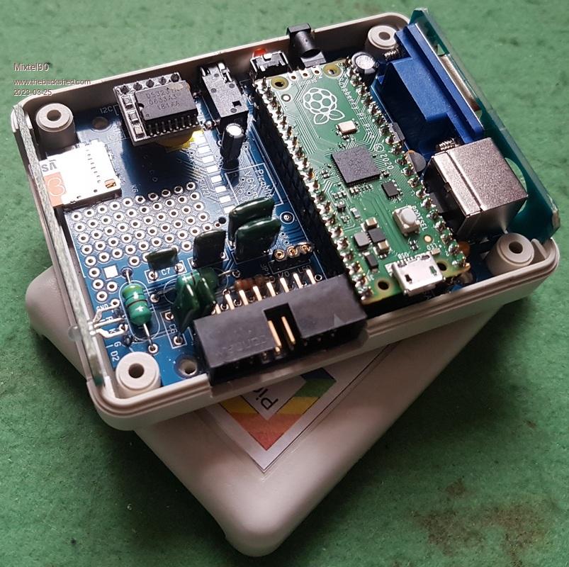

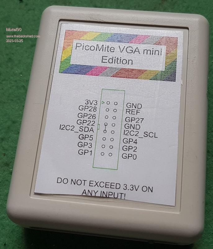

Posts: 7832
Posted: 10:47am 25 Mar 2023
Ta Da!
There are one or two "deliberate" mistakes, of course, but operationally it's good, even if the casework leaves a little to be desired! :)
I'm just going to start updating the manual.
PilotPirx
Joined: 03/11/2020
Posts: 99
Posted: 07:25am 27 Mar 2023
Hi Mixtel90,
the yellow wire goes from ? to ?
Posts: 7832
Posted: 07:29am 27 Mar 2023
From TP5 on the Pico to LEDR on the PCB. It puts the red LED on the PCB in parallel with the green LED on the Pico. The red LED has a lower Vf than the green one so the green one is starved of voltage and virtually goes out, while the red one lights instead. It brings the "heartbeat" to a red LED on the front. Obviously, you can switch "heartbeat" off and control it via GP25.

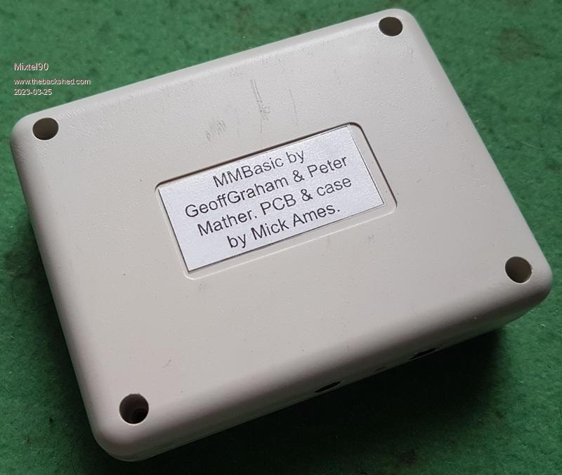

Posts: 5036
Posted: 07:32am 27 Mar 2023
Beautifull Mick !!!
The bottom sticker is the finishing touch !
This would be a nice kit. Guess you are not going to provide kits ?
Edited 2023-03-27 17:33 by Volhout
Posts: 7832
Posted: 08:48am 27 Mar 2023
I don't know. The idea has its appeal. Postal costs are always the issue. I'd also considered selling the PCBs ready-built, for those with no soldering skills, but I haven't got the time nor the inclination to do the casework. It's quite fiddly.
The bits are mostly easy enough to get, but a "part kit" consisting of the PCB, SD, VGA & audio sockets might be one solution.
I'm going to include the stickers as a PDF with the manual. :)

An alternative set of Gerbers has been added to the Construction Pack.
(from Readme.txt file)
  Quote  There is now an alternative PCB design (Gerbers 60 12A). This is not a replacement design. The circuit has not changed.
This differs from the current design in the following ways:
There is no option for a standard SD card, only micro SD.
The "sea of holes" area has been expanded.
The PCB is slightly longer, allowing the micro SD card to project just a little more.
The width of the SD card slot has been reduced and there is now text on the end plates.
The IO connector now projects over the side of the PCB by 2mm, so it is flush with the outside of the case.
The PS2 keyboard socket now projects slightly over the end of the PCB to make connection easier.
Links have been added beneath the PCB to break the connections to the audio socket, allowing experiments with filters.
If you don't fancy soldering a micro SD card socket then this may not be for you (unless you don't want SD storage at all).
