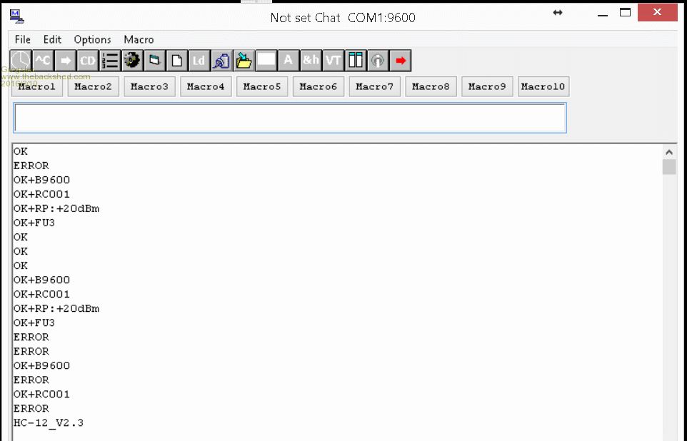

Okey dokey, I will try this and get back to you.
I seem to recall that someone here wrote a nice little utility to program the device with the settings you want - Rob? Jim? Someone.....
However, this may be a requirement for direct control or something, yes?
I will post back soon.
Posts: 9589
Posted: 12:35am 10 Mar 2016
The module responds to "AT+A001" or "AT+A012" kind of command with an "OK", but attempts to query that command with the likes of "AT+RA" result in an error message.
My guess is that it is possibly ignoring commands from the earlier HC-11 module, for compatibility reasons. The module DOES NOT respond with "ERROR" when you issue "AT+A012", it just responds with "OK" but nothing else. Not sure if this helps at all, or makes matters worse!
EDIT: It does seem to be ignoring unknown commands, and sending "ERROR" for syntax errors in commands it does know. If you send something like "AT+ZZ" or "AT+OO", the module still responds with "OK".

using the HC-11 configuration utility with an HC-12 module attached, the response from sending "AT+A003" is "OK". this is not the expected response, but neither is it an error.
the HC-11 and HC-12 use completely different transceiver chips from different manufacturers. i would not expect the address command to be supported by the HC-12, and the "OK" response may just be there to provide some level of drop-in compatibility. note that an HC-11 can not communicate with an HC-12, even if the operating frequency of both are the same.

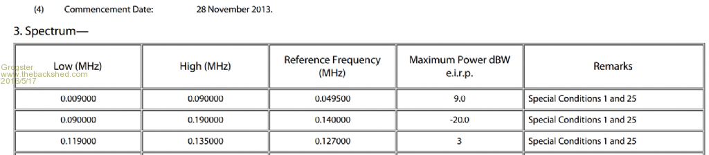

Warning about legal use of 100mW (20dbm) HC-12 transceivers in Australia, or any other transmitting devices in the 433Mhz band.
https://www.legislation.gov.au/Details/F2015L01438
Appears that maximum allowed legal transmitting power in 433Mhz band is 25mW (14dbm).
Looks like similar limitation in Europe, but in USA 433Mhz is illegal.
915 Mhz (1000mw) maybe another lower frequency digital communication option provided that frequency spread hopping or digital modulation is used . 915Mhz is also legal in USA.
I am not an expert in this field, maybe some others with HAM licence can comment more.

below is a (slightly modified) reposting of my comments on the HC-12 output power from another thread. on the whole, there is little for kiwis, aussies, or brits to worry about, although it would be a good idea to check out the bandplan for your country if you are concerned.
the 433MHz band is referred to as LPD433 (low power device 433 MHz) and requires no licence for use in many countries:
https://en.wikipedia.org/wiki/LPD433
for the average person, the most familiar use of this band is for garage door controllers, for example green button Merlin remotes. it is also shared with amateur radio operators (70cm, 430-440MHz).
the first four channels of the HC-12 module fall within this band. the default power output of the HC-12 is 100mW, while in australia and new zealand the maximum power allowed is 25mW. however, the antenna supplied is a helical (20-turn, 4.5mm diamater, 20mm length) that is likely to attenuate the output to be within the 25mW limit:
http://www.cqham.ru/spiral.htm
the bandwidth of the transmission is also quite wide (400kHz), which spreads this power out quite bit, again helping to keep within the regulations.
also of note: the HC-12 only transmits when there is data sent to it. so if transmitting (for example) a temperature reading every minute, transmission will only consist of a short 'blip' now and then. this mode, in itself, is unlikely to interfere with other users such as remote controls or voice.
conclusion: using the supplied 20mm helical antenna the HC-12 should be ok to operate in australia or new zealand on channels 1 to 4 (channel 1 is the factory default); in the UK, the band is flagged as shared with amateur radio operators, but if acting with consideration to others this should not be an issue. so, in these countries no configuration needs to be sent to the unit.
setting a channel number above 4 is best avoided without first checking the local regulations, as is attaching a 'real' antenna. and finally, avoid sending data continuously to be courteous to other users of the band.
american users may with to chime in with details of their own local regulations.
rob :-)
