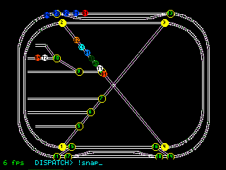

Here's a youtube video of 4 trains running. The frame rate is only 1-2 frames per second, but if this were translated to an 8-foot by 6-foot layout, the speeds would be pretty much in range: PicoRR Demo  (doesn't hurt to run it an 1.5 speed).
Here's the script which drove the video:
s10+ve3 4,delay 3,ve3 0s10-ve3 -3
delay 3,ce3s9+s8+s4+ve3 25
at e3 inner-e,s8-s9-s4-
at e3 inner-w,s16+s14+s13+
s6+s3+ve1 35,at e3 Mainline-E,s16-
s14-s15+s11+,ve1 45
at e1 Mainline-W,s6-s3-s15-s11-s13-
s7+s3+,ve2 20
at e1 Mainline-N, delay 2
s12+
at e3 Mainline-W,s17+s7-s8+
delay 4,ve4 7,delay 15,s8-
ve3 35,s17+
at e1 Mainline-S, delay 3,s17-s18+
at e2 Inner-W, s4+s2+s1+s3+s7-ve4 20
s12-s13+ve3 25, ve1 25
at e1 Mainline-N,delay 3, s13-s12+
s17+ve3 35,ve1 35
at e3 Mainline-W,S18-
at e1 Mainline-S,ve1 2,ve3 2
delay 5,s17-s18+ve1 25, ve3 25
s13+s12-
Loop 16

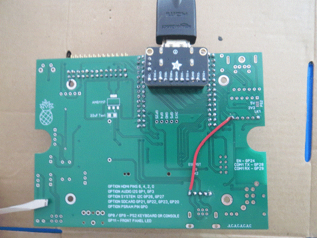

This is running on Peter's Pico2 HDMI PCB:
You drive the trains by typing commands (on PC/laptop keyboard--I don't have a keyboard attached to the PCB) at the "DISPATCH>" prompt on the Screen/LCD. For instance, s6+ve1 20 will flip switch 6 out of spur2 and start up the train behind Engine E1.

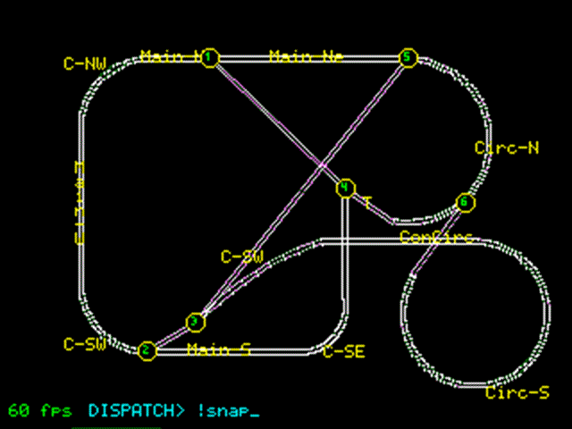

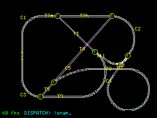

There are 3 layouts available at present:
Fuller documentation is in the zip file, which contains everything needed to run on a Pico2 HDMI, 640x480 Mode 3. I think it will work with VGA, but haven't located the boards I know I have somewhere. I have it displaying, but not yet running, on LCD 320x240 and 480x320.
The library (which contains the PicoDB database engine) needs to be saved with LIBRARY SAVE.
There are two driving files: roster.csv (which defines engines and cars), and segments.csv (defines track segments and switches):
