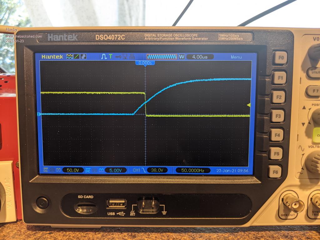

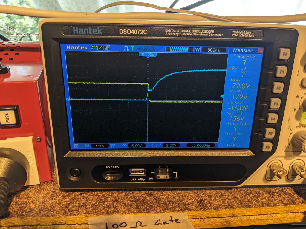

Blue trace is measured at the gate. (Vge)
Yellow trace is measured at the collector (Vce).
This is with a 100 ohm resistor.
The big dip at the gate is gone. The gate still wants to switch on very very quickly!
Posted: 01:25am
23 Jan 2021
The gate voltage initially rises very fast, before the IGBT begins to conduct.
As soon as conduction begins (in the linear region) the collector voltage drops like a rock.  That capacitively couples into the gate, and tries to force the gate negative, fighting the gate driver and series gate resistor.
Once the IGBT has turned on, the collector voltage is no longer falling, and the gate is free to rise further. That all looks fine, nothing wrong there.
About three divisions later the upper IGBT should turn on.

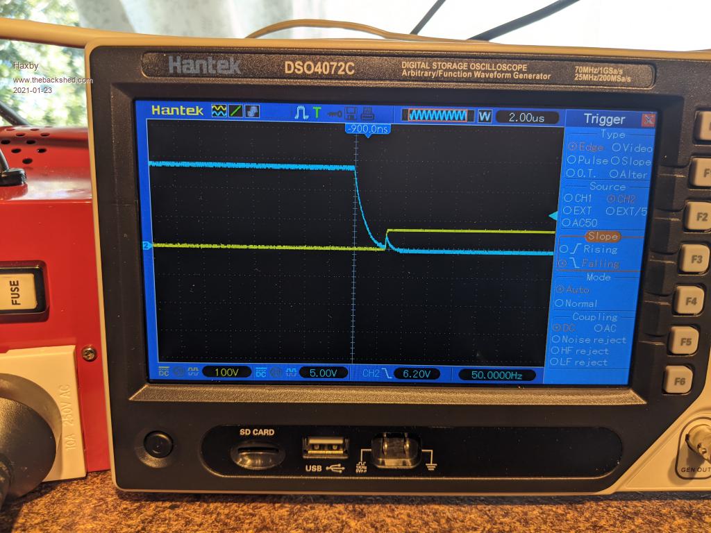

All this focus on the turn on time detracted me from looking at the turn off time. Turns out there were terrible things happening there too!
With the 100 ohm gate resistor, the turn off time at the gate looked like it was approaching too close to the 2.5 uS threshold.
You can see the blue gate trace taking its sweet time to turn off, then it gets pounded by the high side igbt quickly turning on at the 2.5uS mark.
I added a diode and 10 ohm resistor to the gate drive to turn off quicker, but still under control. That sorted out the turn off shenanigans.
Another problem now discovered was that there was a giant dip in the gate drive that was appearing seemingly out of nowhere, but always in the same position well into the square wave..... That turned out to be transients from the high side igbt switching. While mucking with the low side gate, I realised that I should be copying everything I'm doing to the high side igbt.

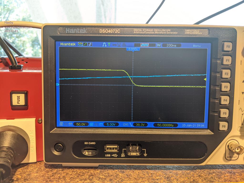

Finally in an attempt to slow down the 40nS very fast switching, I added a 100nF capacitor between gate and emitter. This slowed the switching time to 200nS. Still very fast, but I'm reluctant to add more capacitance because the gate voltage trace now looks quite spongy.
The following are the latest traces of the Vgs and VCS, two pics just with different time bases, and I think I'm ready to increase the voltage and see if there are any more fireworks!
What do you think? What are the unintended consequences of such a spongy gate voltage?
I chose these IXGN75 and IXGN90 IGBTs primarily because the tabs were insulated.  I saw that they were fast turn on, and didn't think this would be a problem, if anything, it would be an advantage due to lower switching losses. In hindsight, I would have chosen some older slower IGBTs, as that's basically what I'm converting them into with the added gate caps.
Posted: 02:42am
23 Jan 2021
See how it goes.  Very slow switching means higher switching losses, but as its only 50Hz that should not matter.
It will probably look quite different with an inductive load and higher dc voltage.

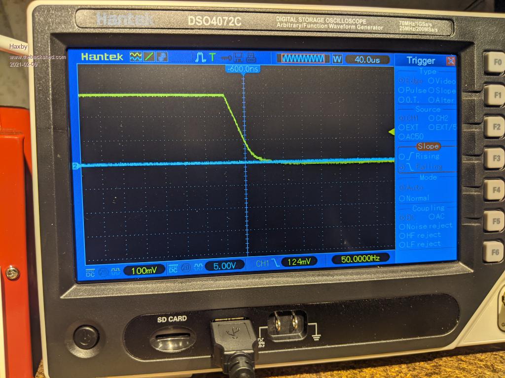

Gents, just a quick update:
After learning about, and witnessing, the surprisingly large coupling effects of high voltages on the gate traces, I decided to add TVS diodes to all gates, so I had to pause the build till they arrived.
They arrived today, so I'll be working on the project this week.

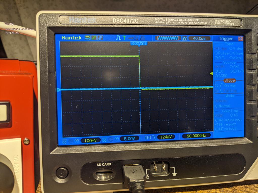

While I was waiting for the TVS diodes to arrive, I was checking all gate drivers again and for the second time I found a gate driver IC that was exhibiting strange behaviour.
This is the second one I found with the same fault. The ON time is fine but the OFF time is not good.
I post this as a word of warning to make sure anyone building any inverter looks at the on/off times of every gate after a fireworks event.
Here is a trace of a bad one:
And here is what it should look like:
Posted: 05:31am
09 Feb 2021
Its not pulling down as hard as it should.  Maybe the lower mosfet in the driver chip is damaged.
That may be due to the inverse diode experiment, too much gate current being pulled down might have blown the lower mosfet.
Its amazing though, faults like this can remain hidden, and the inverter may still actually appear to work.

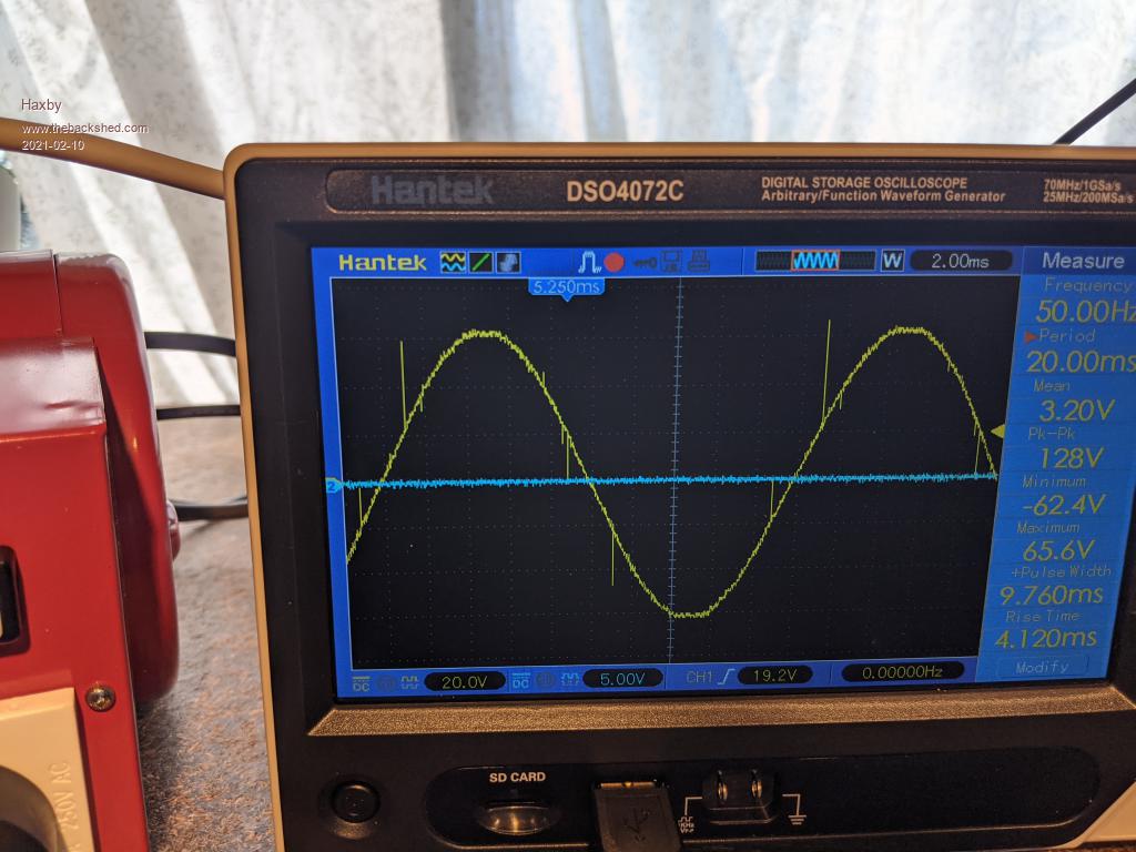

I have connected all 4 inverters, and have run at 200v for some time without blowing any IGBTs. Aaaand, I've got 230v RMS out!
I haven't yet connected a load to the output.
There is still an occasional resonant hum that comes and goes from the transformers. Not sure why. It could be that I'm getting the DC input from a half wave rectifier from mains which is also at 50hz, and when it aligns with the generated 50hz it may cause a bit of step saturation. Will need to eliminate that soon with a full bridge rectifier.
The problem now is that I can see some spikes in the output that correlate to the largest inverter turning on and off:
They are not random. The transient pattern is always up then down on the top half wave, and down then up on the bottom half wave.
Note that while the divisions say 20v, they are actually X5, so 100v per division.
The transients are not on the input square wave side of the transformer, but on the load side. Should I be concerned?
Posted: 06:32am
10 Feb 2021
No reason to be concerned.
There is going to be some capacitive coupling between primary and secondary, and the whole thing is going to be high very impedance on the secondary without any load.
Those spikes are going to be extremely narrow, not a lot of energy there to get rid of.
An EMI filter and grounding one side of the secondary should make a big difference, and so will some slight load.
That is a nice sine wave by the way.
