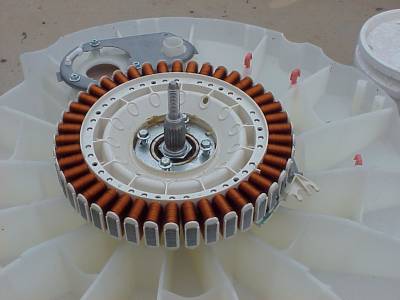

                          I've posted his pictures and instructions here for reference. First up flip the washing
                          machine over and remove the water pump, tubes, wires etc so
                          you end up with something looking like this....
 Looking at the complete
                          assembly from underneath. The transport locking ring (pale
                          thing on the end of the shaft) can be turned anticlockwise
                          while holding the motor rotor steady.
 As you turn it, the rotor
                          comes off the shaft, exposing more of the coils. Eventually
                          it is fully undone and can be lifted off. The 4 bolts can
                          be undone, use a 10mm socket.
 With the bolts undone and

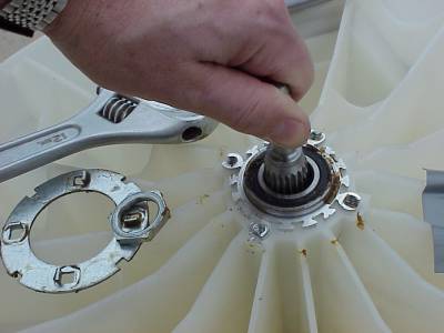

                          the coil assembly removed, the shaft and bearing housing are
                          visible. Hold the shaft with multigrips or vicegrips (use
                          some brass or copper shim or similar to avoid damaging the
                          shaft) and undo the large nut with a large shifter. Don't
                          smack your knuckles into the spanner like I did when it finally
                          lets go.
 Then ease
                          the shaft down, through and out.
                          I should mention here that you need to have already removed
                          the washing agitator ( mixer ) and inside bowl. To remove
                          the agitator, take off the filter thing in the middle, poke
                          you hand down inside the agitator and undo the plastic wing
                          nut. Once the agitator and bowl are removed, undo the seal
                          around the stainless drive shaft, usually held on with 4 screws
                          under all the slime and muck. You must undo this seal before
                          you try to remove the shaft.
   You
                          can punch out the bearings with a drift. Remember to keep
                          all the bits.  Thanks
