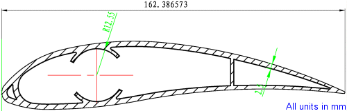

Whether you looking for a easy to build turbine, or a airfoil to experiment with, then these cheap PVC extrusions could be what you're looking for. They are available from forum member Anthony ( Jarbar ) and can be ordered below.
These blades were designed as a easy to use general all rounder windmill blade. They are based on the GOE222 airfoil, which has a proven record in wind turbines and has been used by the Windcharger wind turbines for many decades. The profile works well over a wide range of attack angles, meaning the blade has a wide power band compared to other high speed profiles. This also means the blades can be used with no twist[1]. The blades are silent in operation.
For information on mounting the blades, see the Mounting Extruded Blades article.
The blades come fitted with the end caps, so you need to specify the direction of your turbine rotation, either clockwise or counter clockwise, looking at the turbine face on. If you wish Anthony can leave the end caps off and just include them with the delivery, however he still needs to know which way the turbine spins so he can supply the correct end caps. In reality, with these blades, the direction of rotation is not important. However from a cosmetic point of view, if you have more than one windmill, it looks much better if all turbines rotate in the same direction. Windmills rotating in opposite directions looks weird.
Additional end caps are available on request. The end caps are there to keep water out and stop the extrusion ends whistling as the turbine rotates. Early prototype end caps had a small wing let included in the mould, the current end caps do not. However they are a better fit to the PVC extrusion and you can easily attach a wing let made from plastic to the end cap if you want to experiment.

Nominal Blade weight 1.2Kg/mt @ $32.ooAU/mt
End caps fitted to suit C/W rotation unless otherwise specified.
End caps add approx 8mm extra to cut length of blades.
Internal diameter of blade to suit 25/25.4 mm OD tube.
