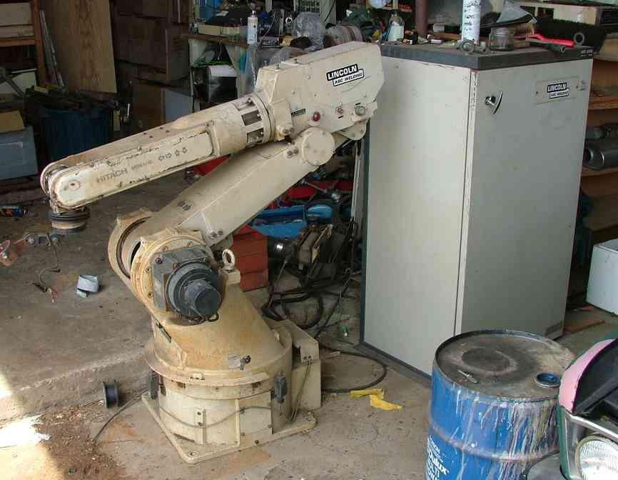

                            | I picked up
                              this old Hitachi welding robot for a few cartons of beer.
                              The owner was happy to get rid of it, this model was a
                              bit of a beast to operate and very out dated. |  |

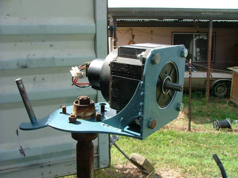

                            | I lasercut and
                              welded together a simple platform to hold one of the motors.
                              The platform includes tail furling and bolts to a car
                              wheel hub at the top of my mast. The motor is rated at
                              1100 watts, so I can expect 500 so watts as a windmill. |  |

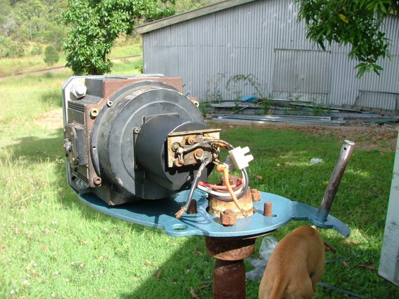

                            | A 3 phase rectifier
                              was mounted on the decoded cover on the back of the motor.
                              These motors include a electric brake and opto decoder,
                              both of which have been removed. |  |

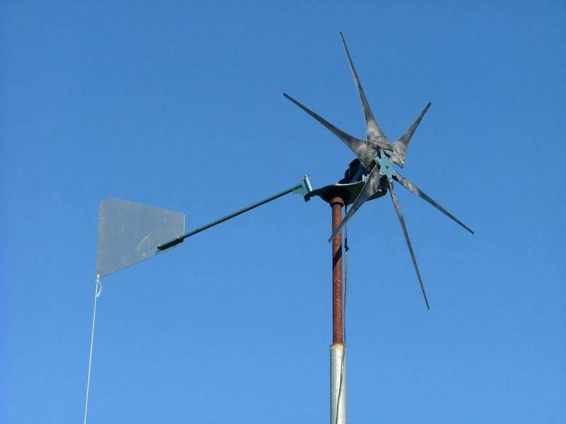

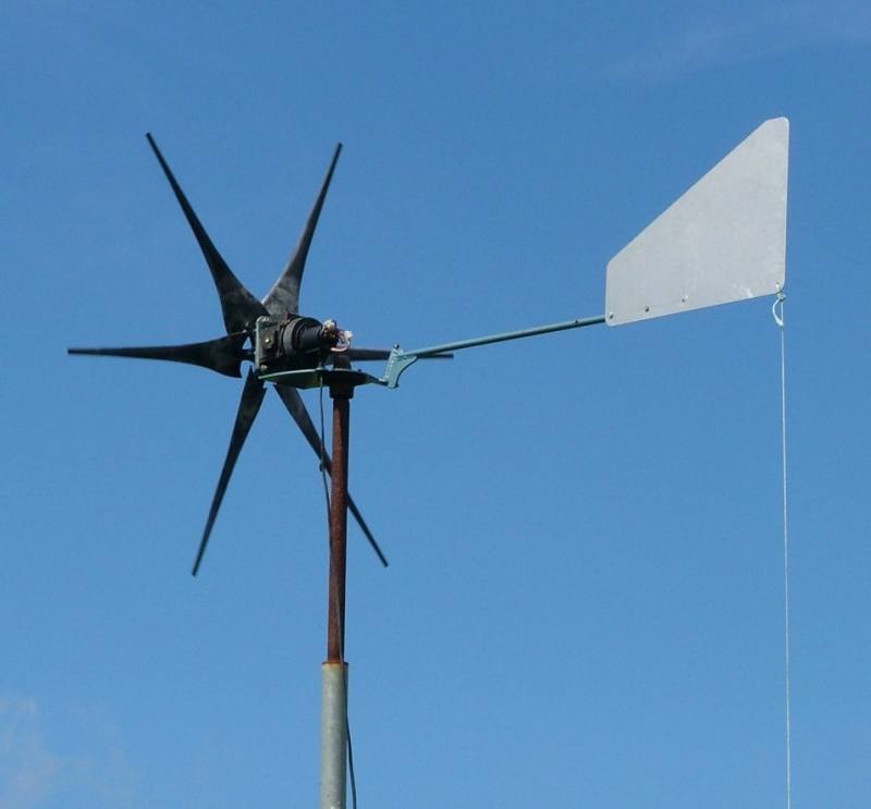

                            | Up in the air.
                              There has been stuff all wind since I put the windmill
                              up ( typically ) so havn't got any power figures yet.
                              But the windmill starts up easily as there is no cogging
                              in this type of motor. During the day I monitored the
                              output voltage. Its was just below charging voltage, sitting
                              in the 8 to 12 volt range. |  |

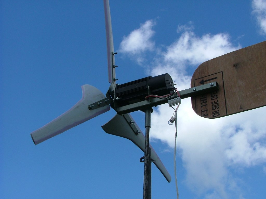

                            | I decided to make a modification in
                              improve output voltage. The motor is wired as a 3 phase
                              star, each leg consisting of 6 1mm wires in parrallel.
                              I seperated the windings and changed to 2 lots of 3
                              wires in series/parrallel. This will double the output
                              voltage and half the output current. By doing this the windmill will start
                                  charging much earlier in light winds. If this windmill
                                  works out, I might play around with a switching circuit
                                  to switch back to the original winding configuration
                                  as the wind picks up. |  |
