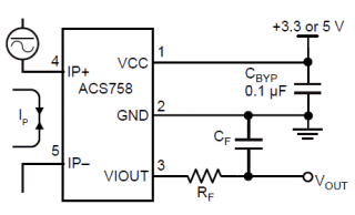

The Alegro chips are very sensitive and react quickly to the slightest change in current. In fact, they are too sensitive for most applications, so we need to add some filtering to the output, CF and RF in the circuit above. For my own projects I've used a 10k resistor and 22uF electrolytic for the capacitor, but tantalum capacitors are better suited, and values closer to 100uF will be needed in some cases.

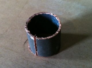

I used a short length of 1inch copper pipe, but any copper sheet will do, providing its thick enough, about 1mm in this case. |

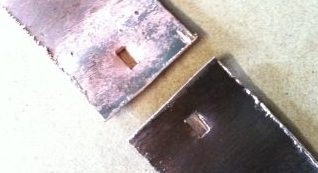

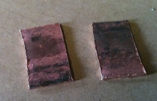

Flattened out and cut into two.

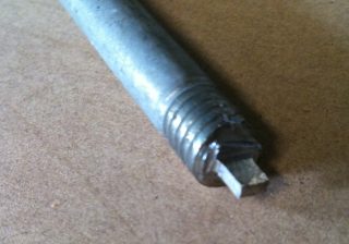

Next I made a punch from an old bolt. The punch is shaped to suit the Alegro legs. Using a hammer and piece of hardwood ( into the end grain ) made the job easy. Thanks to Pete for that tip.

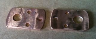

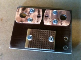

Next I drilled and shaped the copper plates like this, and sanded the copper so it was clean. To the right you can see the plates and a piece of veroboard riveted to some fibreboard. The fibreboard is perfect for this sort of job, but any tough heat resistant material would do

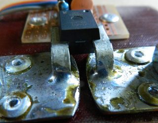

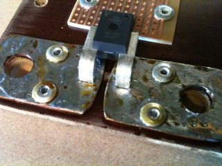

Then I tinned the copper plates, fitted the Alegro and soldered in place. For this sort of soldering, you need a big soldering iron, 100 watts or more, with a big tip.
The copper plate will tend to pull the heat away from a smaller iron tip, so the bigger the tip the better. It means you can make a nice solder joint in a few seconds, reducing the heat stress on the Alegro chip. I wouldn't attempt this with a smaller soldering iron. |

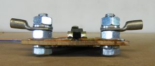

Here is a side view so you can see how the bolts are mounted. The spring washers under the fibreboard are a must. |

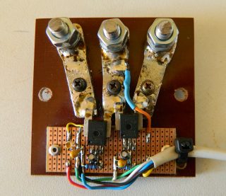

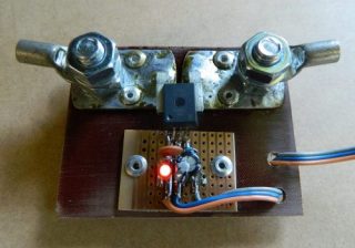

After it cooled down, I mounted the other components. The LED is there for show, not needed. |
Here is another one I built using two unidirectional Alegro chips. This time I used copper bar, 10mm wide and 5mm thick approximately. I used a mill to machine the slots for the Alegro pins.
This one will be used to separately monitor amps into and out of a 50 volt battery bank. The blue heat shrink and orange wire is a battery voltage sense wire. |
