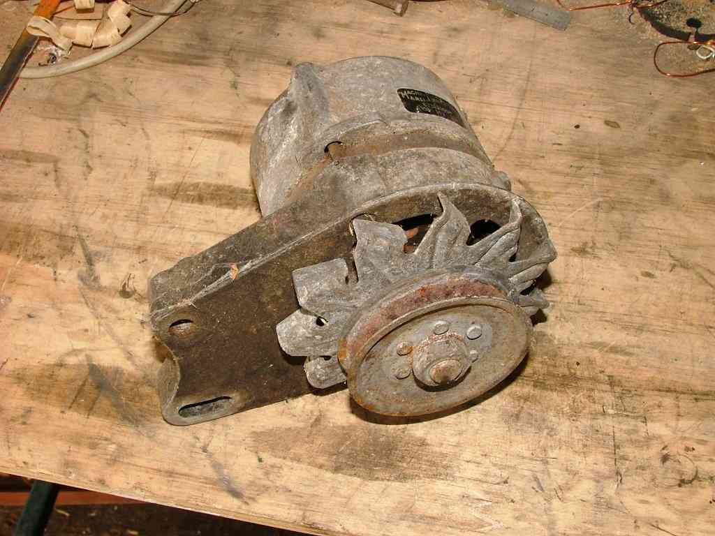

Le alternator, all the way from
Italy.
Undo the long screws that hold
the thing together, dont worry about removing
the pully. The pully end and armature will slide
out, maybe with the help of a big hammer. |

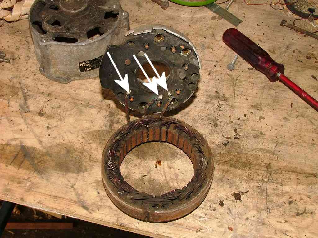

| If you look into the
depths you will see 3 thick wire from the stator
connected to the rectifier. |
| Remove the rectifier
from the case ( it may slide out from the back ).
You will have to undo some screws and the output
power terminal. Just keep unbolting stuff untill
you can get it out. Cut or unsolder the 3 stator
wires. These 3 terminals will be connected to the
3 phase output of our windmill. |

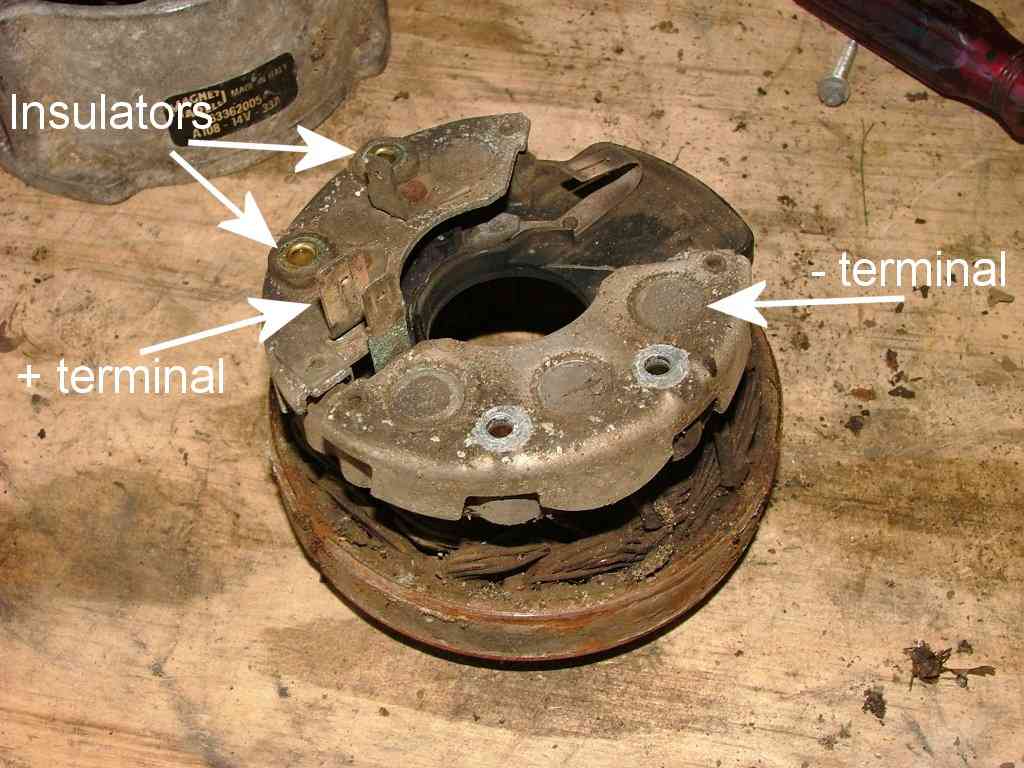

| If you look at this
rectifier ( and just about all follow this same
rule ) you will see two plates, each with 3 diodes
connected. One of the plates is positive and the
other is negative. The negative is the plate that
was eathed to the alternator case, and the possitive
is the plate that was insulated from the casing
and connected to the output terminal. But if the
alternator is from some weird european car that
has a possitive earth, then everything I said above
is reversed, I think. |
