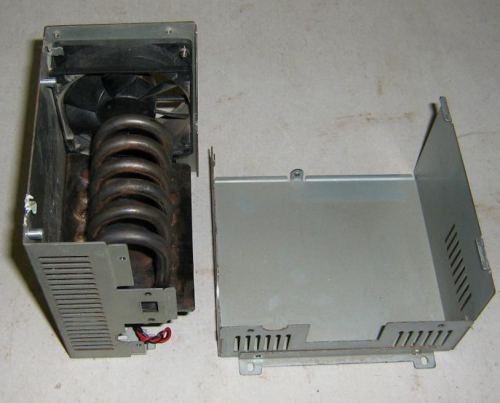

This looked a little boring and I decided to take it further to show what can be done and how easy it is to do. The next intension was to mount the resistors in a old atx psu casing. The fan was to remain, so space is tight.
![](MakingEncapsulatedResistors/Image10.jpg)
