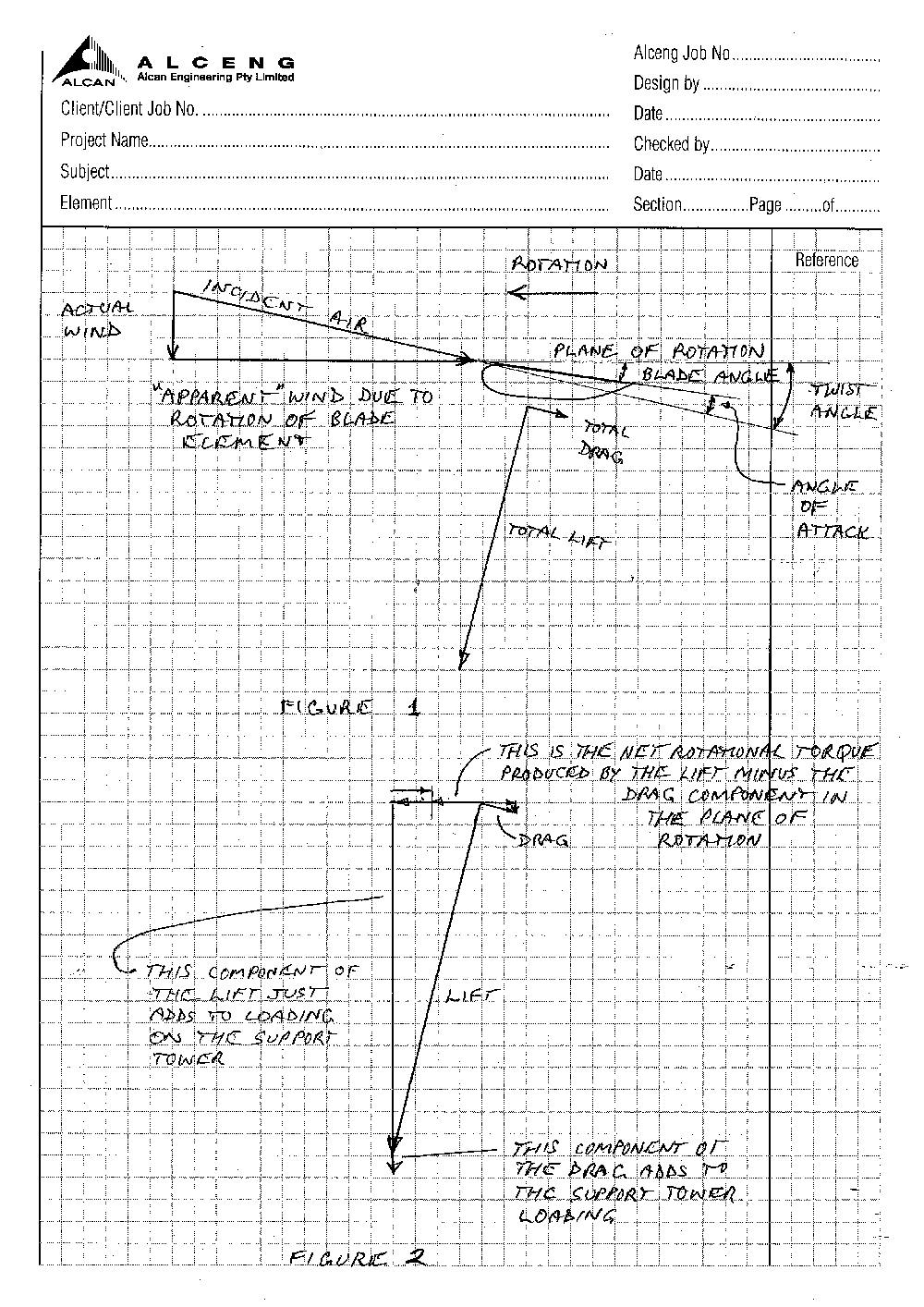

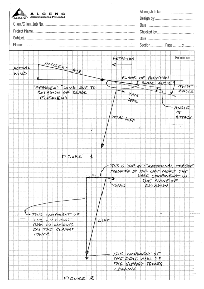

Blade Twist or Helix- There is
a lot of science in efficient blade design, and I don't
pretend great expertise. The principle of blade twist
is, however, relatively simple. Air arriving at the
leading edge of a turbine blade hits the blade with
the speed of the wind in an axial direction, while the
blade simultaneously hits the air at its circumferential
speed. The circumferential speed depends on the radius
of the point in question from the turbine axis, and
is obviously fastest at the tip.

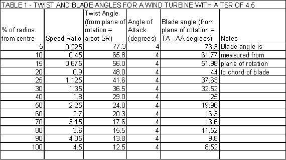

Considering the tip for the moment, if it is operating
at its design TSR, then the air hitting the tip will
do so at an angle to its rotational plane which is the
angle who's cotangent is the TSR (see Figure 1). If
the TSR is 4.5, then this angle is 12.5 degrees to the
plane of rotation. At half the diameter, where the speed
ratio is half, the angle is the cotangent of half the
TSR (or, in this case, 23.9 degrees). The attached table
gives the twist angles for various percentages of the
radius of a three bladed turbine with a TSR of 4.5,
but can be readily recalculated for other TSRs.
Note that the twist angle is not directly proportional
to the radius, but follows the cotangent function. The
rate of twist increases closer to the turbine axis.

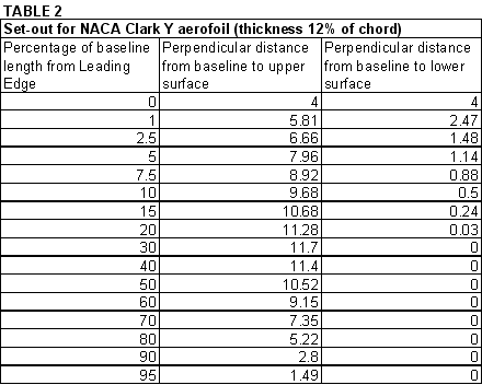

Aerofoils - At high wind speeds
there is so much wind power available that even bits
of packing case timber set at an angle to the wind can
generate power. The art is in efficiently extracting
power at low wind speeds. Efficient turbines use aerofoil
sections, like those used for the wings and propellors
of aeroplanes.
All aerofoils can be distinguished by having a lifting
side, where the air moves more quickly than on the other.
The lifting side is ordinarily convex, while the other
side may be identical, less convex, flat, or even concave.
A turbine blade is no different to an aerofoil wing
or propellor in its use of one (or several) aerofoil
shapes. One essential difference though is that a turbine
blade needs its lifting side away from the wind, while
a propellor blade has it towards the direction of travel.
One of the things which distinguishes one aerofoil shape
from another is its lift to drag (L/D) ratio. Lift is
the force exerted at right angles to the incident air,
while the drag force is in the same direction as the
incident air. Really excellent aerofoils can produce
a lift force of around 100 to 150 times the drag force,
although values of around 20 are more readily achievable.
Attainment of high orders of L/D ratio are
very much dependent on accurate reproduction of the aerofoil
design, and a very high standard of finish. There are dozens
(hundreds, probably) of aerofoil sections that have been developed
by bodies such as NACA (now NASA), and their development is
a science in itself.
A table enabling the venerable NACA Clark Y aerofoil to be
set out is attached (Table 1). Being essentially flat on the
lower face, the Clark Y is a relatively simple shape to reproduce,
and has been used for many aeroplane propellors.
It is, however, by no means the ultimate wind turbine aerofoil.
Its low L/D of about 20 needs a TSR at the lower end of the
band (which is why 4.5 has been used as the example value)
and lowers the turbine efficiency. The aerofoils of most interest
to wind turbine blade experimenters chasing higher L/D ratios
and hence efficiency tend to come from the lower speed end
of the range, as developed for model aeroplanes. This is to
do with having a similar Reynolds Number, to the turbine operating
conditions (for those interested in following up the matter).
Erosion, or an accumulation of lumps from insects (particularly
over the first third of the lifting surface), spoils the air-flow,
and substantially lowers the L/D ratio. Glenn's comments on
the need for initial and ongoing attention to this matter
should be noted.
Angle of Attack. The angle between
the incident air and the aerofoil chord (line between the
leading and trailing edges) is called the Angle of Attack.
As a rule of thumb, the highest lift is developed at an angle
of attack of about 10 to 12 degrees to the incident air. The
point of stall, where the air flow detatches from the lifting
side and the lift collapses, occurs at an angle of about 16
degrees. The AA that provides the highest Lift to Drag ratio
is the angle of most interest to aeroplane designers, and
occurs somewhere between 0 to 4 degrees, depending upon the
aerofoil selected.
Wind turbine designers are primarily interested only in the
component of the lift that provides torque in the plane of
rotation of the turbine, and may select a higher AA to get
more lift. The component of lift acting in the same direction
as the actual wind only serves to load up the support tower
(see Figure 2), so turbine and aeroplane designers have different
views on lift. |
Turbine Blade Angle - For best efficiency,
a turbine blade needs to be set at the twist angle minus the
desired angle of attack (i.e. the blade angle - see Figure
1). Suggested blade angles for a percentage of blade radii
for a typical three-blade turbine with a TSR of 4.5 are given
in the Table 2. This is based on an arbitrarily selected AA
of 4 degrees, but this can be the subject of some experimentation
(in association with different aerofoils). The AA does not
need to be constant for all of the blade length (nor does
the aerofoil section), and this is a fertile area for the
experimenter to research.

The lift generated by any element of a turbine blade is proportional
to the chord, and the square of the incident air velocity.
If the width, or chord, remained constant, then the blade
tip would develop four times the lift of the centre of the
blade, and might bend.

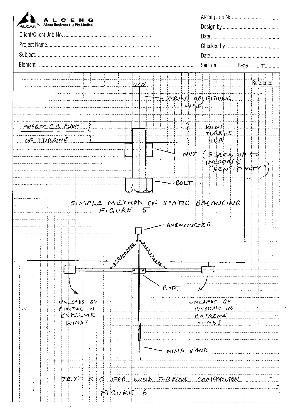

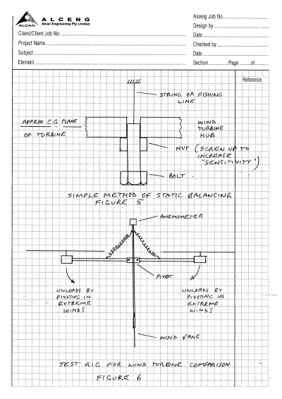

Balance - Because of the substantial
centrifugal forces that can develop, the turbine must be well
balanced. The simplest way to do this is to take a nut and
bolt of the same diameter as the turbine shaft, and to drill
a small hole through the exact centre of the bolt. A piece
of string or fishing line is then fed through the hole, and
the turbine is suspended with the blade horizontal.
The nut is then used as the "sensitivity" setting
(Figure 5)
The closer the top of the bolt comes to the centre of gravity
of the turbine, the more sensitive the balance adjustment
becomes. Pieces of paper can be used as test weights to verify
that accurate balance has been achieved. Pick somewhere free
of drafts to check the balance

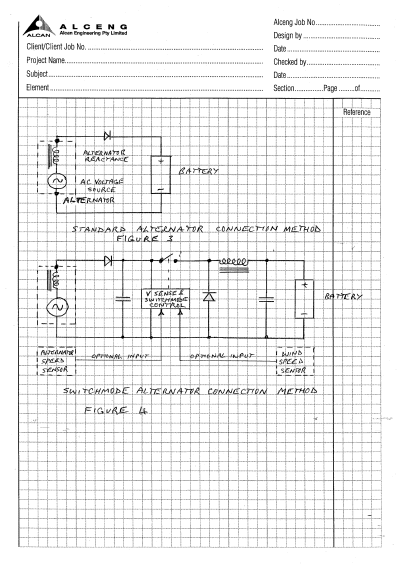

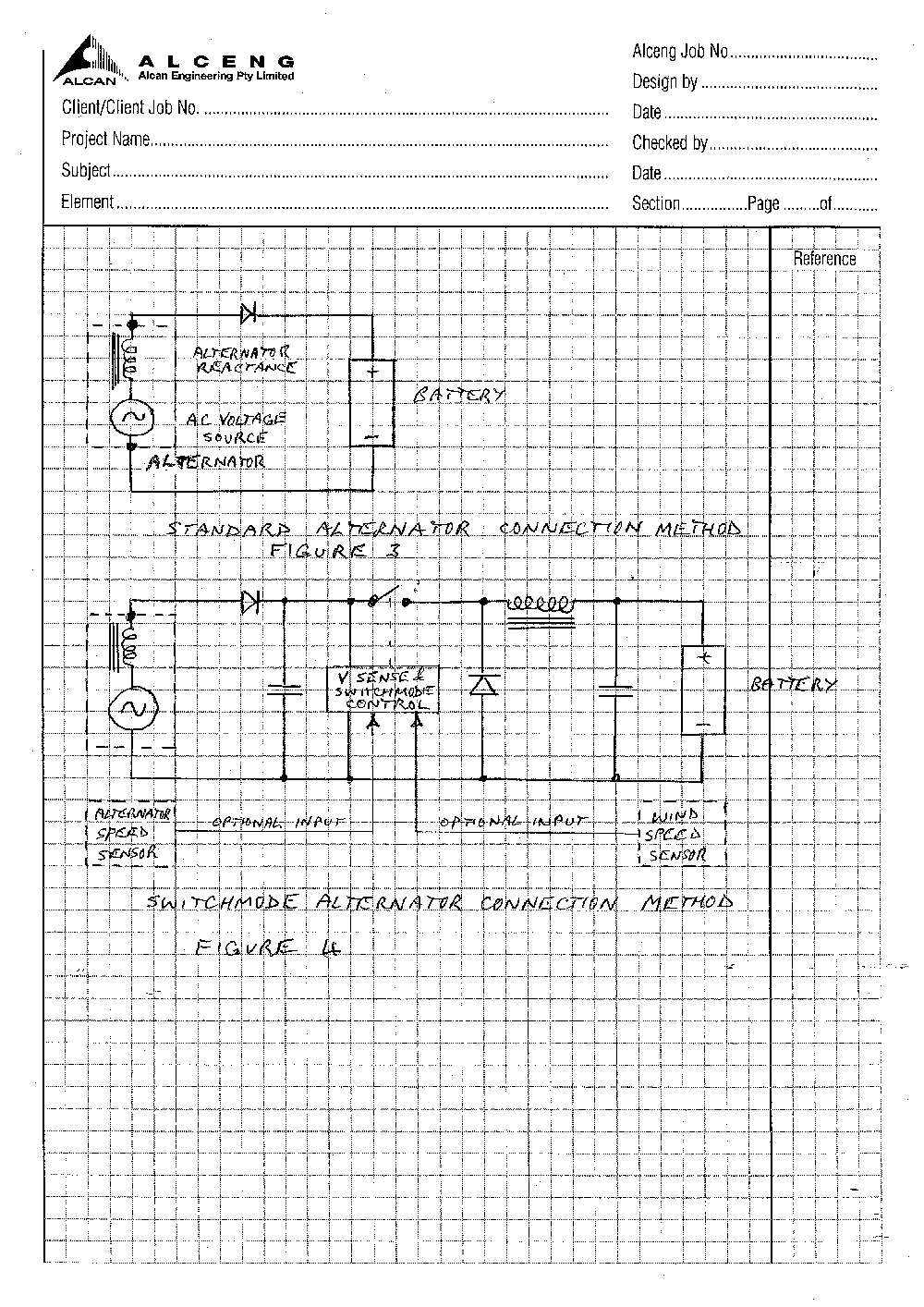

Conventional charging circuitry - A
typical wind turbine alternator connects to a (bridge) rectifier,
which then connects to the battery under charge (Figure 3).
Note that current can only flow from the alternator to the
turbine once its terminal voltage exceeds that of the battery
voltage, plus the diode bridge forward voltage drop. The current
waveform is therefore unlikely to be a clean sinusoid, and
some harmonics will be generated.
To minimise losses in the diodes, these should be of the Shottky
type with the lowest available forward voltage drop (so long
as they operate within their reverse voltage rating).
Conventional charging circuit shortcomings - As noted above, for the turbine to operate at maximum
efficiency, it must run at or near its design TSR. This requires
that its turbine speed must linearly follow the wind speed.
For alternators with fixed excitation, the no-load voltage
will be proportional to shaft speed.
The problem is that, with conventional circuitry, the alternator
is more or less locked to the battery voltage, and the turbine
will generally be operating below optimum speed as a consequence.
Switchmode charging circuit - In Figure
4, the alternator is connected via a switchmode charging circuit,
which can let the alternator operate at voltages significantly
above the battery voltage. The switchmode circuit works by
connecting the alternator DC output voltage to the battery
for a brief period. The current that flows is limited by the
inductor, which also stores energy in the form of a magnetic
field. When the switch opens, the polarity of the voltage
of the inductance reverses, and current flow is maintained
through the battery and the Shottky diode while the magnetic
field dissipates.
The current burst flowing into the battery is thus longer
than the current burst from the alternator side, while the
voltage is lower. As very little energy is lost in this process,
over a burst cycle, power in effectively equals power out,
and the system works as a DC transformer.
This permits the alternator to operate at a higher voltage
consistent with a higher turbine speed.

By mounting two alternators on a common T shaped pivoting
bracket it is also possible to pivot and spring load them
such that they will automatically unload themselves in strong
winds (refer Figure 6).
