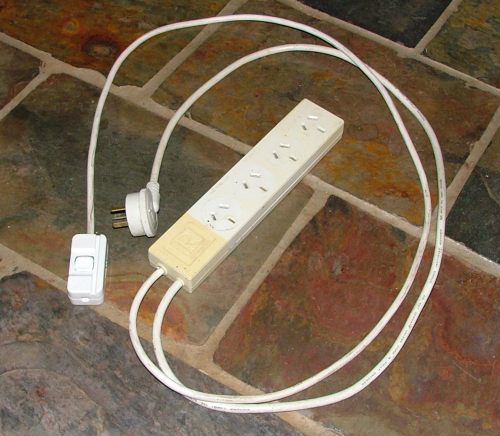

Now the eco-switch™ is is a great idea. I was inspired to make my own ( for my own use of course, the eco-switch™ is protected with patents, besides you have to be a qualified electrician to wire up this sort of thing ).
What I've made are remote switch power boards. I modified a power board with a length of 240vac 4 core wire and a DPST mains switch to switch both A and N for safety.
![](EcoSwitch/Dscf1772.jpg)
One is set up on my TV/Entertainment unit. The switch kills everything, so I dont have to worry about standby power, lightning surges or fires. But what about the VCR's clock? Well most modern gear has a built in battery backup ( just like a PC ) to keep track of the time and date, so its really not a problem anymore. The only thing to remember, if you set the VCR to record TV show while your away, you need to leave the standby power on. |
My other switched power board is on my PC. Right there next to the coffee cup. Once I've finished for the night, I shut down the computer and then flick the switch. Everything is turned off, the monitors, PC, hub, modem, printer, the lot. |
