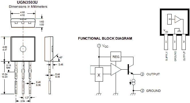

The heart of the meter is a UGN3503U or similar hall sensor. The UGN3503U is a linear hall sensor, meaning its output level changes with magnet Gauss changes, and the device can be sourced from most electronics suppliers, like Jaycar, Altronics, Farnell, etc..

This regulated 5 volts is fed to the hall sensor's pins 1 and 2, and its output, pin 3, is our detected magnet gauss level. With no magnet present, the hall sensor will supply 2.5v on its output. If we place a magnets N pole on the back of the hall sensor ( the back being the side without any text stamped on it ), the voltage will rise above 2.5v. If we turn the magnet around so the S pole is on the back of the hall sensor, the output voltage will drop below 2.5v.
How much the voltage rises or falls is dependant on the gauss measured. The UGN3503 specifications say 1.3mV per Gauss, so as an example if we get a reading of 3 volts, then we have 500mV above our null point ( 2.5v )
500mV / 1.3 = 385G
