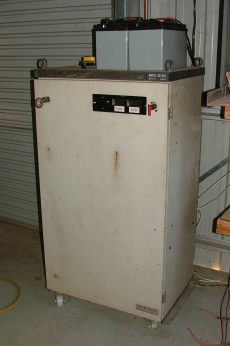

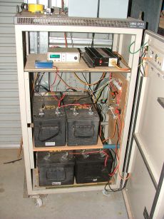

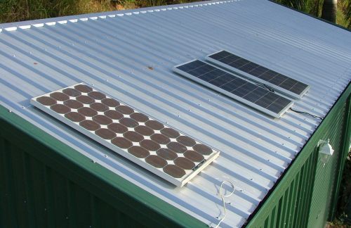

There are 3 solar panels, two near new 80 watt and one very sad 70 watt panel that's making about 20 watts. So all up I have about 180 watts of solar feeding into my PicAxe windmill charge controller set up as a solar regulator for now, its does the trick. For batteries I'm using 2 near new 100AH deep cycle batteries, and 4 2nd hand truck batteries ( 2 at 1400CCA and 2 at 1500CCA, not sure on the AH rating of these but it should be good, they weight a ton! ). All batteries are connected in parallel, along with a Megapulse. The 80 watt panels, 100AH batteries and Megapulse came from Trev ( Foundry and Fibreglass ). The batteries ( except for two on top ), controller and inverted are housed in an old robot control cabinet.

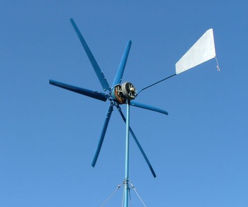

My current windmill is a dual stator with the staggered connections, and a 6 blade turbine made from PVC pipe. Its been a good windmill this, no intention of changing a thing.
