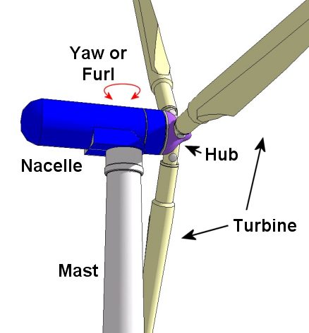

                            | Furl | The deliberate   movement of the prop from full exposure to the wind to the minimal side   on/in-line exposure to make the prop slow or stop. _ More |
                            | Yaw | Rotational movement about a vertical   axis(mast). This movement allows the prop to point at the wind when it changes   direction. |
                            | Yaw Bearing | The mast bearings that allows yaw movement. |
