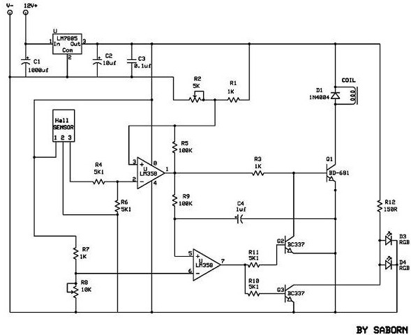

Originally I tried to use a Picaxe to read the hall sensor and do the switching of the coil via a transistor, but the picaxe was too slow. I then went to using a LM-358 Opamp with good results.
The Opamp circuit is very basic and simple.
What I noticed was when the magnet is levitating the circuit only draws about 50-150mA, depending on the object weight, but when the magnet is removed or is knocked out of levitation, the coil is switched hard full on.
This causes the 5 volt regulator to run very hot or overheat.
The circuit has now been redesigned to use the second half of the dual opamp to switch the coil off in the absence of the magnet.
The whole circuit including the coil operates off 5 volts, and a LM-7805 voltage regulator is used to supply this, so the maximum current needs to be kept below about 0.5 amps.
The linear hall sensor (UGN3503U) has a nominal output of around ½ the supply voltage. When a magnet is brought near the sensor the output voltage increases or decreases depending of which pole of the magnet is used (north or south pole), for this circuit it is set to increase in voltage as the magnet south pole approaches the sensor.
The sensor output is connected to the inverting input of the opamp (opamp-1), and the non inverting input of opamp-1 is connected to a pot set as a voltage divider, the pot is used to trim in the balance point of levitation for different size magnets or object weights attached to the magnet.
Opamp-1 output is connected to base pin of a BD-681 transistor via a 1K resistor, the BD-681 is used to do the coil switching, almost any NPN transistor or mosfet could be used that has a 1 amp or greater rating.
The second half of the opamp (opamp-2) is used to monitor the output frequency to the transistor, this is done by a 100K resistor off opamp-1 output into a 1uf cap, effectively creating a analogue voltage which supplies the non inverting input of opamp-2.
Opamp-2 inverting input is supplied with a voltage from a trimpot set as a voltage divider.
When the coil is being pulsed to keep a magnet in levitation the analogue voltage on the non inverting input is lower then the setting on the inverting input, but when the magnet is removed the voltage increases as the coil is switched full on with no pulsing.
This pulls the non inverting input higher than the set voltage on the inverting input and switches the output high.
The output of opamp-2 is connected to the base pin of a BC-337 NpN transistor via a 1K resistor.
The BC-337 has the collector connected to the base pin of the BD-681 and effectively shorts out the 1K resistor on the base of BD-681 to ground switching off the coil.
A second BC-337 transistor is also connected to the opamp-2 output that controls the leds by shorting out the limiting resistor to the leds to switch them off.
To set the coil switch off point it is as simple as a 1 time adjustment to the trimpot till the led just turns off.
When a magnet is brought in range of the sensor the led will turn back on and the coil will start to be pulsed, then its just a matter of adjusting the pot till a balance point is found for the magnet.
