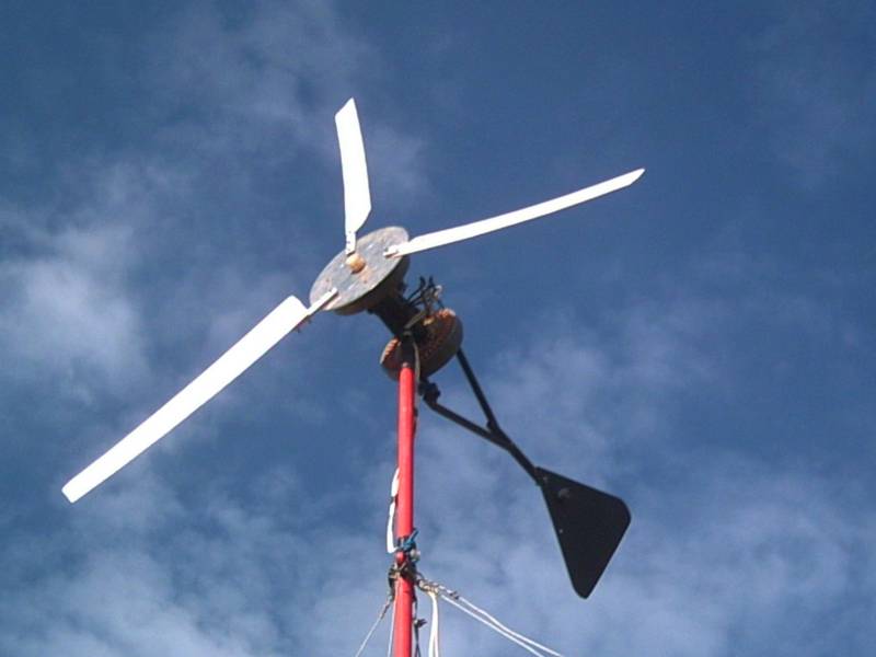

                          =560watts with two motors on the same shaft.When i was using a single motor i had it wired in
                          series/parallel with delta output and 1.8M diametre
 3 blade rotor, I got 25 amps at 10m/s but was not good
                          in light winds around 5-6m/s and was getting noisy in
 high winds due to higher rpm's.
                          Since going to the two motor setup i have tried the
                          two motors in delta to get a potential 60amps but you
                          need a larger rotor to get 600+ watts, and a large
                          rotor wont spin fast enough to get the 60 amps.
 I now use star output giving me a total of 40+amps,
                          with a larger 2.2M rotor which works well in light
                          winds giving me 1-2amps at 3m/s, 5A at 4m/s, 10A at
                          5m/s, 15A at 6m/s, 20A at 8m/s, 28A at 9m/s,
                          30-35A at 10m/s with a peak of 40+ Amps.

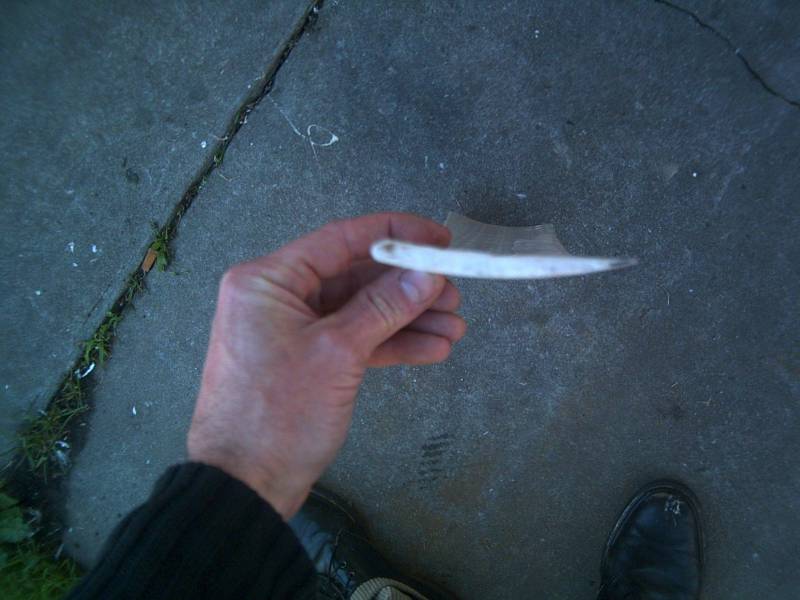

  Note: Changing the pitch on my blades by just
                          2-3 degrees makes a lot of difference to the output,
                          and even more so with my smaller 140 watt 1.2M rotor
                          small turbines.

 Finally as you will see in the pics, I mount each
                          motor at each end of the shaft.
                          With your method and mine you could make a 4 motor
                          turbine.

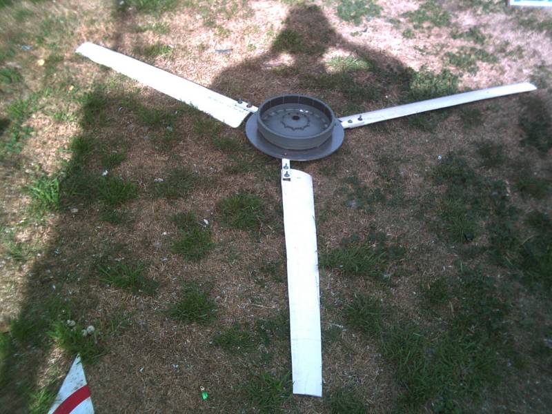

 I was also concerned about the flex
                          in the magnet
                          rotor when bolting blades to it, but i use a 6mmaluminium plate cut round with a jigsaw to mount the
                          blade extensions and blades.

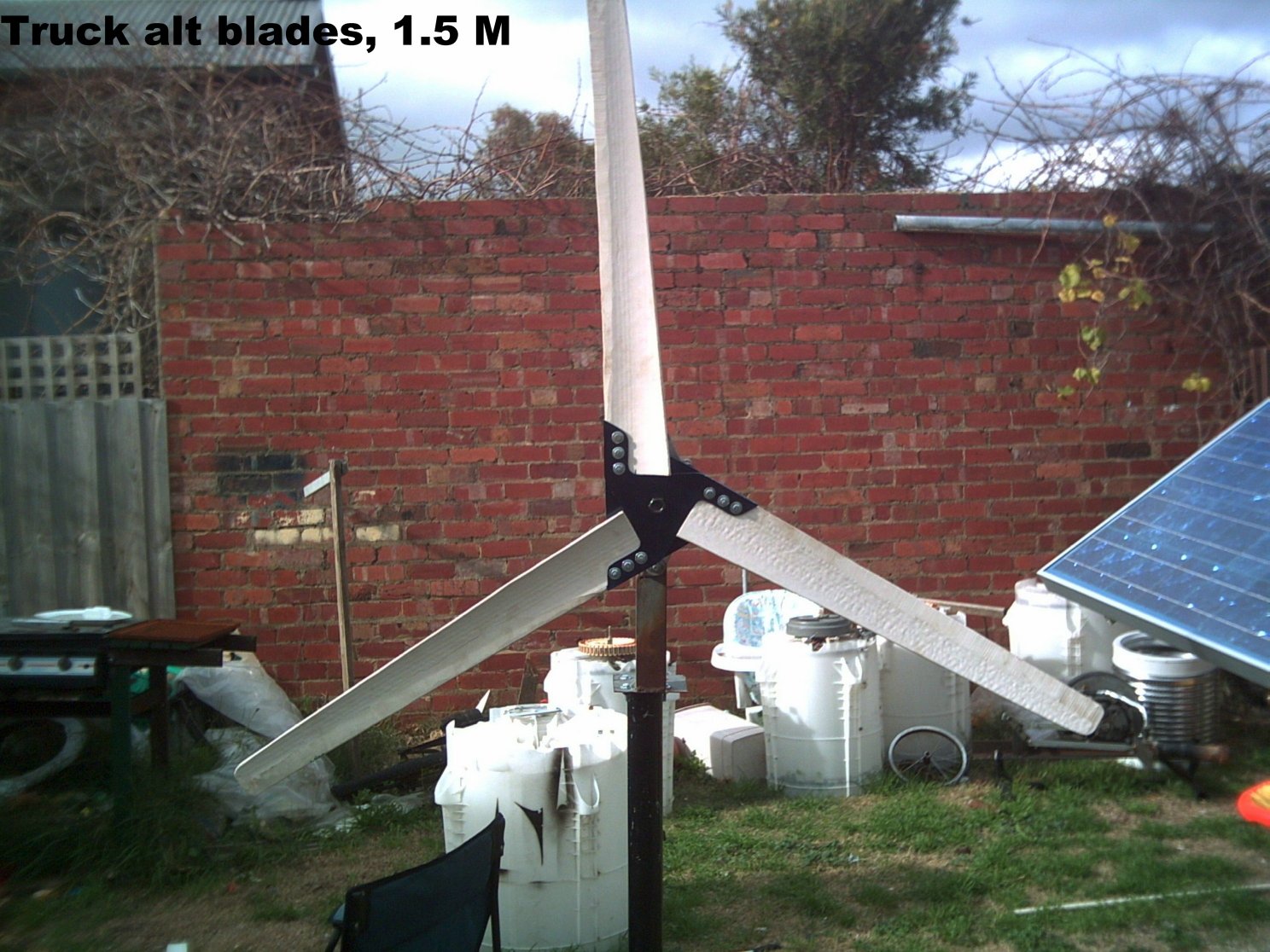

  The blades don't flex much due the smaller size
                          850mm/7mm blades with blade extensions, I find using5mm PVC they tend to flex and go out of shape,
                          reducing power output in higher winds.

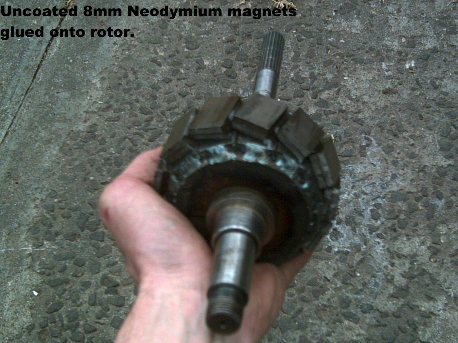

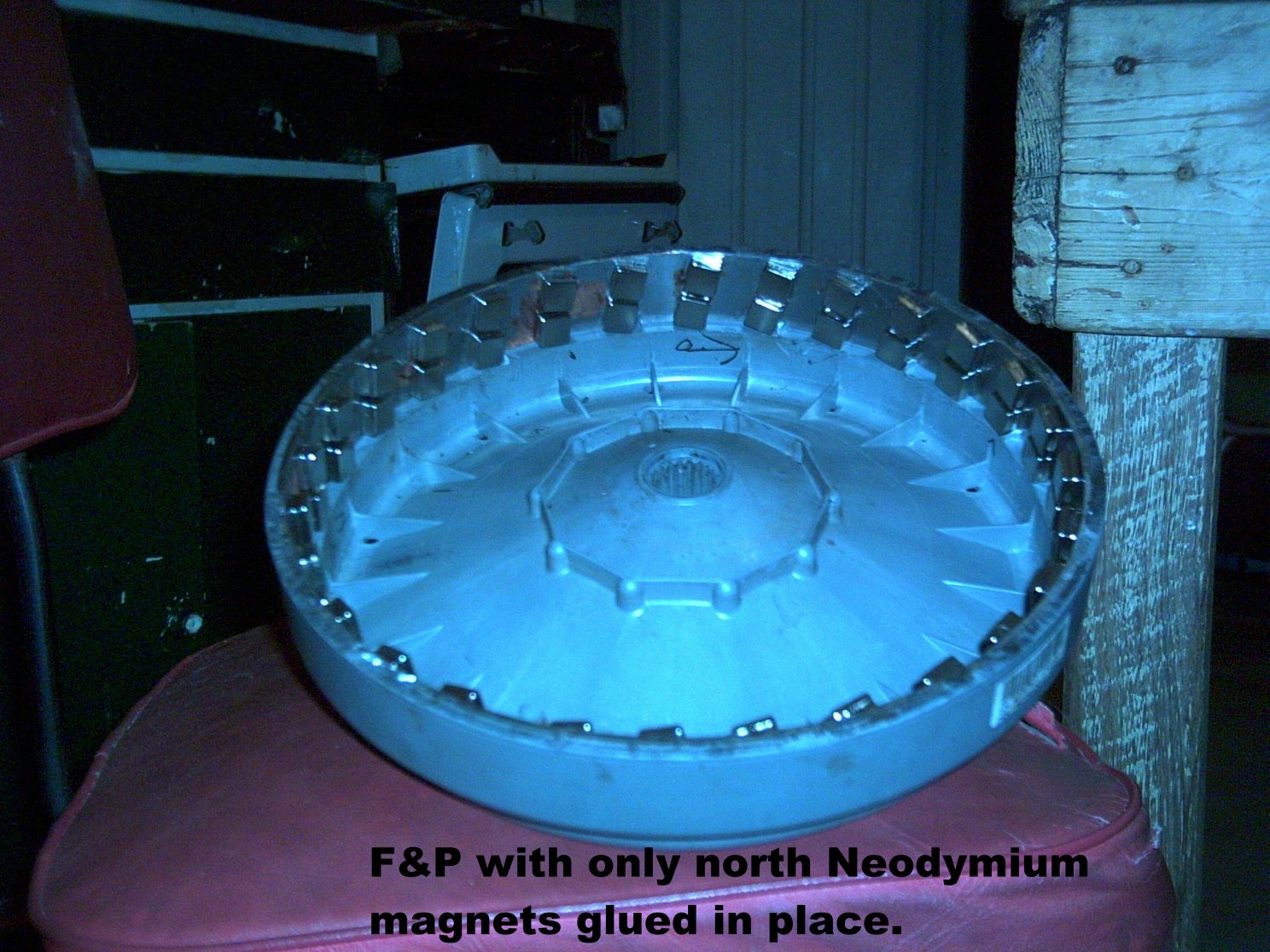

                          and details on the web. My latest venture is to take off the
                          weak ferrite
                          magnets and replace them with 6.6mm rare earthmagnets,
                          equals about 6-8 times the magnetic strength.

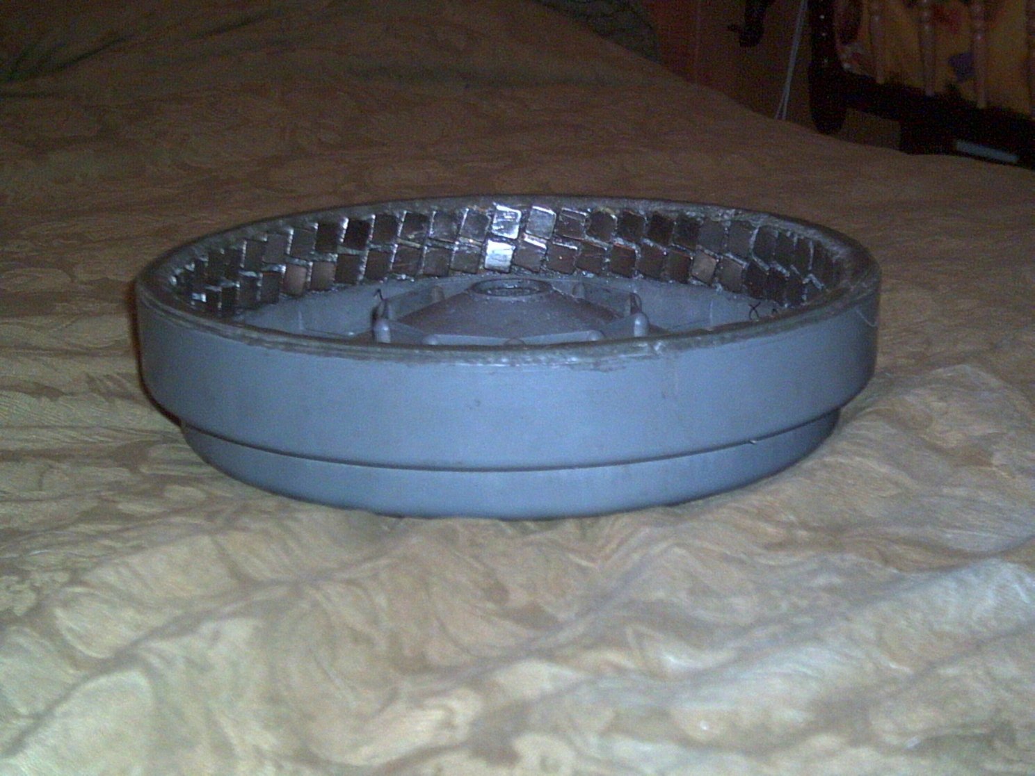

 When making the small modified PMA car
                          alternators, I
                          found that the coils were half the size of the F&P
                          andonly 12 coils per phase wound in series with .8mm wire
                          and i can get over 10 amps at 600rpm, I think this is
 due to the 20mm/12mm/6.5mm rare earth magnets, which
                          are far more powerfull than the F&P ferrite or white
 magnet rotor with small rare earth magnets.

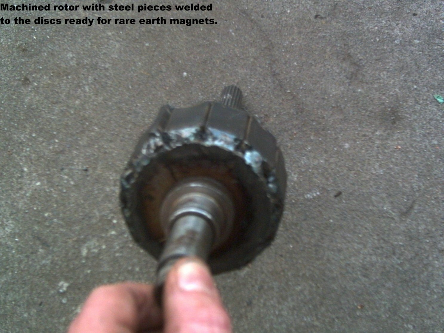

                          I have done the conversion lifting of the old ferrite
 magnets with a gas flame and screwdriver and replacing
                          with 11mm/30mm/6.6mm rare earth magnets.
 The problem is that the grey rotor goes out of shape
                          when i try to put it on the stator, this is due to the
 extra strong magnetic feild, and i am trying to work
                          out a way of strengthening the magnet rotor to avoid
 this poling out problem.
                          I expect a lot more power and maybe less cogging
                          because i mounted the magnets on an angle to avoid
                          cogging.
 I will let you know how i go, if it
                          works well i might
                          sell the rotors as a hot up kit for F&P's.I expect 2-3 times the power output, but am concrerned
                          about the plastic rotor, would like to make one out
                          of
 steel.

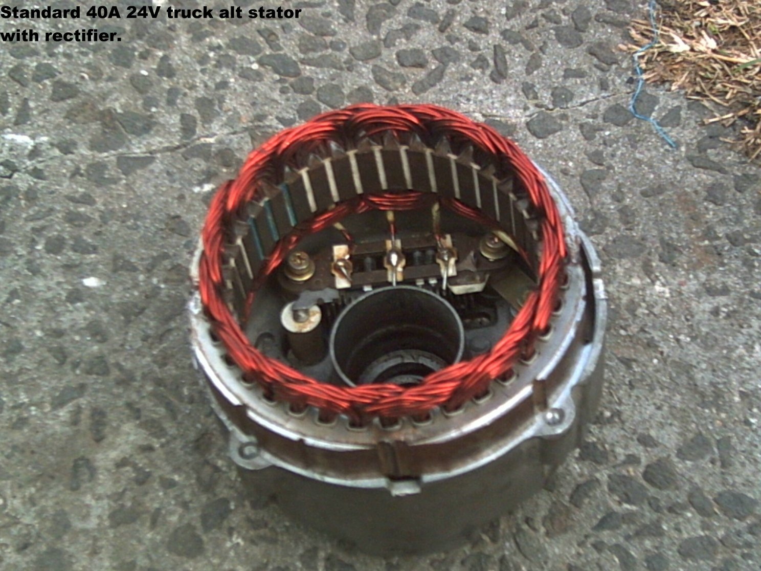

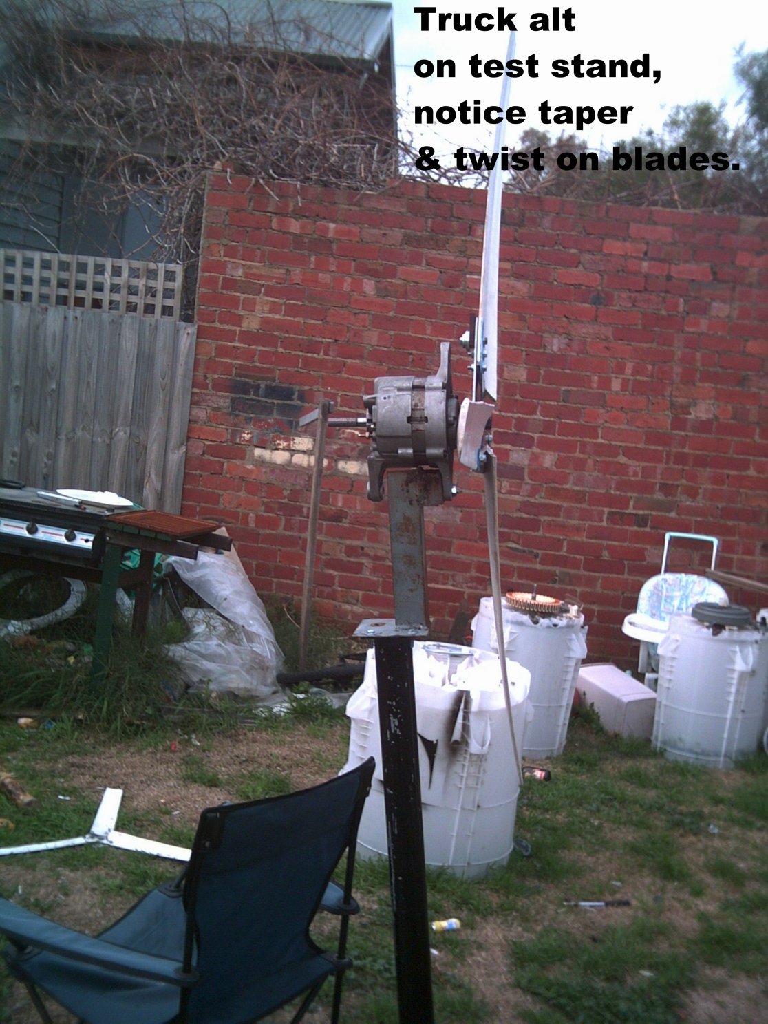

 For the last year or so i have used
                          bosch car alt's,
                          but you need to rewind the stator using smaller wiremore wingings, with 10A @ 10m/s.
                          With the truck alt's, they are 1kw and have a larger
                          stator with the correct amount of windings in heavy
                          gauge wire for use with 12 volt systems, you would
                          need to rewind the stator if you require 24 or 48
                          volts, as the speed would be too high for a turbine.
                          Larger magnet rotor area also increases power.
                          As i mentioned the new truck alt will put out up to
                          25-30A @ 10m/s with a 1.5M rotor. In higher winds it
                          could put out up to 40A which is its rating.
                          Go to the wreckers and ask for old ones that don't
                          work, eg: bad reg or brushes etc as you don't need
                          them.
