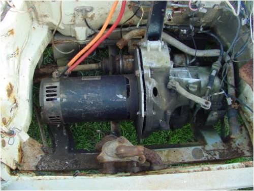

 I quickly made up an adapter plate, and made a coupling out of the two sprockets   with dual chains to connect them face to face. This would be the universal   coupling, and bolted it into the gearbox housing. The plate was cut from the   hull of an old ship. (waste not want not). I grabbed the 4kw motor I had used   for the grid tie experiment... note the chain adapter/coupling:
 and plonked it in like so.

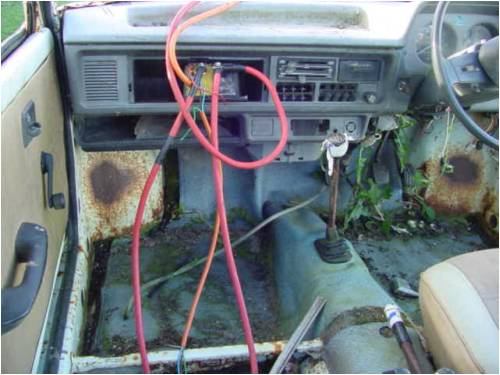

 The electronics were wired into the car... perhaps wired is too strong a word,   thrown into the car describes it better, and became housed in the glovebox. The   1204 controller I blew up when testing the 12v water heater,( a poor battery   connection let the voltage rise to high for a split second, and blew some of the   fets and other bit ans pieces.... not like Trevs though,) but with judicious use   of hot glue, it is back together again. The careful wiring job looks like this:

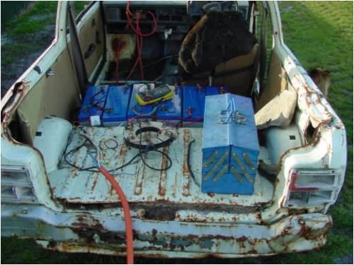

 The batteries were tossed in behind the seat, wired up and we have an EV   (forgive me Trev for even using the same name). Here we see the batteries and   the input line from the mill to charge them up. The seat was missing before I   dragged it home. The roof was caved in but by carefully panel beating it (sat in   the seat and pushed it back up), it will keep the sun off anyway.
 The mill does fairly poorly charging at 36v, so 20 amps is about all it will get   up to, but at that rate it fills up pretty quickly.
