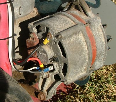

The alternator was from a Datsun and had a built in regulator, making the wiring a lot easier. The back of the alternator has a Positive terminal, a Negative terminal ( ground, chassis, earth ), and a IND terminal.
The IND is short for Indicator, the little light bulb in your car dash that lights up when your ignition is on but the motor isn't running. If it lights up while your driving, chances are you've thrown a fan belt. On most alternators with internal regulators ( mine included ), the alternator needs the Indicator bulb or it wont work. I've put a switch in series with the indicator bulb to make starting the motor easier, its a lot easier to pull start a motor when the alternator isn't loading it down. I've also added a amp meter.

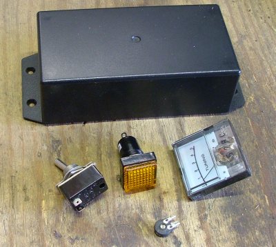

The parts for my "Control Box". Meter was from an old stereo, the rest I bought. The meter has a scale 0 to 5, and I'll use this to read 0 to 50 amps, so I don't need to draw up a new scale for the meter face. |

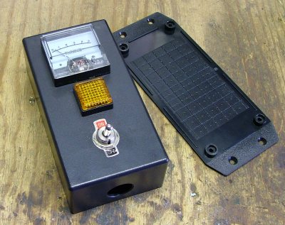

All the bits mounted. |

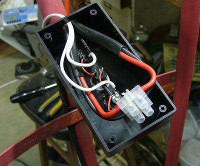

And wired up. Its a simple circuit so I used a rats nest technique. Not pretty, but no one will ever know!?? |
The connections at the back of the alternator. |

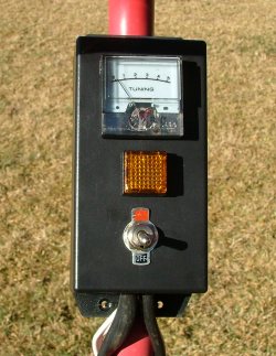

Finished control box mounted on handle bars.
To start my portable charger, I switch the Indicator light on, and connect the alligator clips across the battery I want to charge. When the indicator light is lit, I know I've got a connection.
Then I switch the indicator off, and pull start the engine. Once the motor has settled down after a few seconds, I switch the indicator switch back on and this will tell the alternator to start charging. The amp meter then jumps up to indicate the charging current.
I find the portable charger only needs to run for 5 minutes and the battery has enough charge to crank an engine
NEVER take the alligator clips off the battery while the motor is running. It can damage the alternators regulator and could also give you a nasty shock. Always shut down the motor first. |
