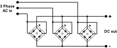

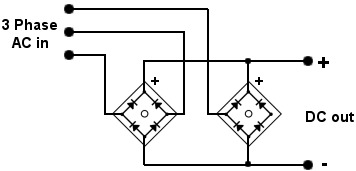

                            | You can make your own 3 phase bridge rectifier using single phase bridge rectifiers. The circuit below uses 2 bridge rectifiers, you'll notice we only use half of one bridge rectifier.
 Or you can use 3 bridge rectifiers as shown below. This will give a slightly better current capacity and better heat dissipation.
                            | The 3504 single phase bridge rectifier.  Most electronics parts outlets will stock a KBPC3504 rectifier, sometimes called a 35amp bridge rectifier. They are cheap at less than $4 each, and tough, with a 400v 35amp rating, very good value for money. You can use spade terminals or solder directly to the pins. I always keep a few 3504's spare.
