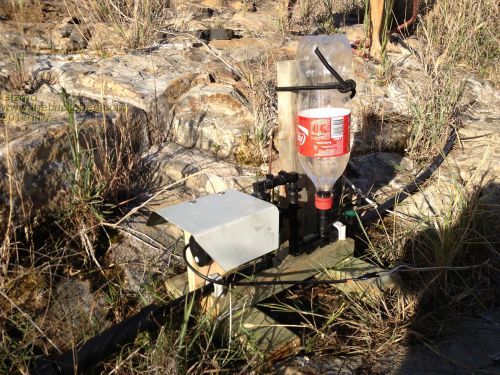

The pump is a little Flojet pump, FL-2203-1, 4 litres per minutes, over 60 psi, and draws about 1.8 amps at 12 volts. These are dirt cheap, you find them on ebay for around $30.

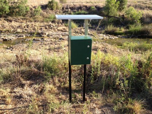

For the solar panel I bought a 20 watt panel from Jaycar. It pays to hunt around for solar panel prices, I found sources like camping outlets and automotive part suppliers were twice the price of a similar sized unit from Jaycar.

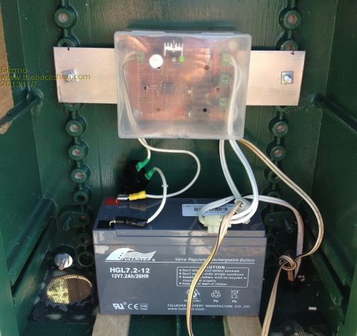

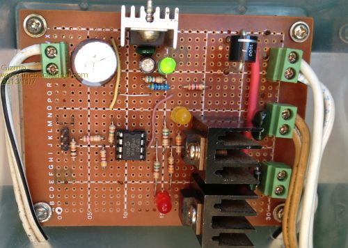

The controller is built around a 08M Picaxe chip and a few parts from my junk pile.
If you've never used a PicAxe chip before, here's a crash course. The PicAxe is programmed to monitor battery voltage and solar panel voltage. If the battery voltage is good, it will cycle the pump, 10 seconds on, 20 seconds off. I cycle the pump because its rated for intermittent use, the solar panel can supply 1.2 amps, the pump draws 1.8 amps, so I need to draw less than the solar panel can supply, to keep the battery charged. Also my water source is a living ecosystem, a soak fed pond with fish and other wildlife, so I don't want to take too much water away from it.

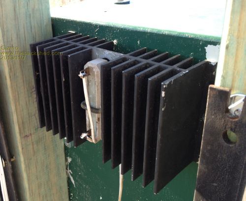

If the battery voltage goes much over 14 volts, the PicAxe switches in a 10ohm 40 watt dump load. Typically this happen in the middle of the day. I gone for a dump controller because its a simpler circuit that used components I had in my junk pile.
When the battery drops below 12.5volts, and the solar panel is no longer supplying current ( low sun ), the controller goes into night mode, and waits for the sun to come up and battery voltage to reach over 13 volts.

Component values are based on what I found in my junk pile at the time, and could be changed to suit your own supplies.
D1 is any diode that can handle 3 or more amps without getting hot, and the MOSFET's are nothing special.
The circuit was built on a peice of veroboard. The underside is a bit of a rats nest, as I made a few circuit changes in the development. Sorry, cant supply a layout, your on your own. The diode ( top right ) does get warm, and I might look at using a power diode from a old PC power supply, with heatsink.
The LED's indicate power, pump on and dump load on.
It would be a good idea to add a battery fuse into the circuit, I'm using a 5amp circuit breaker from a old power board.
Oringially the dump load resistor was mounted inside the box, but it generated a bit too much heat inside the box, not good for battery life, so I mounted the resistor out side. Its a 40watt resistor mounted to a old heat sink.

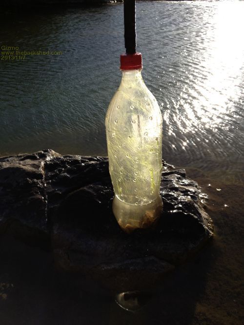

In the creek is another coke bottle, with lots of little holes and a few rocks inside to keep it under water. It works well, and I have another inline filter just before the pump, its remained clean after a few days running.
The circuit board and battery are mounted in a old fibreglass outdoor electrical box. There are a couple of vents at the bottom to let it breath, covered in mesh so no critters try to make it a home.
Finished controller. Its about 3 meters above the creek.
The pump is down near the water level. The pump could suck water up a few meters, but thats extra work, and any microscopic air leak can stop it working all together. I'm using a coke bottle as a pressure vessel after the pump, makes it easier for the pump to start, there's a big column of water to get moving when it cuts in.
