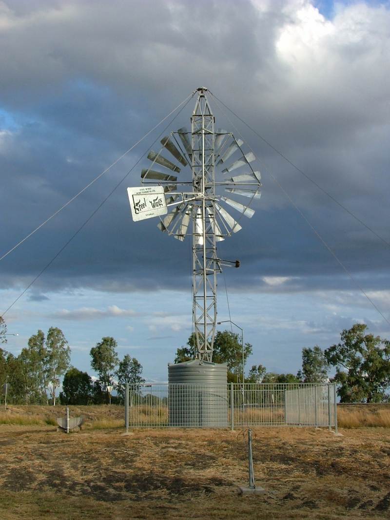

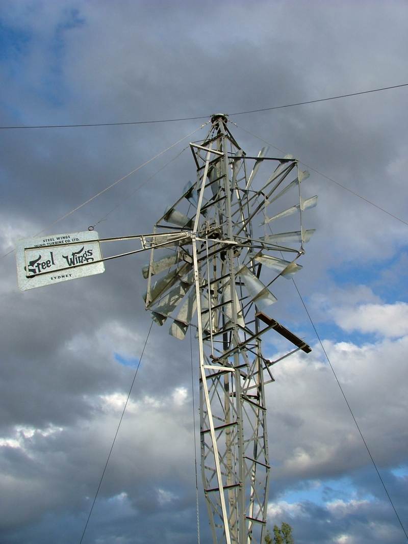

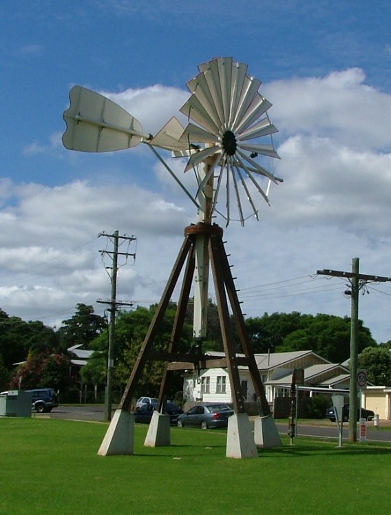

An interesting design, used a guyed
tower and the whole tower turned to face the wind. |

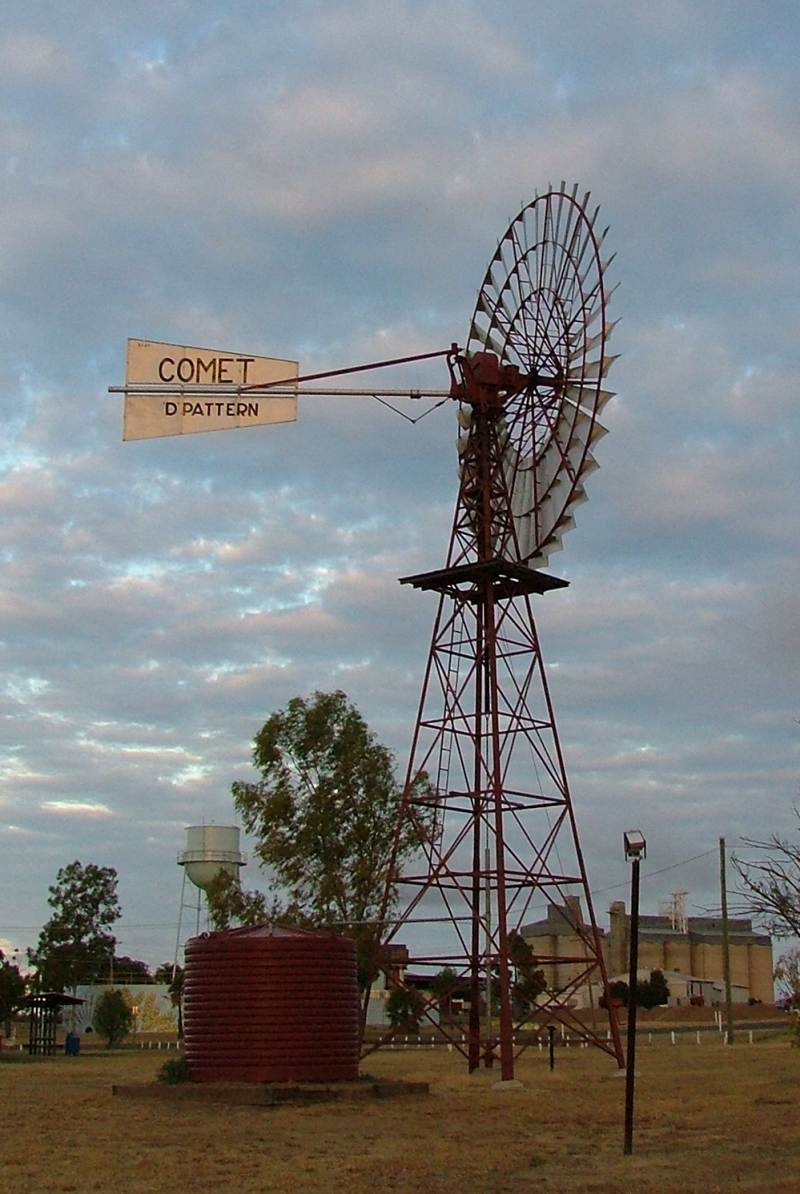

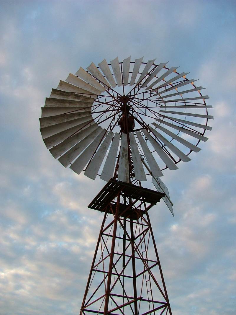

This old Comet was a monster, 8
meters diameter turbine. |

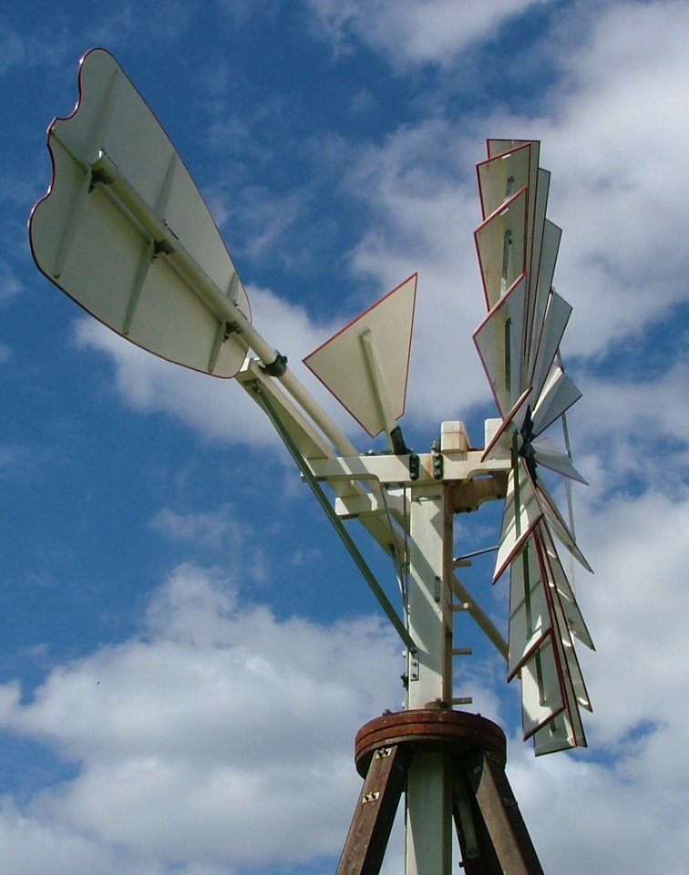

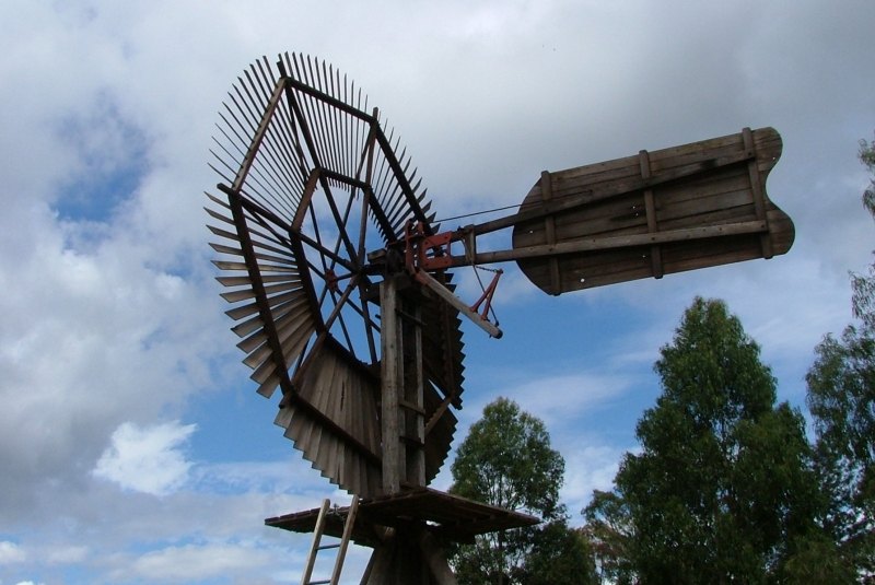

This one below now lives at Queens Park, Toowoomba. Its a down wind type, the turbine is facing away from the wind. |

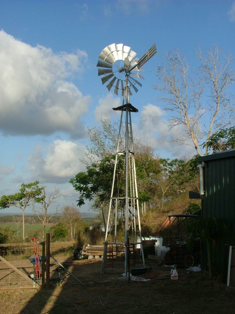

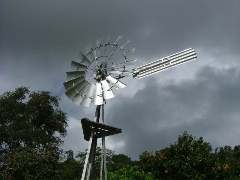

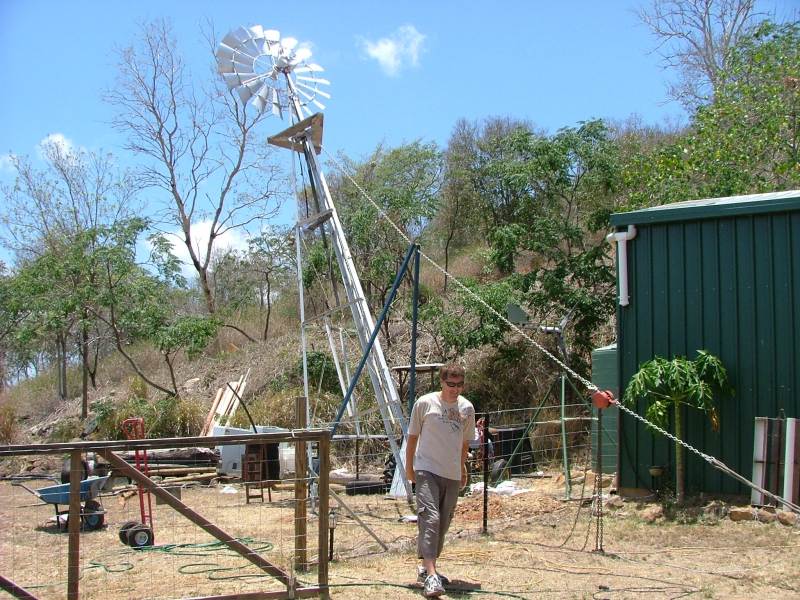

I n late 2006 I bought my very own windmill,
a old "Z" series Southern Cross, 6 foot turbine
on a 25 foot tower. The Z models had a piece of corrugated
iron for the tail and were made between 1930 and 1953.
It was only a baby as far as Southern Cross windmills
go, but it will do me just fine.

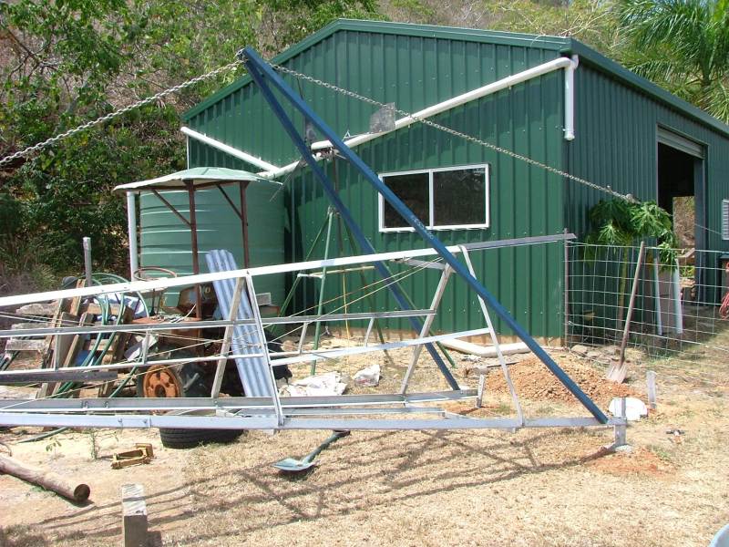

Getting ready to raise the tower.
The windmill head is still off, we needed to raise
the tower a few feet first so we could slip on the
head, it was a 2 man lift, bit of weight in the
old girl. |
This is how I rigged up a gin pole
to raise the tower. These towers are designed to
be lifted with a crane, not a gin pole, so I paid
extra attention to strength around the pivot points. |
Almost there, I was a little nervous,
past the point of no return. My mate Justin was
giving me a hand and I was glad he was around. |
All done. Fitting the tail was
scary, involves holding onto the windmill with one
hand and leaning out to hook on the tail with the
other hand. 25 foot seams like a long way up when
you on a little platform that wobbles. Next time
I'll do that when the windmill is at ground height
I think. |

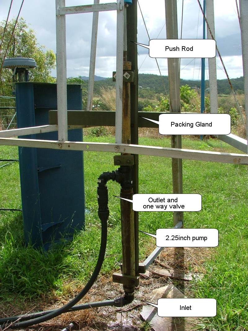

This is the pump mechanism. The
pump at the bottom has a 2.25in bore. The water
comes out in the middle section, through a one way
valve. The top half is the packing tube or gland,
sort of like a seal to keep the water in Apart from
the new poly pipe fittings, its all made from brass
and leather. |

Above is how I
rigged it all up. A 5,000 liter rain water tank collects
rain water from the workshop shed roof. At the bottom
of the tank is a outlet that is fed to the windmill
pump inlet. The pump outlet goes up the hill to the
header tank, a 1,000 liter tank about 10 meters up the
hill behind my house. The header tank has a over flow
that is piped back down the hill to the rain water tank.
So once the header tank is full the excess is fed back
to the main tank. At the bottom of the header tank is
the outlet ( not shown ) that feeds water to the house.
The height of the header tank gives plenty of water
pressure to the house. It all works a treat, no electric
pumps or float valves. And with a little maintenance
it will still be working in 50 years.
