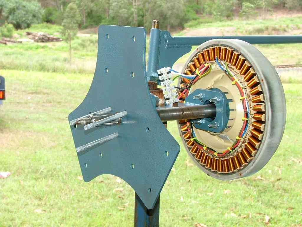

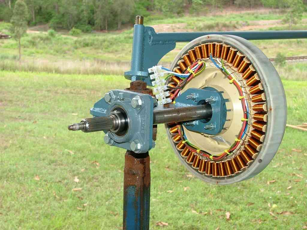

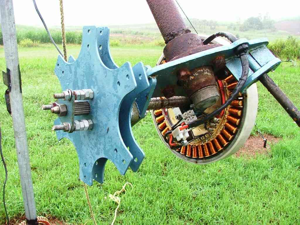

Mount the bearing plate securely. I
use a test post I put together to make windmill assembly
easier. The post site 1500mm from the ground, high enough
to spin a propeller.
![](images/hub-assemblys.jpg)
![](images/Dscf0742s.jpg) |

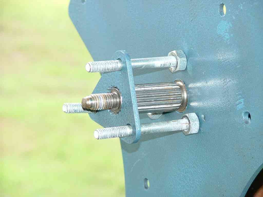

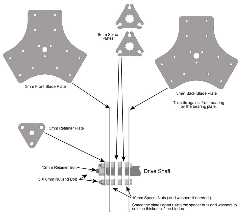

Slide the 3mm rear propeller hub plate
onto the shaft until it rests against the main bearing.
The three main bolts need to feed in from the back.

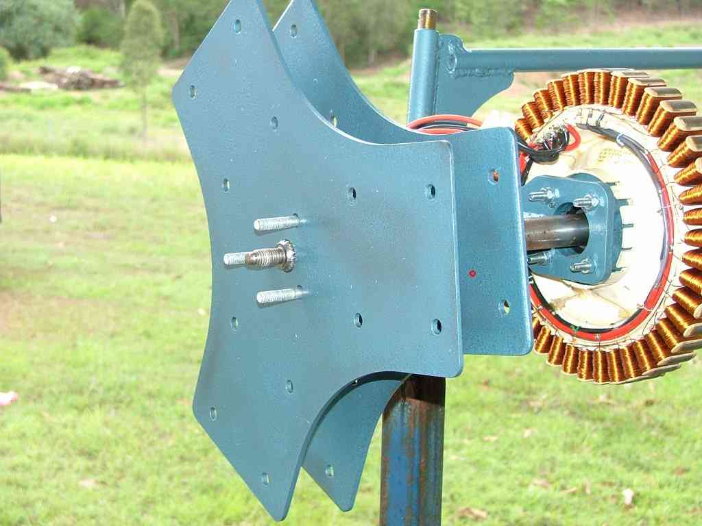

Next slide on 3 over sized nuts to space
out the next plate. Slide on the first of the small
8mm spline plate. These may be a tight fit, so gently
tap home with a hammer and drift. Keep sliding on nuts
and plates until you have reached a thickness equal
to the propeller blade thickness.
![](images/cad/Image10.gif)
![](images/Dscf0744s.jpg) |
Slide on the front hub plate.
![](images/cad/Image13.gif)
![](images/Dscf0745s.jpg)
Slide on more nuts until you can fit
the front retaining plate. When you tighten up the main
propeller retaining nut, the whole assemble should pull
down tight and square. |

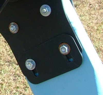

Included with the windmill kit are 3
plates with elongated slots. These are bolted to the
back of the propeller hub and adjusted to get the best
propeller balance.

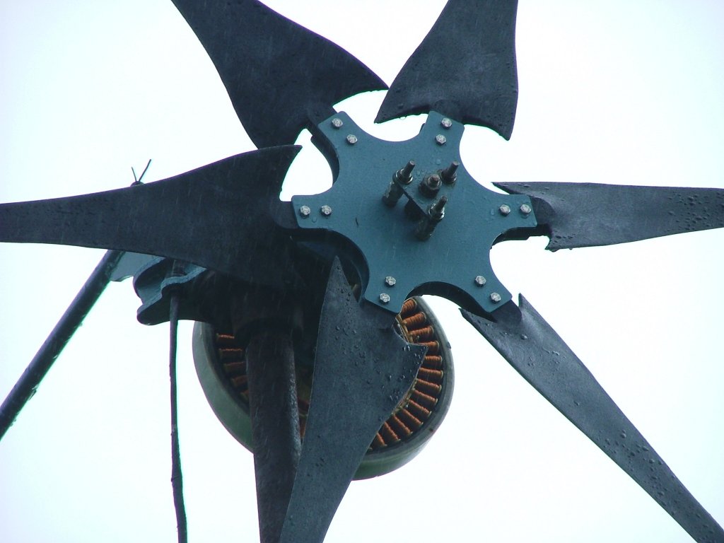

If you opt for the plastic blades, the
hub is assembled as above but this time with the plastic
blade support plates. |
![](images/Dscf0923s.jpg) |
Make sure you space the plates apart
correctly ( approx 18mm for the EcoInn blades ) |

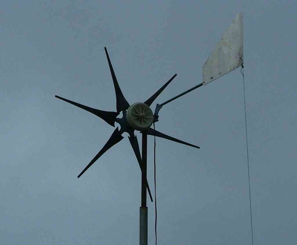

The finished propeller. |
