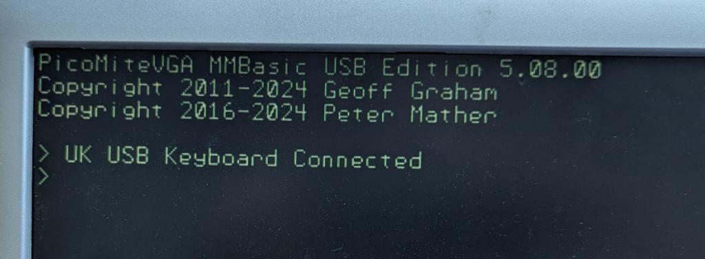

Please find attached a version of the PicoMiteVGA with USB keyboard support.
PicoMiteVGA.zip
Flash the firmware as usual
Connect a USB keyboard to the Pico USB connector using a suitable adapter
Power the Pico with 5V on the VBus pin (pin 40)
You can connect a USB-TTL converter as a console to pins 11 and 12 of the Pico (GP8=TX and GP9=RX)
The firmware will start as usual and assuming the connections are good will announce that the keyboard is connected. Connection works for me through a USB hub but the TinyUSB software may not support all variants

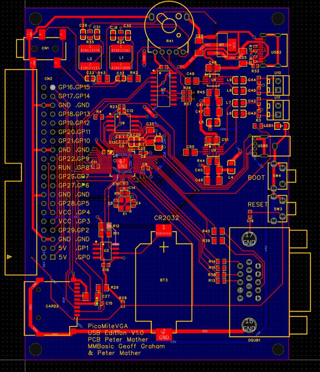

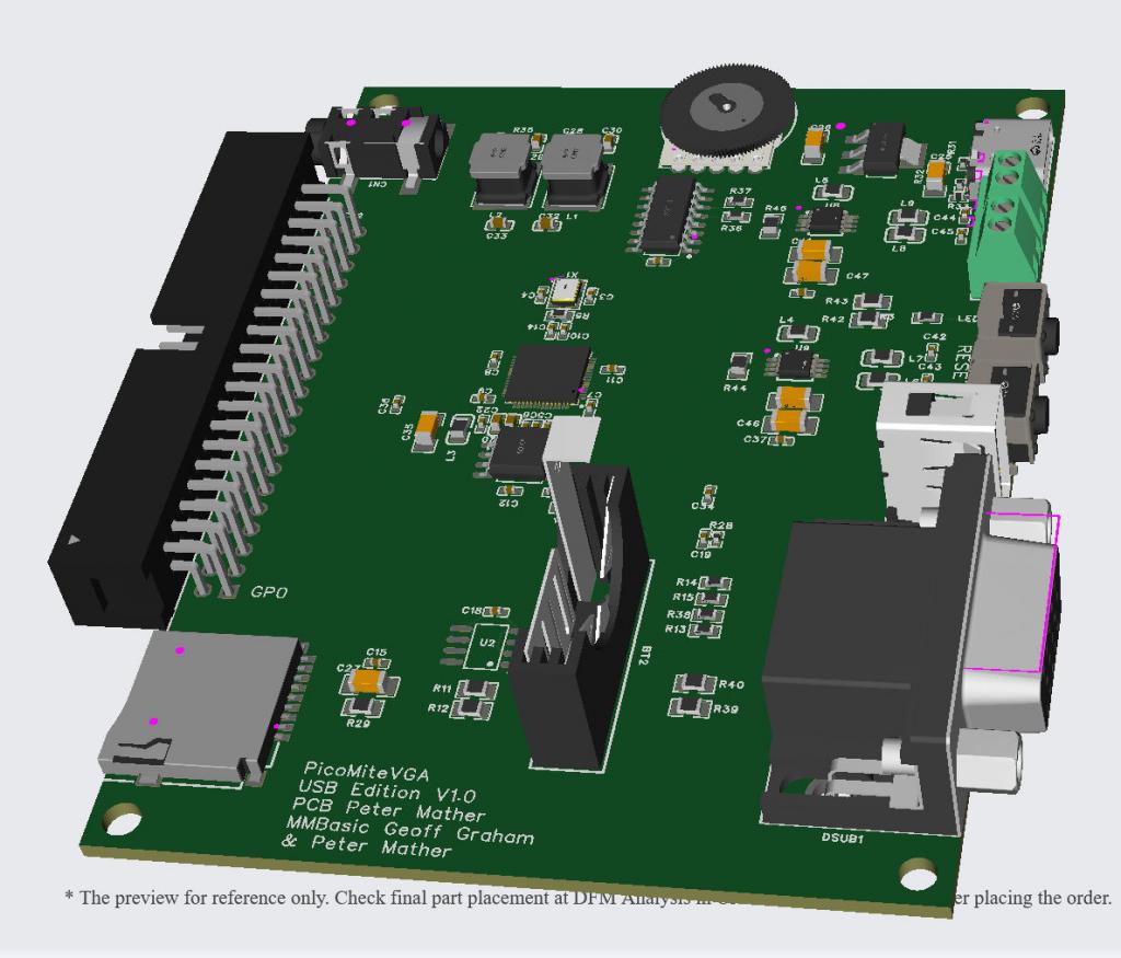

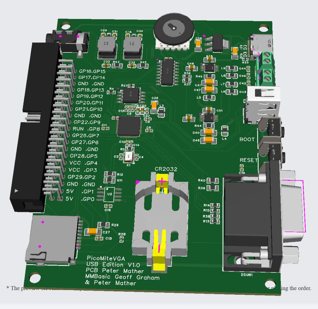

Here is a first cut at a layout for a CMM1.5 - just the components - nothing routed yet.
As per Vegipete's sugestion I've used an upright CR2032 mount but it looks very out of scale so I may revert to my favourite CR1220. Don't understand the issue with these. Widely available in the UK for pennies. The picture shows the DS3231 missing as JLC are showing no stock but LCSC have plenty so don't know why.
Schematic
d526a77b-1cb1-44b9-a0d7-183d33be6519.pdf
Price for 5-off fully built from JLC is just £66 + shipping. Bit cheaper than the CMM1 and CMM2!!!

Posted: 05:46pm 27 Jan 2024
Could you check something on that circuit diagram?
If you follow the the signal from pin 4 of the volume pot, it is connected through a 10uF cap to L4, then in series through C37 to U9 pin 3.
This differs from the other channel. Pot pin 2 only leads through C39 to U8 pin 3.
Posts: 11753
Posted: 06:12pm 27 Jan 2024
  Quote  Could you check something on that circuit diagram?
Thanks - it wasn't the only error in the amp circuit
I haven't found in EasytEDA how to cut and paste a circuit element from one design to another so I was copying by hand from a known working one but made a mess of it.
Posts: 6037
Posted: 06:18pm 27 Jan 2024
And U9 is powered between VCC and +5V.
Posts: 11753
Posted: 06:50pm 27 Jan 2024
  Quote  And U9 is powered between VCC and +5V.

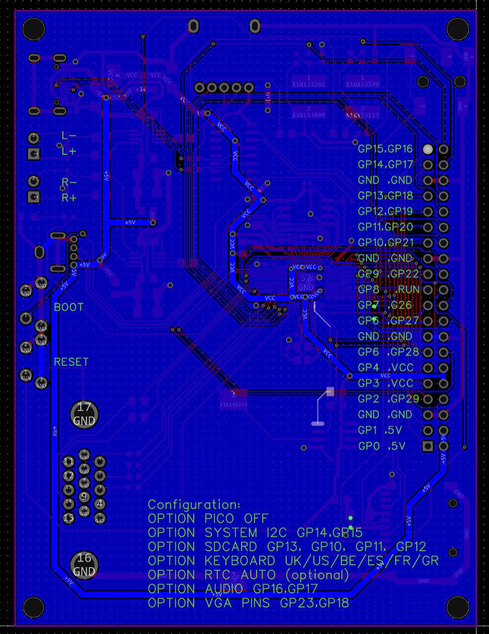

Hopefully now all correct and all routed ready to get built. Because I needed so much edge space I've got room for a flat mounted CR2032 to please the punters.
The PCB is 100x70 and double sided so current price at JLC is £1.57 for 5 - how can they make them for that?
Total price for 5 fully built less the RTC chip is £63.25 + shipping so £12.65 each

Posts: 4392
Posted: 07:05pm 27 Jan 2024
As always, in awe, but also:
Is it designed with any particular enclosure in mind ?
vegipete

Posted: 08:11pm 27 Jan 2024
Shipping is a bit killer, but these aluminum housings would be nice, except the side lengths are reversed.

Posts: 9036
Posted: 09:03pm 27 Jan 2024
Cases are a pain, Pete. Really you have to start with a rough board layout to see where you want connectors then find a case that's readily available and that will accept connectors where you want them. Then you can start to design the board. Either that or simply accept that most people won't be bothered with a case (as I did with PicoMite VGA Basic and Sweetie-Pi.coMite).
This time round (PicoGAME 4) I'm opting for the CMM2 case, but even that's a pain...
I do like those aluminium extrusion cases though. I've built a couple of projects in similar ones. The screws for the end panels are a bit nasty (seriously? Countersunk screws in non-countersunk holes?). Much nicer if you can put some better screws in.
Posts: 2981
Posted: 10:26pm 27 Jan 2024
Hi Peter, All,
Just a suggestion if it’s not too late, add 2 pads in parallel with each of the screw jacks for internal speakers in case someone want them internal to the box rather than externally connected.
Posts: 3350
Posted: 10:38pm 27 Jan 2024
1) They could just omit them and solder the wires on.
2) Turn them around so the wires are on the inside.
