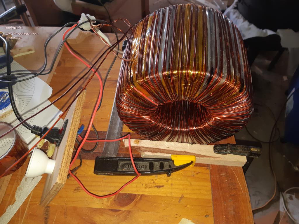

So i am trying to build at least a 6kw OZ MAD NANO Inverter to run the whole house. I have 48V DIY Powerwall setup to run it.
I purchased 2x3kw Aeroshape Inverters awhile ago and have started follow Marks build.
I have put there torroids ptogether and the measurement where 208OD,  100ID and 140 High.
After reading all the forums, i figured that 120 turns would be ok and easy to count.
So i have done 3 layers and i did the light bulb test after the 2nd layer, unfortunately the only thing i could find was light bulb wise was a LED, not sure if that ok or not.
I also did not realise i had to shorten the light bulb out until after i have completed my 3rd layer. So when i did my final testing these are what i had on my leads (1)239, (2)237 and (3)239. When i did my inital test with (1) and (2) there was a 0.6 potential between them, (without the shorten light bulb). When i test between (3) and  joined (1)(2) the potential voltage is 1v.
I havent finished off the 3rd layer yet.
I wondering if its ok to finish it off or do i need to fix up to a 0v potential.
I will add picture and questions later.
Thanks for your support
Andy

There will be 240v and 120 turns, so two volts per turn.
I think layer two may possibly be one turn less than layers one and three ?

Thanks Warspeed, that makes sense, i think i took a turn off [2] to make it match closer with [1], but i am thinking the measurements where wrong due to not shorting the bulb.
Now i am hoping i can add an extra turn on [2] as taking 1 of [1] will be painful.
What are the chances i could just add a turn on [2] on the same layer as [3] or do i need to cut back the mylar and place it on the [2] layer, reapply resin and mylar and then finish [3] layer.  [i am hoping i can test it on layer [3] at least].
Dam great start to the build.
Andy

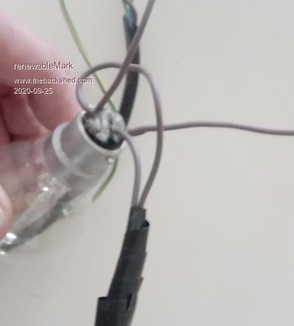

BTW I used to use a switch to run the globe by itself then short it out, one time I started it with the switch in the shorted position, and found it didn't trip fuses, the bulb just flashed briefly.
Try it if you like but keep in mind I had a incandescent bulb that may have softened the surge.

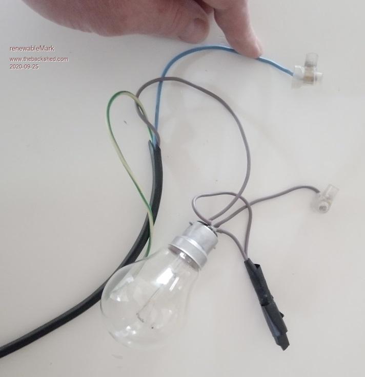

Screw connectors are for winding connections.
This is the rig I used, it has a 75w bulb.
Where the black tape is, there used to be a switch.
I don't use that anymore and they are shorted together.
With the bulb still in place it just gives a quick flash.
Cheers Caveman Mark

So i joined a length and heat shrink it and then wrapped around the core. BINGO all 3 are now 246v so problem solved. Thanks Tony.
Posted: 04:27am 25 Sep 2020
The empty toroid started out having a 100mm diameter hole.
You can keep adding layers until the remaining hole shrinks down to 70mm.
In theory that will provide equal copper areas for the primary and the secondary in the available space.
It never quite works out being exact, but 70.71% is a good figure to aim for.
If your secondary/primary ratio is 8:1  and your secondary voltage is 240v, then the primary will be 30.0v rms.
The PEAK voltage in the primary will be about 42.42 volts, and the inverter has to have enough dc from the battery to create those peaks.
Flat out, there are going to be voltage drops everywhere, which might all add up to two or three volts.
So minimum battery voltage to make 240v might be about very roughly 45 volts dc.
Edited 2020-09-25 14:38 by Warpspeed

So i thought i have ago at twisting my own {my body is regretting that decision at the moment, but nothing a few days rest wont fix, LOL}
I got an old extension cable and ran it thru the toroid 15 times, took a measurement of voltage. TONY spot on 30.4 volts, i then place a cable tie about 0.5m from the end to get my length. It was very losely wound so after measuring it was around 7.6m. .
So i followed the link provided by mark, plus my experience of making twisted wire for my POWERWALL, i twisted about 8.5m of 22 wires, i orderd some heat shrink {who know when it will get here}to go over it. Bit annoyed 2 wires came lose, so its not as good as i would have liked but i think it will work well enough. The diameter is around 13mm
NOW i have to ask how do i put the LUGs on as the enamel isnt easy to remove and i am worried that i can remove the outer enamel but how do i remove the inner ones enamels.{I hope that makes sense}.
Also my inner hole is around 72mm at the moment, i think my first layer wasnt as good as the other 2 layers, and i have a lump around where all the wires are connect on the outside, so i wont add another layer.
Now what to do next? I was thinking getting started on the chokes.

Andy what mm2 wire did you use?
Lump on the outside makes no difference at all BTW.
You get better at doing these, next one you'll get 4 layers and 70mm hole left.
