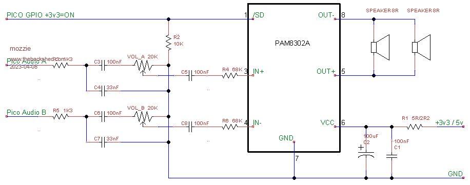

Using this circuit here for sound effects etc and creates quite a bit of noise.
Posting this as hopefully Tom and others may be able to use it as a basis for driving a mono speaker from the Pico.
PAM8302A version is differential and Peters MONO function in play sound means almost no noise when idle.
Once again component values can be fiddled with to change filter settings and gain:
R3+C4 / R5+C7 are low pass filter for PWM carrier supression, change as desired or add LC circuit.
C3+VolA / C6+VolB High Pass and AC coupling (C3 / C6 optional but recommended)
C5+R4 / C8+R6 are High Pass and AC coupling to PAM Chip
R4 / R6 set PAM8302A gain as per data sheet, RTFM
Keep the AudioA / AudioB paths the same, differences will cause balance (noise) problems.
Will also work with Play tone and Poke &h40050000,&h09 for same frequency both channels or use different frequencies for odd effects, gain will need to be lowered.
PAM8302A Datasheet from Element14 is recommended, others are missing an important f in gain calculation.
Have a good (long) weekend.
Lyle.

@Mossie, Is it possible to reduce the component count of that circuit?
- Remove C3 and C6 because you are AC coupling the output of the pot, I don't think it is also necessary to AC couple the input as well.
- Remove R4 and R6. I presume that they are there to attenuate the signal to the PAM. Why not increase the value of the 1k3 filter resistors to attenuate the signal at that point? With appropriate changes to the filter capacitors of course.
Bill
Posts: 9030
Posted: 06:56am 09 Apr 2023
R4 and R6 set the gain, it's not simple attenuation. They are necessary even though they don't look it. :)
Turbo46
Joined: 24/12/2017
Posts: 1694
Posted: 07:45am 09 Apr 2023
Thanks Mick, that will teach me to go off half cocked (maybe). I still have not looked at the data sheet but as I do understand how differential amplifiers work that sounds right. I would have expected the gain to be set after the differential input stage though.
Bill
Posts: 9030
Posted: 08:32am 09 Apr 2023
It caught me out too, when I was looking at the LM4871.  :)

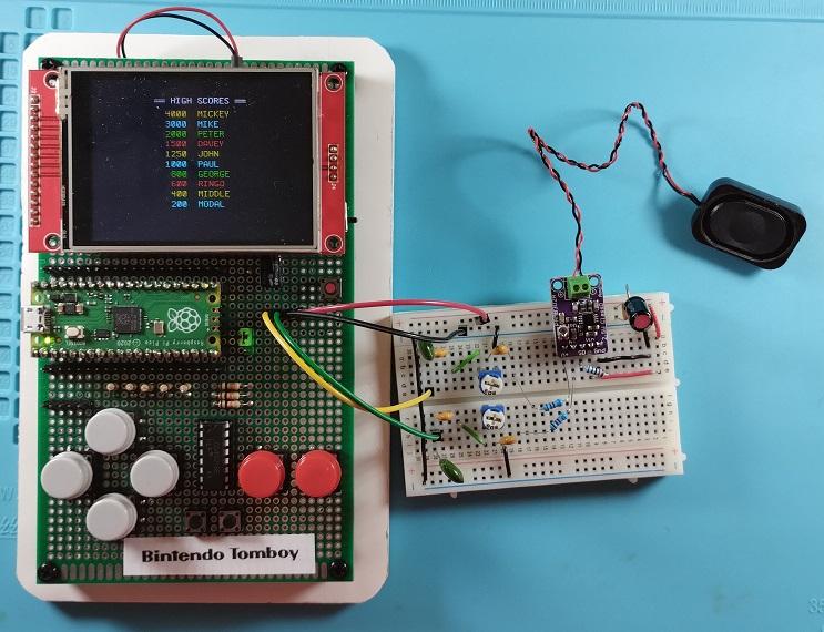

Hi folks,
Finally found time to build @mozzie's last posted circuit (but with only one speaker) and this, plus Peter's improvements to the firmware (especially the Mono flag to PLAY SOUND), plus a marginally better speaker, plus switching to triangular waveform, plus switching up an octave have produced a satisfactory result - Thank you!!!
It draws ~110 mA when running, which on a 2500 mAh battery gives much more battery life than it needs.

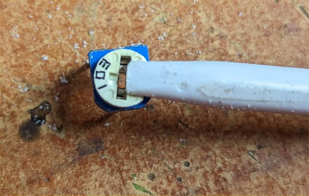

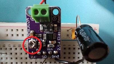

The only problem I had was with the little potentiometer on the PAM8302A, none of my screwdrivers would bite (and I suspect it should be a plastic "screwdriver" anyway) and I ended up using needle nose pliers which wasn't great. Can anyone tell me what tool I'm supposed to use ?
Posts: 9030
Posted: 03:35pm 07 May 2023
I can't remember what I used now. Probably one of those little screwdrivers used for tightening the screws in glasses.
Posts: 4388
Posted: 03:50pm 07 May 2023
  Mixtel90 said  I can't remember what I used now. Probably one of those little screwdrivers used for tightening the screws in glasses.
They would be too small. I have very small screwdrivers ... and glasses.
Posts: 11745
Posted: 03:56pm 07 May 2023
If you have a surplus of those white pointers that come with displays then just sand one down to make a suitable screwdriver
Posts: 9030
I have various little screwdrivers - that's why I can't remember what I used on that sort of pot. :)  I also have special trimming tools. I don't think I have any of those pots at present so I can't try one.
Posts: 4388
Posted: 04:09pm 07 May 2023
Thanks guys, after some digging I found a 6 pronged non-pointy thing in my cheap phone "repair" kit, which after I overcame my distaste for poking something metal into the pot seemed to do the job ... even though it obviously expects a 4 prong thing ¯\_(ツ)_/¯.
I may still shave down a screen stylus though, I have at least 3 knocking about.

Posts: 4388
Posted: 05:56pm 07 May 2023
Peter, regarding your photo. Why have you mounted a potentiometer onto the top of a Crème Brulé? Can we run MMBasic on cold desserts now ?
Edited 2023-05-08 03:57 by thwill

  Quote  it obviously expects a 4 prong thing
Isn't that a small philips head screwdriver AKA cross head? Any self respecting jewellers screw driver set should have one to suit. I'm surprised that your phone repair kit doesn't. Knitting needles and crochet hooks can be filed down too.
RF tuning tools are handy too.
Bill
Posts: 4388
Posted: 09:01pm 07 May 2023
  Turbo46 said  Isn't that a small philips head screwdriver AKA cross head?
That's what it looks like, but it's shallow and the "cut" is not terribly well defined. I have a large selection of small Philips screwdrivers and couldn't get one to bite ... perhaps I was just being more than usually incompetent, let's not worry about it.
Posts: 6572
Posted: 09:45pm 07 May 2023
To use a Philips head driver, you probably have to grind the tip off.
I prefer plastic flat blades but sometimes it needs metal get get it moving.

Very pretty, but having tested it satisfactorily and now soldered it to the Mk 2 prototype I think I'm basically* satisfied with what @mozzie proposed.
* On @Turbo46's suggestion I've removed/shorted C3 and C6 and replaced the stereo pot with a single 50K pot (as a variable resistor) between IN+ and IN-, this seems to be how the tiny 10K pot (set to 0 for my build) on the module works - tell me I'm wrong.
Can someone explain what is going on with /SD. It's "shut down" and the bar means it is active low (?), and the module contains a 10K pull-up to VCC so if left disconnected it won't do anything will it ? @mozzie's schematic adds a 10K pull-down so if there is no signal from the Pico GPIO line then ... ?
