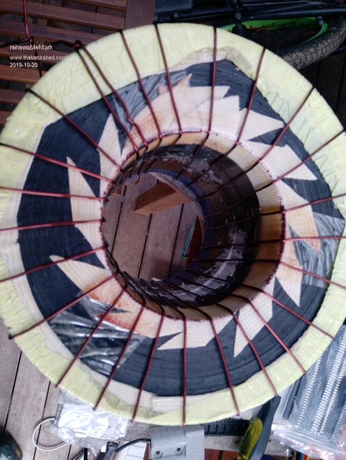

I got some rubbish wire and wound 25 turns.
This is what it looks like.
Just a bit worried considering I'll be using recyled wire there may end up being a short somewhere.
I'd be inclined to do at least one mylar wrap between the 14 hands/windings.
Could probably wind 2 hands and do a mylar.
Keeping in mind doing the primary with small wires will take up a heap less room than single core 35mm2 so the extra 14 or 7 layers of mylar should hopefully not add too much thickness to the centre core.
If they all start the same place and finish the same place it should end up being fairly neat.

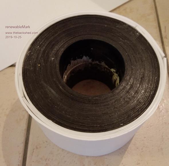

I found the 5mm coreflute was too stiff to bend around nicely, so got some 3mm stuff.
I put three layers on so far.
Tony, how many layers would you put on to reduce the capacitance?

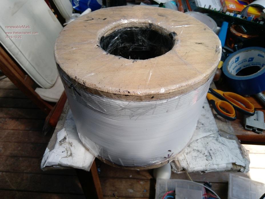

Recon I'll do a ply cap top and bottom as the coreflute won't take the pressure when pulling the wire tight around the corners.

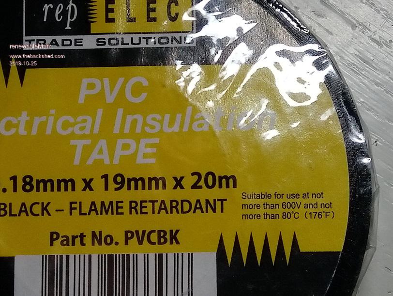

Also, I'm running low on mylar film, could I just use electrical tape?
This one has no more than 80c.
Mine have never gone anywhere near that.
Or is it just safer/wiser to stick with mylar?

Its difficult to nail down an exact distance, its really a judgement call.
But I would think 5mm to 6mm should be pretty effective, and anything more than that would be getting into the point of diminishing returns.
I bought some polypropylene packing tape from Bunnings a while back:
https://www.bunnings.com.au/bear-48mm-x-75m-clear-polypropylene-packaging-tape_p1661555
Polypropylene has some very good electrical properties and is o/k up to about 90 to 120 Celsius, and melts at 160 Celsius. The sticky part is a bit of a bugger, but its usable for some high voltage transformer applications, and its cheap.

BTW since you said 5 to 6mm of packing I took one layer off leaving it with 6mm of packing.
Yell out if you re consider before the copper starts.
Cheers Caveman Mark
Off grid eastern Melb
Posted: 09:39pm 26 Oct 2019
Two layers around the outside, and a couple of large "cut out washers" of the material stuck on each end should do very nicely.
I don't know what you can do around the inside of the hole. Probably nothing without losing too much diameter. But any extra spacing material you can add there would be an advantage, even if its minimal.
There is no mad rush, we are not working towards some time critical deadline.

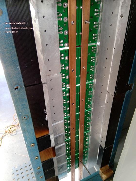

That is one awesome inverter board
renewableMark
Joined: 09/12/2017
Posts: 1679
Posted: 04:59am 01 Nov 2019
  BenandAmber said  That is one awesome inverter board
It's actually 6 small boards assembled together.
The top three power boards will be one inverter, the other three will be individual inverters.
The driver boards fit on top of the power boards.
And one control board sends signals to the driver board/s
These power boards can also be used as a spwm inverter ala Madinverter/Ozinverter, with the use of a third (spwm)control board that can click in on top of the driver board.
So you could use just one of the square power boards with 8 fets and make a little Spwm inverter or use the ribbon expansion cables either side and make one with 3 power boards and 24 fets.
Or like I have done and make 4 individual inverters that will run the Warpinverter.
Mackoffgrid designed it all, took me a while to understand the wiring and different set ups it can do, but once I did it becomes clear how clever the design is.

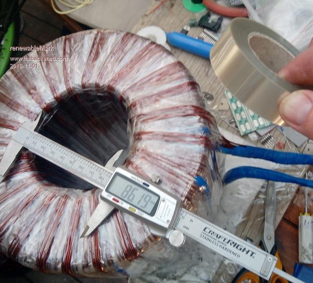

I have 10 layers/hands of 25 turns on so far.
ID has dropped to 86mm from 100mm.
4 more winds to go, then a good wrap of the new mylar and onto the secondary.
Tony, should I use the coreflute packing between the primary and the secondary as well?
Got some more mylar film. ($18plus GST)
It's from regal bleriot in rowville if anyone needs some.
http://www.regalaustralia.com.au/
These guys in Adelaide sell it too.
http://www.advancedthermalsupplies.com.au/index.php?route=product/category&path=61_71_121
