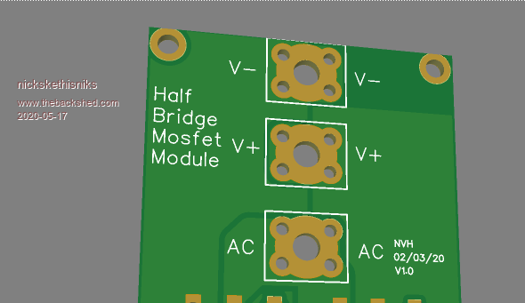

Hi, don't know if it's a good suggestion or already to late, but maybe we can have the option to solder the wires directly to the pcb. Screw terminals are good for debugging and changing boards, but once up they will stay there. :)
Something like this:
If I understand correctly we just need an auxiliary 12V power supply, I'm thinking of using more stuff like this in the future:

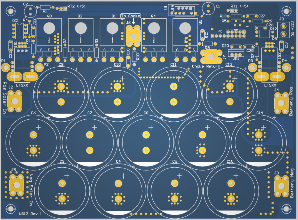

Hi Nicks, I will provide a 4mm plated through hole and masked off area.
I had thought of this but was alittle concerned about impedance, but maybe a brass or nickel/brass screw soldered from the underside or screw and nut soldered both sides of the PCB facing upwards would allow a terminal and another nut screwed down to fasten it effectively ?

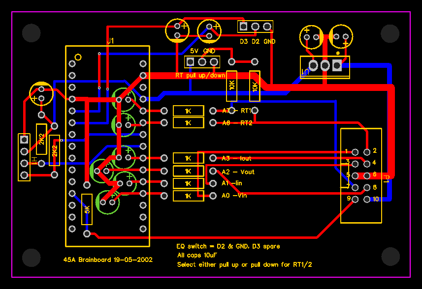

The brainboard is completed for Wiseguy's PCB of the converter.
Through hole components.
WG's PCB

Some 470uf 200v capacitors can be scrounged from (about half a dozen) old ATX power supplies, if need be.

Probably need a list of components to order.
Control board
Electro caps 10uf x6 16v?
2k2 x2
1k x6
10k x2
U1 ?
P1 10 pin socket like here
Nano
header pins like here
Power board
13x 470uf electro caps 200v or above.
The rest on the board isn't marked with values.

Mark, make absolutely certain those 470uF electrolytics are of the correct physical size, and have the right footprint.

U1 is a 7805 linear regulator (TO-220)
