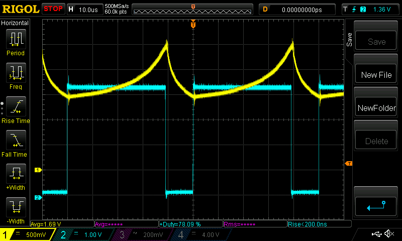

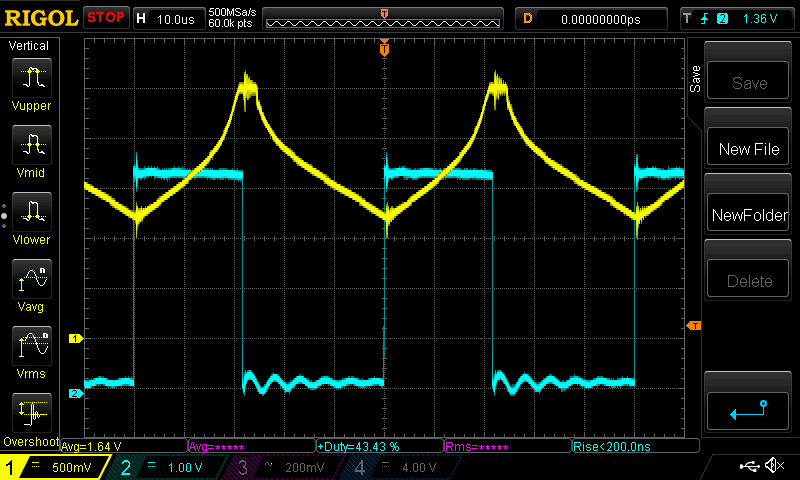

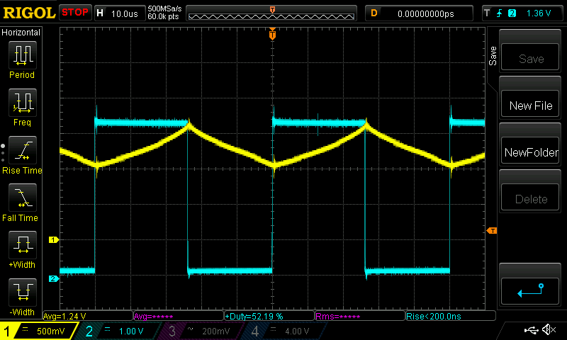

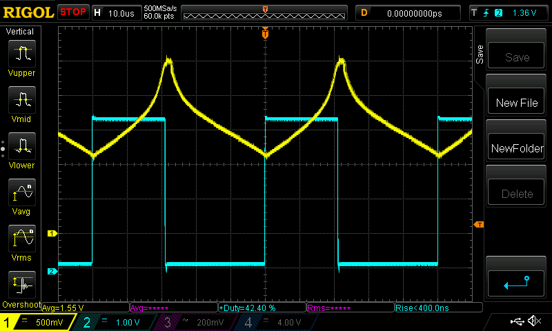

This will be a DSO trace heavy post.
Yellow is inductor current.
Light Blue is PWM output, the same sort of as the MOSFET gate drive.
57V input, 30 or so Volts output.
The current scale is 42.6mV /Amp.
So 1 Volt (2 divisions as seen below) = 23.5 Amps.
First is a crap (bad) inductor for the application.
here it is at 900W, about 50% pwm.
it is showing signs that it might be near saturation. see the sharper rise of current near the peak?
and at 1800W, a lot more current is passing through it now.
We have saturation here. Clearly we have just about filled the core with all
the magnetic energy it can take.

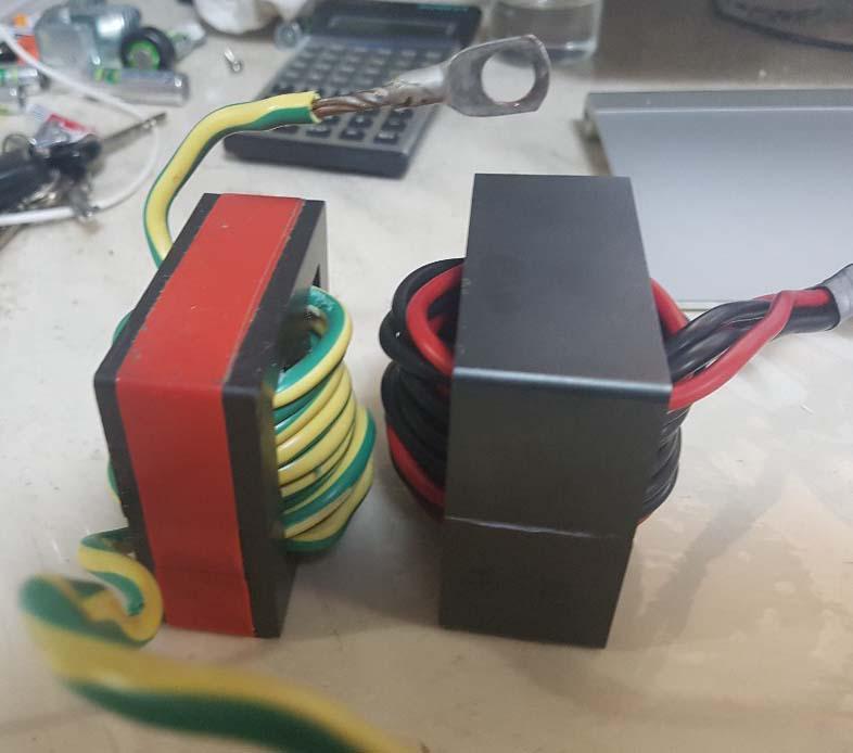

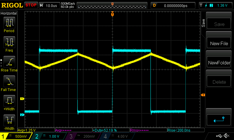

Now an inductor of a design and build that I prefer nowadays:
at 800W
straight line current traces up and down. Perfect.
and at 2000W
still looking good. This is what I want for the charge controller.

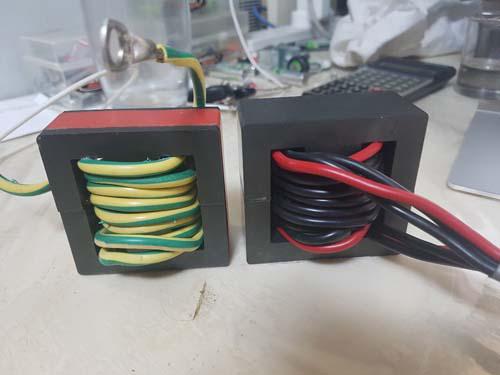

Here are the two inductors. Can you tell which is the bad one and which is the good one?
The smaller one with red tape is the bad one right? Small is bad...
Well, the smaller one has 9 turns. The bigger one has 5 turns.
The smaller one has a 1mm gap in the inner core. The bigger one has no gap.
The crap inductor was the bigger one on the right. No air gap means saturation will happen with lower current.
The smaller one with red tape is the standard inductor I use for inverter builds.
About 47uH. 1mm gap. 9700 Al. 7 to 9 turns.
It makes such a difference to the survivability of the inverter I can not begin to express...And they make great candidates for proper sized dc-dc converters.

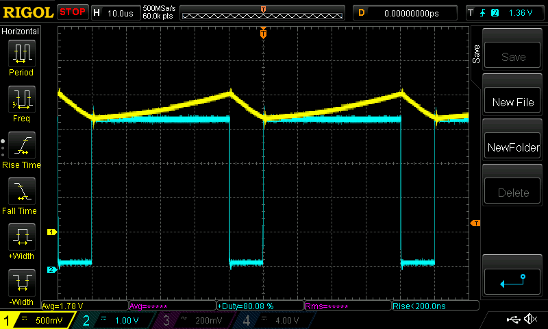

I finally tested the good inductor with 95V input and it saturates too.
I probably need a larger inductor with higher current capacity.
An easy fix for me is to use two in series.
Which I do in the inverters.
The Yellow curve clips at the maximum the current sensor can take which is 2.5V output. The saturation is clearly evident with the steeply increasing slope at it nears the peak.
This is at 1900W, 95V In, 45V out.
Edited 2020-05-21 21:50 by poida

approaches saturation.
The story might be very different at 45A and 57V out, which is 2565W output.
Dunno. We will see when the time comes and I do some higher power tests.
To get 108V DC I put the Eltek 2kW supply in series with the 52V SLA battery.
This is probably not a good idea.
And having 108V DC backed up with a lot of capacitance AND about 40 Amps of supply
is not a situation where mistakes are only minor things to ignore.
If inductor choice becomes hard and expensive, I can always increase pwm frequency.
Going from the present 20kHz to 40kHz would double the MOSFET switching losses but also prevent saturation at 2500W @ 100V input while using the same inductors as used in the above tests.
I think switching losses will be found to be quite insignificant compared to other losses in the converter.

Great stuff Peter.
Rule of thumb with chokes, always pack as many turns as will fit of wire of sufficient gauge to carry the required current.
Then adjust the air gap to reach best compromise between saturation level and inductance.
If you need more of either, just stack more cores together, and try again.
As Peter says, its always very difficult to tell just by looking, whatever you have, needs to be tested.

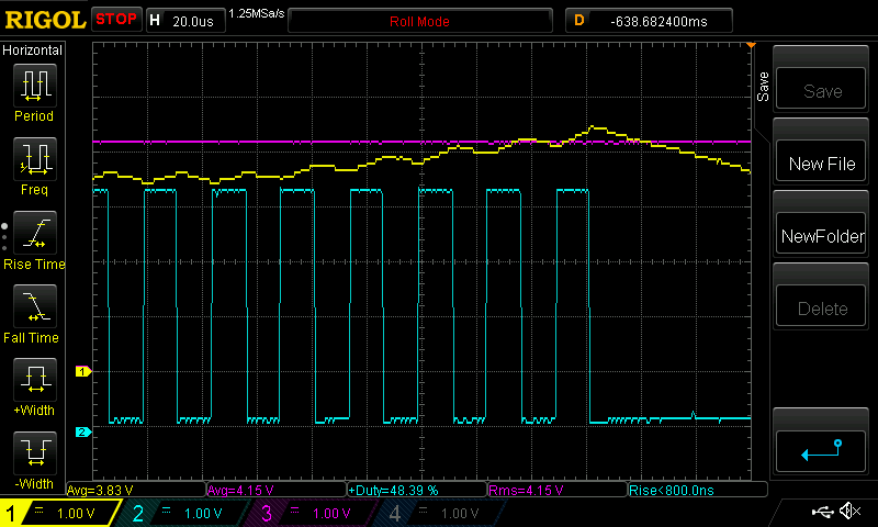

Earlier today I wondered would the prototype charge controller survive
a short on the output terminals.
When given a current limited input supply, sure, no problems.
The then hooked it up to the 48V SLA bank, with a 20A AC contact breaker
and tried again.
Nope.
No smoke. Just no MOSFETs working as they should.
Lucky to have a stock of HY5110 to press into service.
So after a bit of time I have something that CAN survive a short on the
output.
We can use the atmega328p comparator system. (The Nano and Uno use this chip)
This means we use pins D6 and d7.
I have a set point voltage from a multi turn trimpot on d7
And I have the output of a LEM 16 current sensor going into d6.
Now I can short the output with a spanner and no destruction.
The firmware once it sees this over current situation just goes into
a useless infinite loop, needing a reboot. But the LCD shows "OVERCURRENT"
as a clue to the human.
Here is how fast it works.
Purple is the current limit set point.
Light Blue is PWM.
Looking from left to right we see things going well and then the current
increases. And then it exceeds the Purple line causing immediate stop of
pwm.
This might be an important addition to the design.
Or just leave it off and ensure you do not short the output..
Edited 2020-05-23 17:13 by poida

I tried using the interrupt function but it was a pain in the arse.
It kept calling the interrupt many times and things just went from bad to worse.
The code now looks at the comparator result (either = 0 where d7>d6 or = 1
iwhen d7<d6....or the other way around..) each time the 40kHz pwm interrupt occurs.
If it finds =1 then it stops the pwm duty cycle and stuffs up the normal running
of my program so that it needs a reboot. This is OK with me.
I foresee the controller will be built with this over current addition
and setup so that it will trigger when inductor currents are way,way above normal values.
It will need a good current sensor, and some skill in setting up.
I think only a DMM is all that is needed.
Also, I think we can use not only the LEM LTS 16 series sensors but also the
Alllegro sensors.
I thought that in the event of a short circuit, the inductor current will increase pwm cycle by cycle until it exceeds a defined value. Then I can stop pwm immediately.
That is what I am doing and I think all it has to do is protect the controller from destruction and then it has achieved it's goal.
I think cycle by cycle current control might be possible but not worth it.
All I want is a controller that will survive. Maybe not be 100% the best, just 95% good enough.
