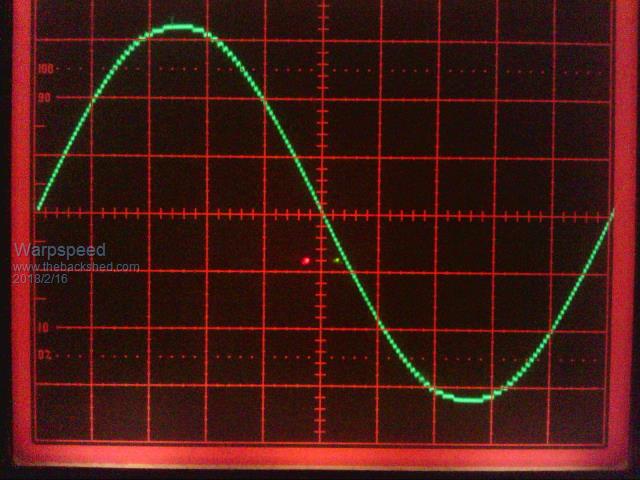

For those not familiar with multistep inverters, this is a picture I took about a month ago when I was playing around with my new document camera. There are 81 steps peak to peak and this was taken by poking a 1000:1 CRO probe into the mains active (100v/div on screen).

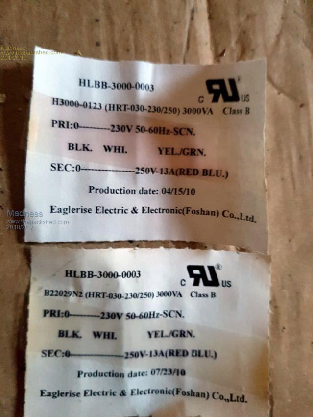

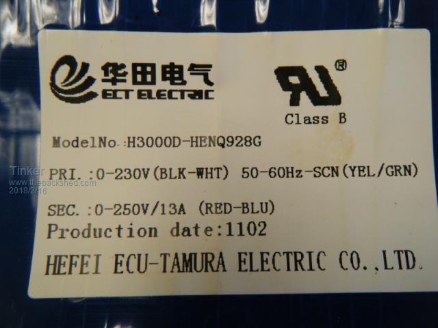

Posted: 01:51pm 16 Feb 2018
Tony, below is a picture of the label affixed to the outer side of my 3KW Aerosharp toroids. All three I rewound had a similar label on them.
Madness
Joined: 08/10/2011
Posts: 2498
Posted: 09:08pm 16 Feb 2018
This is one type that I used.

Posted: 09:19pm 16 Feb 2018
Mine was the same as Mad's one.

Posted: 09:30pm 16 Feb 2018
O/k thanks guys, seeing is believing !
It looks like a rewind job then, which should not be too difficult.
It also means that it does not really matter which winding is inside or outside as both will have very nearly the same number of turns anyway.
I am planning to use only one core so that should make things easier as well.
It still has me stuffed though, how these can possibly work right down to 150v dc input with a 230v primary winding.
