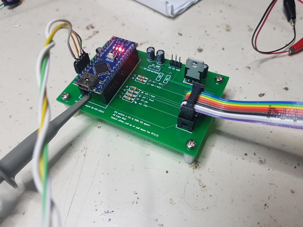

good progress with code.
I have settled on an unpleasant choice in the project.
I suspect I2C interface can on occasion cause some mistiming
with the pwm, particularly when in NIGHT mode.
I don't like it.
When using the arduino softwareserial library, I find no problems
at all. This has resulted in a couple of things.
The I2C 4 pin connector is not needed for I2C.
But we can re-purpose one of the pins to be TX for
softwareserial. I choose A5 which was used for the I2C and so we can
still use the 4 pin connector.
This means you need another nano, to do the translation from serial
to IC2. I had a quick look and saw no 20x4 LCD with serial input
on aliexpress. They all seem to have I2C. Maybe we can find them somewhere.
I have tested:
- mppt -> absorb transtion
- absorb timer, which leads to..
- transition to float
- EQ, to run for a define time
- EQ cancel due to low bv, then back to mppt/absorb
- float cancel due to low bv, leading back to mppt/absorb
- timeout for bv drop while in EQ
- timeout for bv drop while in absorb
- timeout for bv drop while in float
The "hardware" overcurrent still works fine, and once triggered
pwm goes to near zero and after 60 seconds, it permits normal
operation. Which is a max power scan and into mppt track mode.
Lots of things are set up via the usb serial console.
Here is what it looks like now:
A - max heat sink temp   100 degC
B - max inductor temp    100 degC
C - cal. Input Volts     0.0885 ( 28.14 V)
D - cal. Output Volts    0.0893 ( 12.68 V)
E - cal. Input Amps      0.1173 ( 0.12 A)
F - cal. Output Amps     0.1173 ( -0.00 A)
G - zero Iin sensor      518 ADC counts
H - zero Iout sensor     518 ADC counts
I - Max battery Volts    15.00 Volts
J - Absorb voltage       13.50 Volts
K - Absorb tolerence     0.50 Volts
L - Maximum Current      30.00 Amps
M - Night power          10.00 Watts
N - Zero Energy total    0.00 kW.hr
O - Equalisation voltage 15.00 Volts
P - EQ duration          60.00 minutes
Q - EQ reset voltage     14.50 Volts
R - Absorb duration      60.00 minutes
S - Float voltage        12.70 Volts
T - Float tolerence      0.50 Volts
U - fast OC enable       1 (ON = 1, OFF = 0)
Z - Write defaults
We can choose to enable the hardware overcurrent protection now.
If you choose to not build in the current sensor needed for this, disabling it
might be the way to go.
The brainboard will need a bit of extra soldering, for the overcurrent protection.
Two wires for the set point and current signal, one for 5V, one for ground.
And a trimpot to set the setpoint. Not too bad. Maybe add this to v2 of the board.

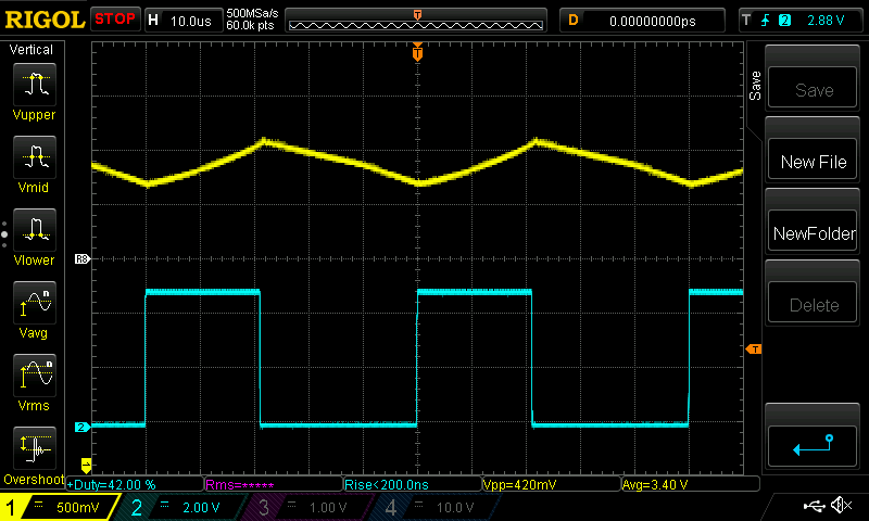

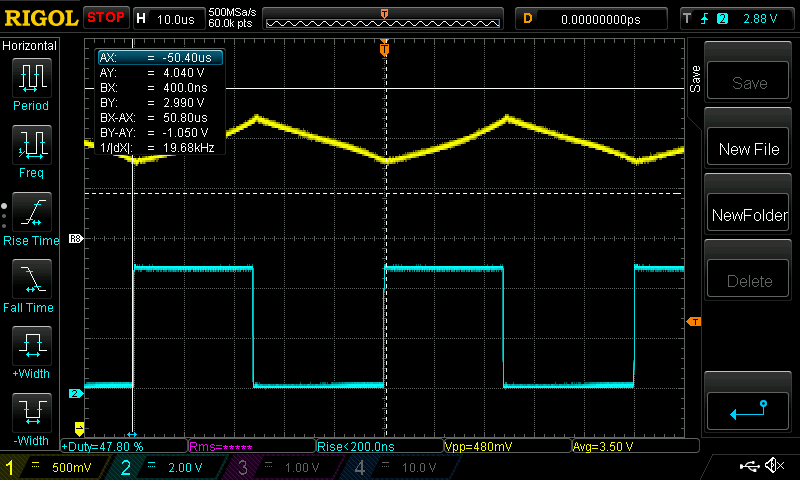

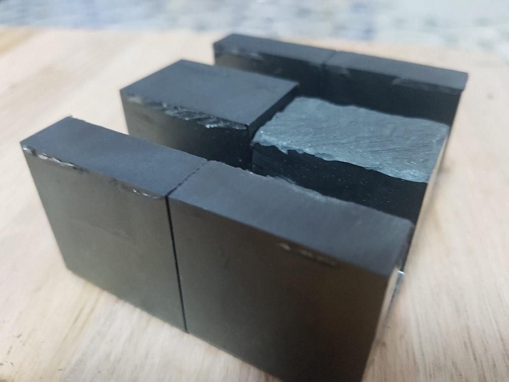

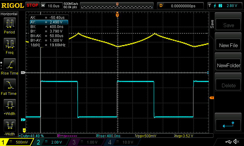

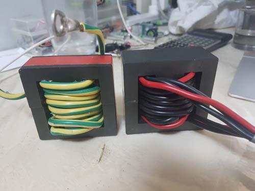

The Inductor:
Earlier I compared one inductor to another.
The big one which saturated with too low current,
(the one on the right)
had I think 5 turns and no gap.
I rebuilt it today with a gap.
Now it's 37uH with 8 turns.
Here is the gap I chiselled with blunt instruments.
In my view the magnetic field in the air gap does not
care very much how good the workmanship is with the cutting
of the gap. There are still remnants of the epoxy on various edges too.
I made a gap of 1.5mm
How does it perform, with 108V input, 2kW out and 20kHz pwm?
Recall this test shows clear signs of saturation with all the combinations
of inductors I have tested so far.
Really well as it happens. This is all I need for the controller.
(from the DSO)
zero current = 2.53V
peak to peak current is 0.42V
average current is 3.4V
with a current sensor giving 0.0202 V/Amp we can see the average current through
the inductor (and through the load too) is
(3.4 - 2.53)/0.0202 = 43 Amps. This is confirmed by the current sensor on the output of the converter board.
The ripple current is 0.42 / 0.202 = 20 Amps.
This is sort of 50% ripple. It might lead to heating up of the output capacitors.
But no saturation. I thought I would eventually arrive at a suitable inductor.
I like how this one can cope with 20kHz pwm.
Even though I test to 2kW and the design output power is 45A at 57V which is
2565W I think this will be good enough. I doubt many of us will have
a battery sucking 45A at this absorb voltage for hours on end, assuming a 48V lead acid bank.
And here it is at 2450W
this is good.
I will do the same thing with the RS components ferrite core pairs that are available
and are quite affordable (RS Stock No.647-9367) when they ever arrive.
First test with zero gap, then with 1mm, then with probable end choice of 1.5mm
After 5 minutes at 2kW, the output caps are still cold. So 20Amp ripple is no problem.
Edited 2020-05-31 18:13 by poida

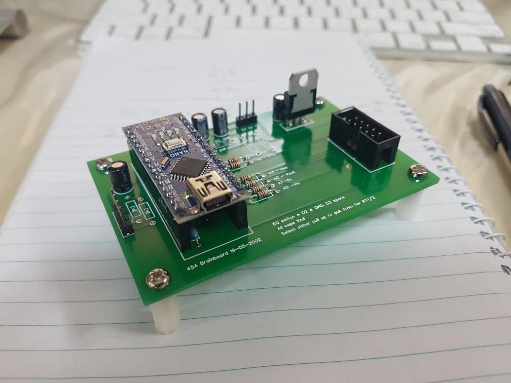

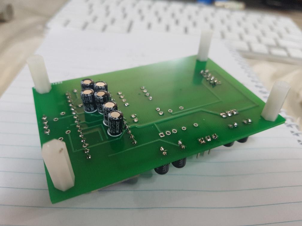

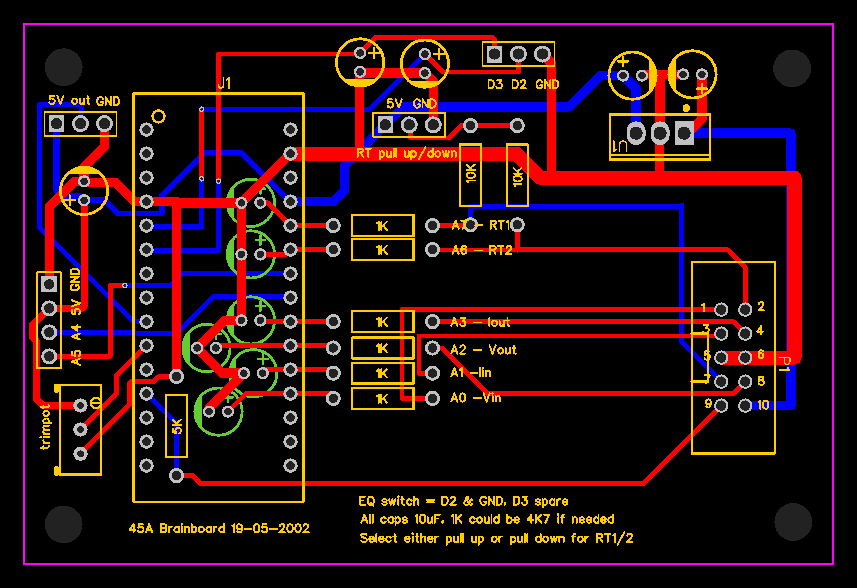

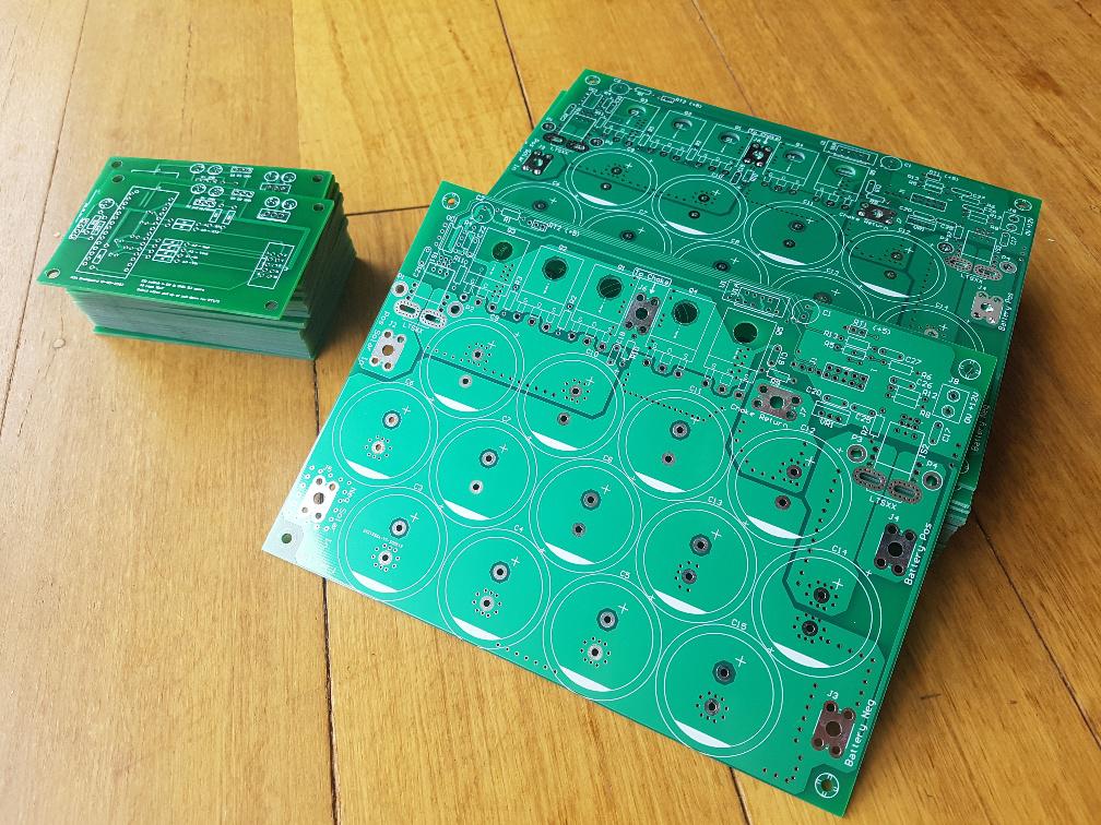

After discovering the need for over current protection, I thought it best to review the brainboard.
I have 25 boards coming from JCLPCB soon but I think I will order another 25 of
these, to replace them:
which have provision for a multi turn trimpot to set the max current and a 3 pin header
for the current sensor. This later board design will avoid needing a small
hack that has a trimpot, some leads hand soldered to the nano and what-not.
The current sensor will need be be something capable of 100 Amps or more.
Allegro make some that do that. I am using a LEM LTS 16 with a shunt.
(this is the sensor that I used in prior DSO captures, with it's 0.0202V/Amp sensitivity.)
I think that all we need is to have a current sensor on one of the inductor leads,
with 3 wires coming back to the brainboard, to the 3 pin header.
So if I get these boards, it will be another 2 - 3 weeks before I send out power and brain boards to those who want them. I want to combine postage and send out both a brainboard and power board as a unit.
Edited 2020-06-01 20:31 by poida

Poida what I sometimes do is fill the empty space on the pcb with via's (exposed copper) so I could add some stuff later on. Like an experimentation pcb.
wiseguy

Good point Nicks, I often do that too, & Peter dont forget that small via holes can add extra cost - the ones on the PCB shown look like a pretty small drill, they should be around 0.5mm (or whatever minimum hole the pcb manufacturer can do before adding cost).  & remember to keep the PCB dimensions within 100 x 100mm

BTW the date is wrong on the Brainboard Peter.
Should be 2020 NOT 2002.
Allan

When testing inductors on the bench with the pulse tester, I can determine the inductance from recording the change in current, the pulse time and the supply voltage and using L = V x s / A
s = time, A is Amps, V is volts
All things being equal, the inductance needed for a change to 100 Hz from 20kHz would be 200 times bigger. We would need a massive inductor.
I have ended up with an inductor choice of the above core or something similar, with a 1.5mm air gap, 8 turns. With the 50% duty cycle, 100V and 20kHz I find it can handle 3000W without taking peak current levels beyond about 70A.
Yellow is the current sensor, with 0.5V/div and 0.0202V/Amp
Blue is pwm. We can see the current increase when the DC supply is switched through
the inductor. Then the switch opens and current now drops.
The cursor line is at 1.3V from the 2.5V zero output of the sensor.
This is 64 Amps at the peak.
The low point of the current waveform is at 3.35V, that is 40A.
So the current grows 24A over the 24uSec period.
With much longer switch ON periods, the inductor will have to store massive amounts of energy. 100Hz is not feasible.

The boards have arrived today. I ordered them 15th May.
This is 12 days or so turnaround.
Last night I ordered 25 of the version 2 brainboards with the added trimpot and 3 pin header for the over current sense.
There are choices to be made I suppose.
I post you the boards, including version 1 brainboards now.
And post again v.2 brainboards later.
You end up paying 2x postage.
or
I wait and post both brainboard versions with the power boards.
so that's 1x postage.

I built a brainboard and it runs Nick's power board really well.
It's much nicer to not have wires and crap everywhere now.
The sensed inputs (Vin,Iin, Vout,Iout etc) are clean and the closed loop
control runs smoothly. Important this, it depends on a clean input.
(I can get a DSO probe on pwm output too!)
I did not fit the 2K2 resistors for I2C since they are not needed any more.
Also, no pullup/down for the NTC since I have not connected them to the power
board yet.
I used 1K resistors for the low pass filter for the 4 inputs
to see how they go. The signals are not too bad at all.
If needed we can use 4K7 or larger to kill more noise.
Pout/10 Pin/10 Vin Vout Iin Iout 200 Setpoint
85.91 86.57 49.12 28.17 17.62 30.50 200 28.20
86.74 86.93 49.12 28.23 17.70 30.72 200 28.20
86.41 86.54 49.12 28.24 17.62 30.60 200 28.20
86.73 87.05 49.12 28.26 17.72 30.69 200 28.21
85.86 86.52 49.12 28.15 17.61 30.50 200 28.20
86.92 87.22 49.12 28.26 17.76 30.76 200 28.21
85.89 86.54 49.12 28.17 17.62 30.49 200 28.20
86.56 86.79 49.14 28.17 17.66 30.73 200 28.20
86.79 86.93 49.12 28.22 17.70 30.75 200 28.20
86.31 86.55 49.12 28.17 17.62 30.64 200 28.21
85.87 86.54 49.12 28.17 17.62 30.48 200 28.20
86.52 86.53 49.12 28.26 17.61 30.61 200 28.20
86.14 86.55 49.12 28.18 17.62 30.57 200 28.20
86.56 86.77 49.12 28.26 17.67 30.63 200 28.21
85.87 86.50 49.12 28.17 17.61 30.48 200 28.21
86.86 87.22 49.12 28.24 17.76 30.76 200 28.20
86.34 86.65 49.12 28.16 17.64 30.66 200 28.20
86.82 87.09 49.12 28.23 17.73 30.75 200 28.21
The 17.6 column is Iin, not a lot of noise.
30.7 is Iout and there is a bit more. This of course could well
be due to relatively bad PCB trace routing for this signal.
Vin is 49.12, steady as.
28.23 column is Vout, again a bit noisy due to the long run past
the switching node.
Mike's PCB addresses this issue and has a good many detail improvements
and I expect clean signals for all 4 inputs.
I could run the house on this thing already.
