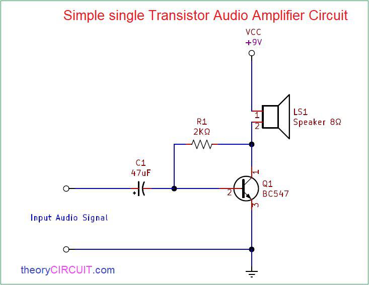

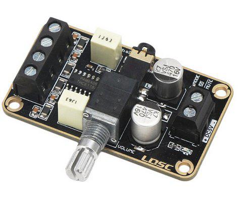

I hooked up one of these amplifiers to the F4 DAC pins (through 4K7 series resistors), ran PLAY WAV "shuffle.wav", and got good sound on my earphones.
But it would reset the F4 when powered on, and when the volume was powered up more than about a third (which was plenty loud on the earphones). (5V power came from the F4.)
Can someone recommend a less power-hungry amplifier (and perhaps one with a smaller footprint).
And is there a smallish circuit which could go on a PCB to achieve the necessary amplification?
Perhaps like this, twice, with a 5V supply instead of 9V? How would one adjust the volume?
Edited 2021-02-27 10:11 by lizby
Posts: 6254
Posted: 07:36am 27 Feb 2021
Hi Lizby,
I used this:
headphone out
For 32 ohm headphones should be okay. Duplicate with input PA5 if stereo is needed.
This is NOT for hifi. Especially noise reduction from the 5V line is little. If you have a backlight PWM at low frequency you can hear it in the speaker. For my tetris game this is not a problem, it gives a nostalgic feeling (try picking up an old game boy).
You can improve by changing 22uF to 100uF (better low frequency) and add some 5V filter (i.e. 10 ohm and 100uf).
Volume control is in MMBasic
Edited 2021-02-27 17:43 by Volhout

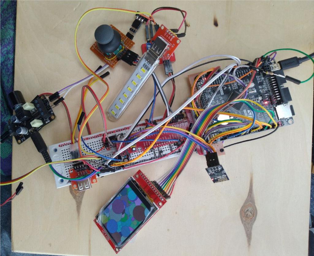

Posts: 3888
Posted: 04:08pm 27 Feb 2021
Here's the Christmas tree I'm working on pending arrival of the backpack PCB for the F4:
The red part plugged in at the right of the breadboard is a breakout for a 40-pin cable from the pi-type header (as on the CMM2). I've checked the pins and functions for many components.
I will later be designing an "Experimenter's" breakout board for the 40-pin header that will allow many of the "37-sensor" kit parts to be plugged in, as well as servos and other toys.
