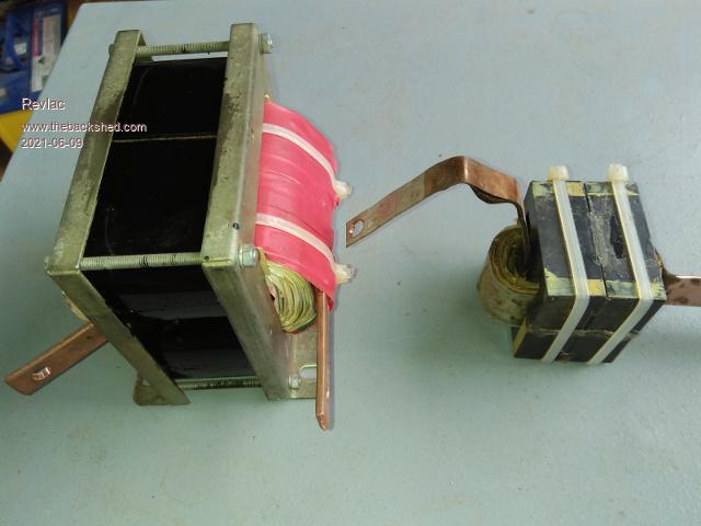

Murph, Using copper strip for a large choke is fairly standard, seen many of the done 1mm X 100mm wide with ends for the lugs to bolt on to, the last one I did was with aluminium, was quite easy once worked out, 1mm thick aluminium and a total of 70mm wide 3.1m long and 13 turns.
Have a photo somewhere.
Found it.
However If I look around I might find some enameled wire of suitable size and try your method.

Posted: 11:26pm 09 Jun 2021
Its an excellent method if you can arrange it so the number of turns required fits exactly into one layer, and that often works out perfectly.
The copper foil/strip way works very well too, but it needs to be thin and flexible.
Its also possible to wind on several thin foils together without insulation between. That way, you keep the flexibility but can have a pretty thick layer per turn. Beware of shorted turns at the edges, the foil layer needs to be kept considerably narrower than the insulation layer between turns.

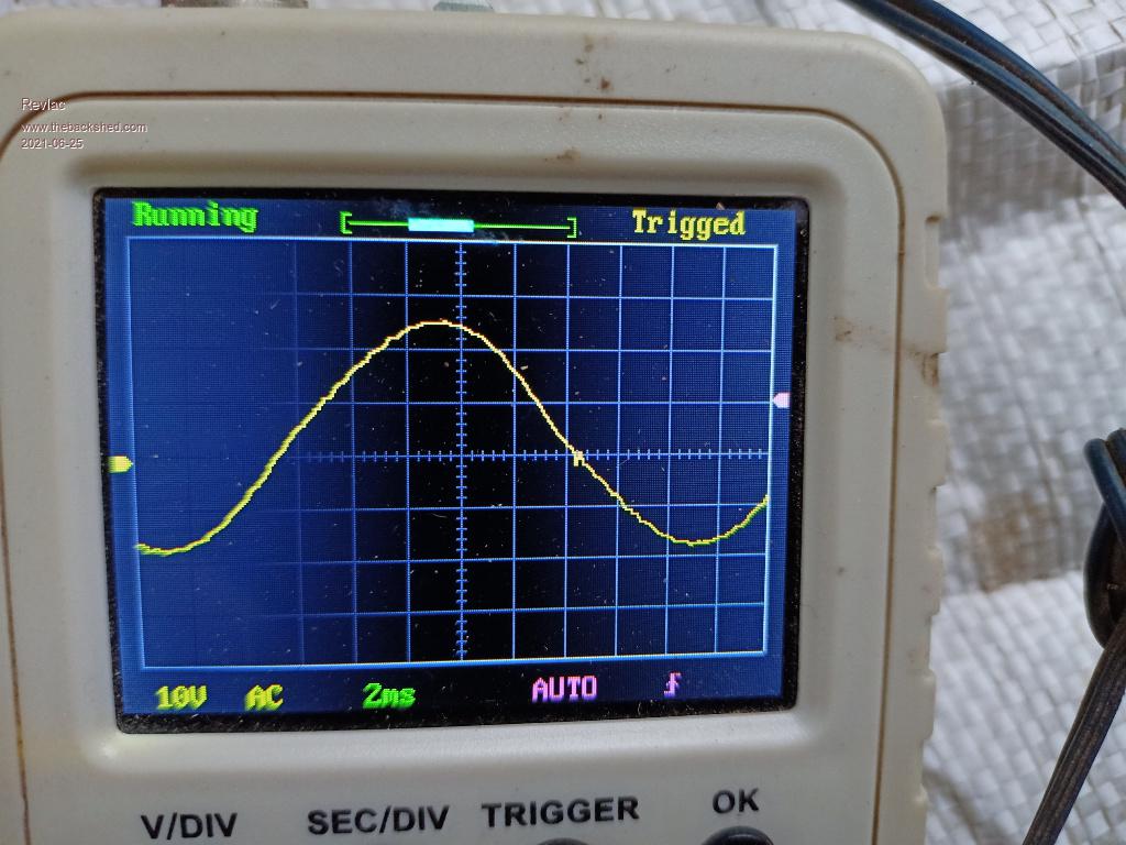

Posted: 11:44am 25 Jun 2021

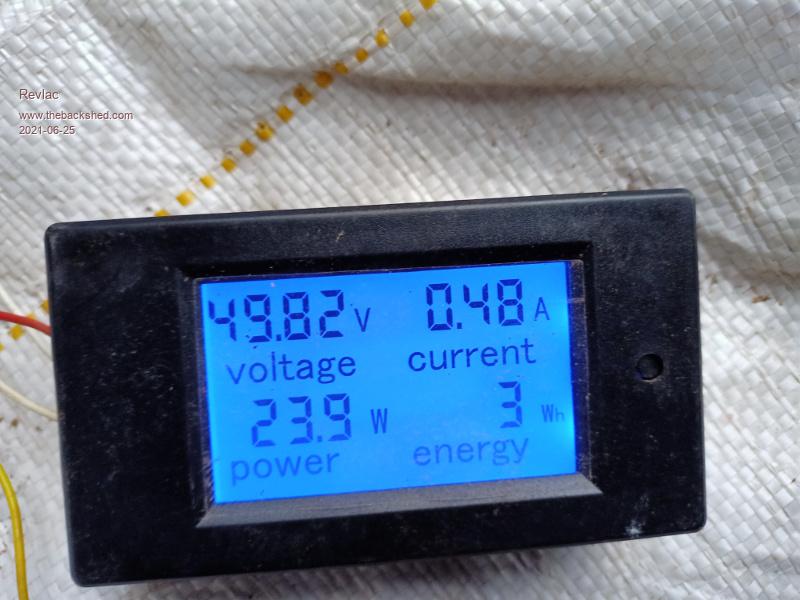

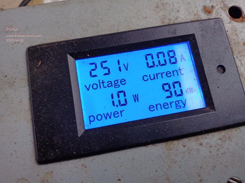

Did a test run the other day, unwound one turn on the transformer primary and placed some shim materiel in side the choke (runs silent), 1 fet per leg, no capacitors and a large series resistor in case of you know what...   this was its first test run and it fired up ok.
Found some issues, not unexpected, had some serious over voltage on the output, easy fix just changed the value of the feedback resistor.
the other problem was one of the DSB temperature sensor's was not working, I know it was working before Took a photo of it, turns out to be a bad solder joint just below the 3 pin connector on the pcb, easy fix.
Second test run, much better but the voltage is still a bit high and run out of adjustment, output is 250vac..
will change to a lower value resistor, the little transformer is 13vac at 240v last I checked
The toroidal transformer has some buzz sound to it but not bad.
The power consummation is just on 24w, thats about what I was expecting at this stage, it might change a little when its all completed.
Now there is a little kick in the sinewave at zero crossing on the scope, we can do better, I fairly sure this can be fixed with a bit better choke.
Anyway I have to change that resistor and try again, overall its looking pretty good.

Posted: 10:17pm 25 Jun 2021
Excellent progress Aaron.

Thinking about it, that little kink in the waveform (if its still there) might be caused by primary to secondary capacitance in your transformer.
Anyhow, its nothing to be too concerned about.
The off grid waveform here looks like crap, typically around 5% measured distortion and everything still works perfectly well off that.

The little kink is still there, The capacitance between the primary and secondary winding, could that be caused by the gap on the outside between the primary and secondary winding?
Or something else.
We might experiment a little later to see if anything changes.
I agree, most of the inverter waveforms look better than generators that I have seen, I would like to see what some of the Stamford generators look like, when I get one going.

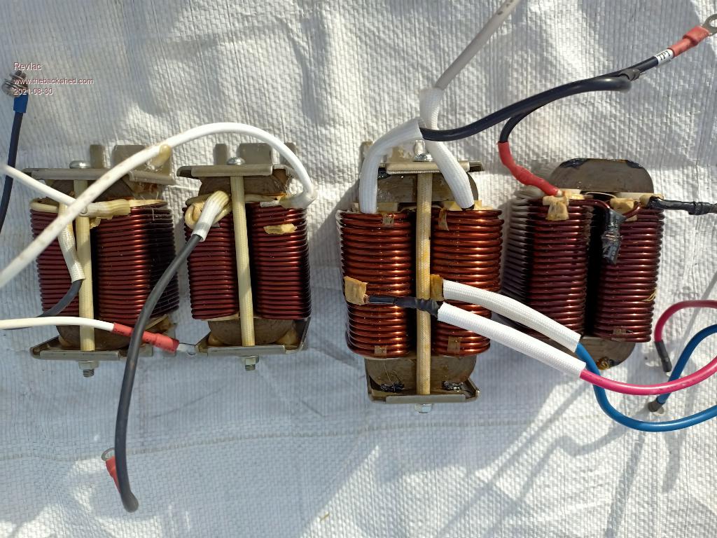

Thanks Bruce, for dropping these chokes in the other day, will see if we can make something work from them.
2 small chokes and 2 larger one's, the larger type appear to be about the same as we would used for these home built inverters.
The wire on the Big chokes is 3 mm diameter, the choke on the far right looks interesting, the winding is joined in the centre as expected, now that could be cut and run them parallel, that would be 2 in hand 44 turns (Roughly), at the opposite end we could cut the winding in half again, that could be paralleled and give us 4 in hand of 22 turns, all 3mm wire.
I tried to test with a meter and it was around 400uh, but as no wires were cut the readings could be way off, But one like this might be suitable for a Mppt charger if done this way.

Aaron, these are the choke types I re wound for my inverters. If you are unfamiliar with them, heat the nut first before unscrewing, this lets you re use the bolts with a healthy thread.
Hold the choke in a gloved hand and hit the  U core sticking out on one side with a soft hammer. After a few hits the core half slides out and you can push out the other.
Note the two halves have white paint marks so you can assemble them the same way oriented later.
I have re used the wire, its a bit of a job to straighten it though.
Best to glue the halves from two original chokes together so they form a matching
W and M, this gives you a bigger diameter coil for re winding.

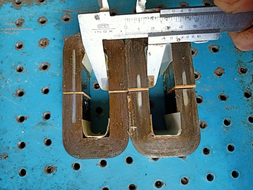

These were stuck together quite well, Got an empty 4l paint tin and put the 2 chokes in that with a small amount of thinners, left it to do it's thing over night.
This softened up all enamel and other stuff and made it much easier to take apart, the wire looks ok so far.
These are not exactly the same, but should still do the job, one is 45mm strip width, the other is 40mm strip with, will just put a little ship each side.
In case anyone wants to know what size the spacer is between the core halves, its about 1mm to 1.1mm, calipers are old and a little worn.

Posted: 08:49am 03 Sep 2021
Those look like the exact same cores Mark used in his choke.
As I remember, the slots were 20mm wide and 70mm long, and his gap was also 1.1mm
Mark fitted 12 turns of 20mm ^square wire (10mm outside diameter) and ended up with about 170uH and a saturation current of around 130 amps.

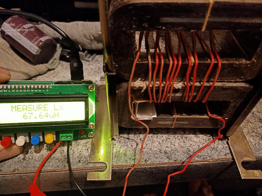

Used to some scrap wire to test with, at first the tester reads 77uH, left it sit for a minuet and it settled to 67uH at 429372Hz, This is with 10 turns.
The reason For 10 turns, this 3mm wire with 10 turns 2 in hand would be about 60mm and the window height of 70mm would give some wriggle room for the not so straight wire.
Should get 3 or 4 layers this way, This is the first option so far, that works with the wire on hand.

Posted: 08:18am 05 Sep 2021
One pair of cores looks to have a slightly larger air gap than the other ?
Two extra turns will make a huge difference, its turns squared, so going from ten to twelve turns increases the inductance x1.44  maybe to 97.4uH
