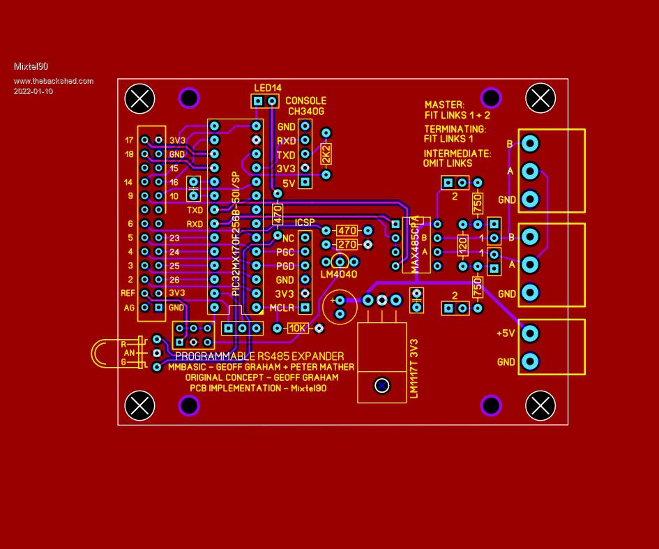

  Tinine said  Do you see a weakness?
No, not at all with the protocol Just the checksum, my SCADA background would always have me use a CRC. A checksum is just not secure enough (for me).
You say that you have never had a checksum error so I presume that you have an ACK/NAK response from the slave if it detects a checksum error or not? On receipt of a NAK the master would re-send the message and count the number of re-tries? A checksum will not catch as many errors as a CRC, it's possible that you could have had errors without knowing it.
@Mixtel90, regarding the DE signal, it's easy enough to generate your own and not use the one provided and invert it but that will rob you of an I/O pin of course.
I think your automatic DE circuit is a copy of those used in commercial boards. I always thought a weakness of those is that the transmit signal has more propagation delay than the DE signal and it would be better to use the 'spare' gates in the receive signal path to further delay the transmit signal. Alternately, one trick I use to use was to insert a (say) 1meg resistor in series with an input, which forms an RC network with the gate's input capacitance and will cause a delay in the signal. Just thinking that the first bit in the transmit may be truncated, not by much I admit.
Rather than use the DB9 connector for the RS485 signal I would use the more conventional screw terminals (and no 5v). That means you have to take the lid from the box to connect it but...

The discussion about DB9 / screw terminals is more a discussion about what the board is used for. If this is a (remote) expansion unit for a PC, the DB9 is fine.
If it is one of multiple modules (how do you set the Modbus address ?) in a system DB9 is not easy to assemble. Each connector needs 2 wires in one pin, and 2 cables through the strain relief. Then screw terminals would be much easier.
If you would add optical isolation you could avoid ground loops, but depending on how you engineer the digital IO and especially the 2 analog channels, that may not be needed.
The timing of your DE generation circuit must be "tuned" to the envisioned baudrate, otherwise you end up with missing data with a low /silent time/dead time/turn around time/ modbus master.
I would always use the DE pin of the MX170 to avoid that. Rather loose 1 pin on the micro than having to debug this kind of problems in a system that works 99% of the time.
And this is recent.. I've done it Mixtels way, the customer ran the modbus test suite and came back with the exact error with low turn around time masters, and I had to change the design.

Here's a 16 IO version using hardware DE and pluggable terminals. There's space for a data loopthrough now, but not for the 5V. Of course, you aren't supposed to do multidrop usung loopthrough terminals as unplugging one node kills everything after it. :) These terminals make it easy to connect/disconnect as the actual terminal is outside the box. Note that the pins are 1mm sq and on 5mm centres so fixed terminals might also fit the board.
I don't like not having 5V on the same connector, but my usual supplier doesn't stock 4-pin horizontal sockets. It would work well with 2-pair cable with no screen needed. 3-pin really needs single-pair screened and you still need to provide external power.
I'm not bothered about the firmware for MODBUS - I won't be writing it. :)  I have had a bit of a read up on CRC generation and checking though and it looks a right pain in the backside, even if you've finally decided on which of the 500 incompatible versions you prefer. One of those things that was originally designed to be done in hardware, not software.
The MODBUS address has to be set in firmware and written in sharpie on the box. :)  Use a
CONST THIS_IS_MY_MODBUS_ADDRESS_AT_THE_MOMENT = n
at the beginning to make it easy to change.
EDIT:
OOPS! DE should either be inverted (add a transistor) or have a pull-down resistor if it's being handled in software.
Edited 2022-01-10 18:41 by Mixtel90

@Mixtel90
Not entirely sure but I think you are using the DE pin for DE while this is inverted I think that is not a problem because it it is not specified in the comspec then it can be toggled in the software.
I'm happy to have one A/B/E connector because a slave in the middle of a daisy chain can be removed without breaking the circuit for those further on. I expect that depends on how you connect them up.

I've done another pcb move round of the RS485 version.
Terminals are a 2-pole for 5V & GND and 3-pole for A, B & GND. It should be possible to fit either fixed or pluggable terminals. Looping through the pluggable terminals would allow disconnection without breaking the chain. Alternatively a lead to a DB9 plug could plug into a loop-connected terminal box & power supply.
I've also rearranged the terminating resistor links so they are accessible externally if required or can be kept internal.
I've had a thought on the MODBUS address and come up with this: Initially all devices have the same address. To commission, connect a single unit and write a value (the address) to a dummy analogue port. The firmware should recognise this port and store the value in an address register. On power up it should compare the address register with the default value and, if it is different, use the register as the address. It could also be written so that the IO won't work when using the default address, so devices have to be commissioned before they can work. I'm not sure how you could reset a commissioned device to it's default address if you didn't know it's address. That would probably have to be done via the console.
