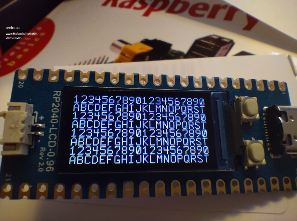

Looking at the schematic you need:
SYSTEM SPI GP10, GP11, GP12
LCDPANEL ST7735S, L, GP8, GP12, GP9, GP25
so it all fits nicely in 8-9-10-11-12-25.
All these are hard-wired. The final pin (backlight) on the display is normally optional but, in this case, it's hard-wired to the backlight. You could, of course, not define it and have the backlight flashing on and off using Heartbeat. :)
You could still use the system SPI pins for other SPI devices (not an audio DAC), such as a SD card. You'd need to allocate a CS pin for anything you use.
The two buttons are hard-wired and can't be used for anything else.
The 2-pin battery connector feeds VSYS via a Schottky diode.
It looks to me like a standard Pico, apart from the above pins.

It is not possible to use GP12 within LCDPANEL as RST - PicoMite complains that Pin GP12 is already used within System SPI. That was the reason I tried GP0
This costs me hours and finally, before giving up, I tried GP0 in that place.
Without any settings on standard text output I count 20 chars by 8 lines on the display.
-andreas

Ah... you are quite right. There is a clash there. You could use something like
OPTION SPI GP10, GP11, GP28
or use any other SP2 RX (MISO) pin as the Pico is very flexible. You should really leave RST on GP12. That leaves it possible to hang other devices on system SPI.

I did reset the options and tried it, but PicoMite refuses that:
> option list
PicoMite MMBasic Version 5.07.07
> option SPI GP10,GP11,GP28
Error : Invalid Option
bug or feature?
-andreas
Posts: 9194
Posted: 07:41am 06 Jun 2023
I think this should do it:
OPTION SYSTEM SPI DISABLE 'get rid of the old settings
SETPIN GP28 OFF  'just in case this pin has been set as analogue input by default
OPTION SYSTEM SPI GP10, GP11, GP28
andreas
Joined: 07/12/2020
Posts: 226
Posted: 07:59am 06 Jun 2023
  Mixtel90 said  I think this should do it:
Yepp! works!  (SETPIN GP28,OFF comma was missing)
> option list
OPTION SYSTEM SPI GP10,GP11,GP28
OPTION HEARTBEAT OFF
OPTION LCDPANEL ST7735S, LANDSCAPE,GP8,GP12,GP9,GP25
> cls
> backlight 10
> cls rgb(red)
> works!
Thank you Mick!
-andreas

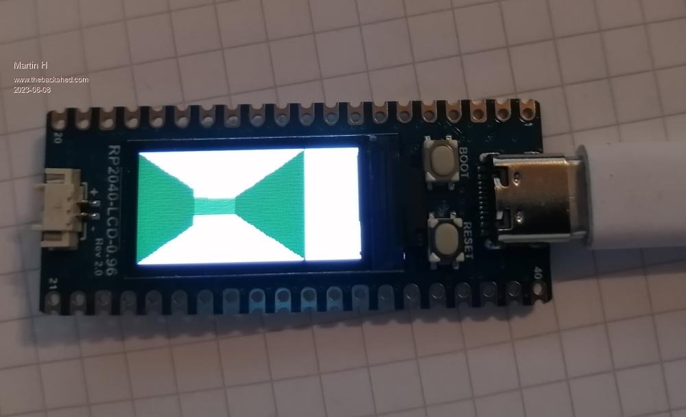

Andreas,
Mine has just been delivered. With the settings you posted it worked immediately.
Thank you
(my old eyes just have trouble reading the small display)

  Mixtel90 said  Will these overclock?
lets try ...
first impression...
option cpuspeed 252000 seems to work as well as option cpuspeed 378000

  Mixtel90 said
Like the mini-maze! :)
for the 160x80 Display

    Else
     'Blocker
      Triangle x1%,y1%,120-x1%,y1%,120-x1%,y2%,WallC2%,WallC2%
      Triangle x1%,y1%,120-x1%,y2%,x1%,y2%,WallC2%,WallC2%
    EndIf
EndIf
End Sub
Sub show_maze
For y% = 0 To MazeH%
  For x% = 0 To MazeW%
      If Maze$(x%,y%)="#" Then Box 122+x%*1.5,3+y%,1,1,,0,0
  Next x%
Next y%
End Sub
' --- 2D Maze generator ---
' algorithmen based on
' https://rosettacode.org/wiki/Maze_generation#BASIC256
Sub generator
Local done%,i%,CurX%,CurY%,OldX%,OldY%,x%,y%
' initial start location
CurX%=Int(Rnd * (MazeW% - 1))
CurY%=Int(Rnd * (MazeH% - 1))
' value must be odd
If CurX% Mod 2=0 Then Inc CurX%
If CurY% Mod 2=0 Then Inc CurY%
Maze$(CurX%, CurY%) = " "
' generate maze
done%=0
Do While done%=0
    For i% = 0 To 99
      OldX%=CurX%
      OldY%=CurY%
      ' move in random direction
      Select Case Int(Rnd*4)
          Case 0
              If CurX%+2<MazeW% Then Inc CurX%,2
          Case 1
              If CurY%+2<MazeH% Then Inc CurY%,2
          Case 2
              If CurX%-2>0 Then Inc CurX%,-2
          Case 3
              If CurY%-2>0 Then Inc CurY%,-2
      End Select
      ' if cell is unvisited then connect it
      If Maze$(CurX%,CurY%)="#" Then
          Maze$(CurX%,CurY%)=" "
          Maze$(Int((CurX%+OldX%)/2),((CurY%+OldY%)/2))=" "
      EndIf
  Next i%
  ' check if all cells are visited
  done%=1
  For x%=1 To MazeW%-1 Step 2
      For y%=1 To MazeH%-1 Step 2
          If Maze$(x%,y%)="#" Then done%=0
      Next y%
  Next x%
End Sub
' --- WallData (160x80)---
Data  0, 0, 0, 80, 5, 3, 5, 76
Data  6, 4, 6, 76, 25, 17, 25, 63
Data  26, 17, 26, 63, 40, 27, 40, 53
Data  41, 27, 41, 53, 50, 33, 50, 46
Data  51, 34, 51, 46, 55, 37, 55, 43
Data  56, 37, 56, 43, 60, 40, 60, 40
"Cursor" to move
"M" Shows the Maze (not so usefull)
'no comment
