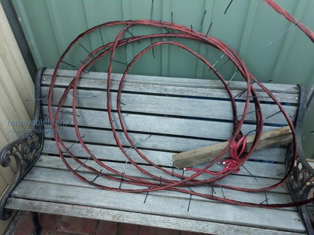

Got the primary wound this afternoon, 35 strands of 2mm2.
Cheers Caveman Mark
Off grid eastern Melb
Madness
Joined: 08/10/2011
Posts: 2498
Posted: 08:40am 08 Mar 2018
If you wind it through the hole with that coil size or little smaller and keep doing that till it is all back in a coil through the hole it is easier to handle. When you do the first turn of the big coil tape the end to the next turn so it keeps threading through on each turn. It pays to pay attention to each corner and get as snug as you can. Also helps to mark out the spacing rather than trying to tidy it after.

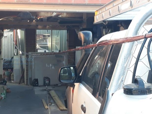

Being involved with a few 4wd recoveries, I can see this is actually quite a dangerous process, there is a fair amount of weight here and it's under tension, if you do this take great care. A couple of "winch rope dampeners" is a good idea.
(the twisting part I meant)Edited by renewableMark 2018-03-09

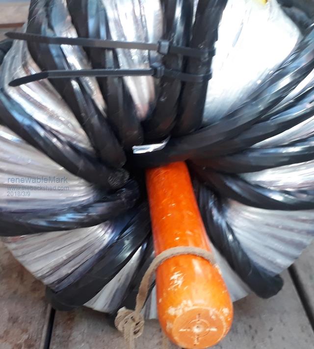

Keep in mind you need to keep the turns in the hole hard against the core or they will have less diametre available. Also it would be a good idea to insulate it, either with heat-shrink of insulation tape before winding it.
renewableMark
Joined: 09/12/2017
Posts: 1679
Posted: 03:39am 09 Mar 2018

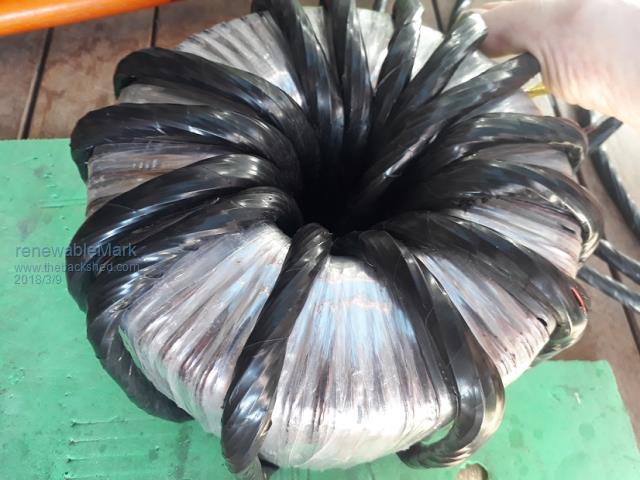

Well it didn't go to plan, when you lever the cable against the inner it seems to flatten it out a bit and takes up more room. Two wires ended up overlapping.
Cheers Caveman Mark
Posted: 04:47am 09 Mar 2018
Overlapping does not matter.
As long as it passes through the hole any way it can get through, it counts as one more turn.
As long as one bunch of wires does not short to the next bunch next to it, you are winning.
I see 13 turns there if my eyes are not deceiving me.
One more to go and you can treat yourself to a beer.
*Edit*
If you can fit one extra additional 15th turn in there at this stage do it, overlap does not matter.
You can always remove that extra turn later on, after some testing.
That is always a lot easier than trying to figure out how to add an extra turn after you have cut and stripped your wires to final length.
Give yourself the option of having that extra turn already on there to remove.........Edited by Warpspeed 2018-03-10

Not sure if it is the angle of the camera but it looks like you spacing around the outside is uneven electrically that does not matter but it has effect of the wire position it the hole.
Looks like you have 13 turns through the hole, I used a couple tyre levers to squeeze out a gap to get the last turn or 2 in.

Posted: 05:59am 09 Mar 2018
Yep,that’s fine ,Mark.
Overlapping was my concern also ,many yers back when I wound my Torodial.
Makes no difference,apparently.
I left an extra turn or two on for the testing ,until I was happy with the final voltage.
Looks like you are doing everything correct ,so a pat on the back ,you deserve another beer..

No reason to use tyre levers or any force.
Fourteen (or fifteen) turns through the hole is the only requirement when you are working near the middle.
Even spacing is only a aesthetic thing, and you can fiddle that when you have all the turns on.

It is a hell of a lot easier to mount the thing if you can get all the wires against the core and it does not take make much create the space needed.
Posted: 06:09am 09 Mar 2018
Bruce, we posted simultaneously.
Its always best to plan your secondary for full windings with minimal gap or overlap, because these windings are very close to the core.
When you are working much closer to the middle of the hole, as you will be with a huge monster primary, the effect of bunching the turns unevenly becomes unavoidable, and it really has no effect anyway.
Mark, what you have will be fine and will work wonderfully well.
Time for a beer.
Posted: 06:13am 09 Mar 2018
Yes, its a physical mounting and aesthetic thing only.
But a lumpy primary will work perfectly well.
Much better to have a few humps and bumps than try forcing it and fatally damaging the insulation between the turns.

Just seem to run out of room, the end will sit pretty flat for mounting so no big deal I suppose.
Cheers Caveman Mark
Posted: 06:38am 09 Mar 2018
That is fine Mark.
By the time you have fitted a "top hat" and a bloody big through bolt, and fudged the outer windings for even spacing (for looks only) it will be a perfectly functioning masterpiece.
