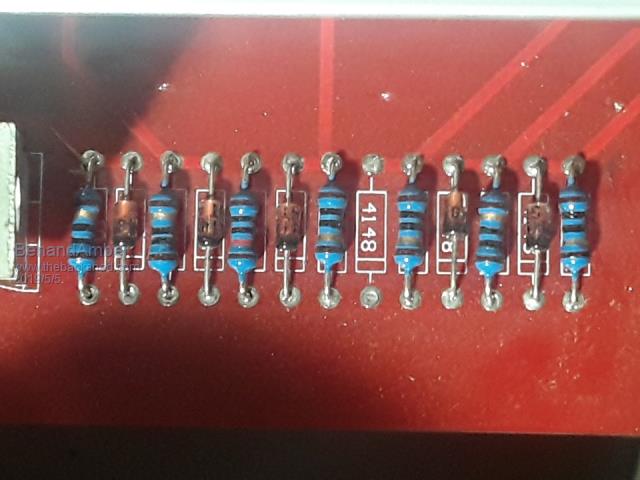

I was trying to wrap my head around how the totem pole drivers work and saw this
Can u see it
If so any suggestions
I'm not exactly sure what part number it is
I think I've read somewhere that diodes have different voltage drop across them
I don't know how it would affect it if I put the wrong one in thereEdited by BenandAmber 2019-05-06

Ben, is that your board with the missing part?
If so pick up a 1N4148 and solder it in.

Yes it's my 10000 watt board it was missing from the factory and I just caught it

Renewablemark thanks I really appreciate you telling me what I needed
Without you guys I wouldn't have been able to do none of this I can't thank you enough
I ordered 30 of them today from digi-key they only cost a dollar eighty but by the time I paid shipping it was over $11 bucksEdited by BenandAmber 2019-05-07

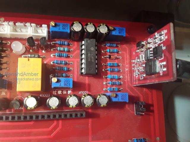

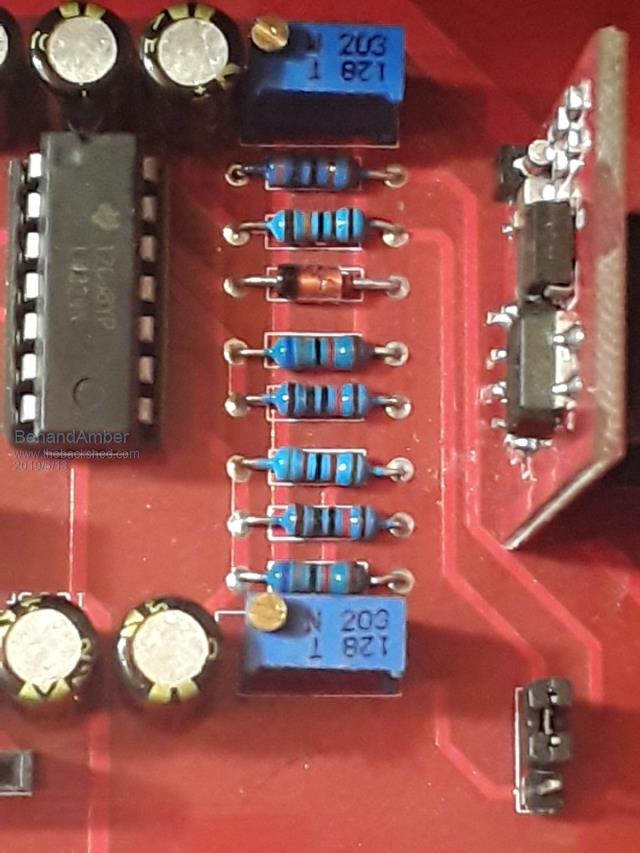

There is a little black jumper bottom right-hand side
Does anyone know what this jumper is for
I think it is for changing the voltage of the board
not sure which way the jumper should be for a 48 volt

I got a hold of the people that I bought the board off of
they said it was for Factory testing
I need not worry about it
I don't believe it but that's what they said
