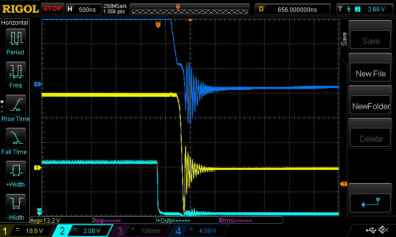

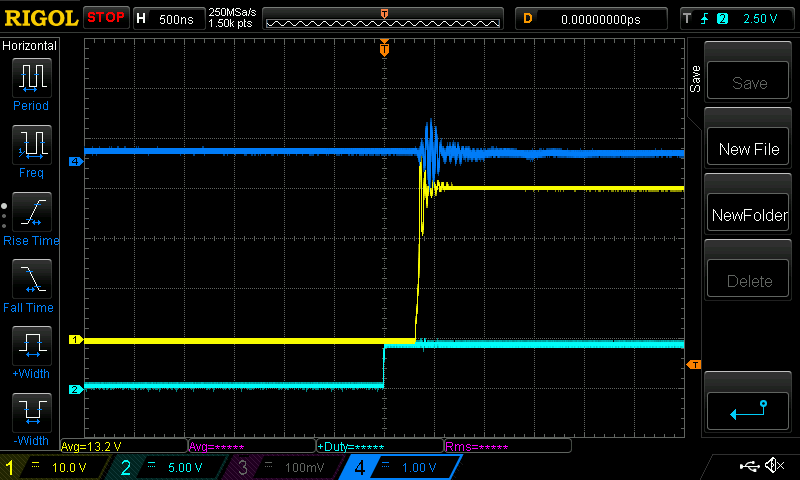

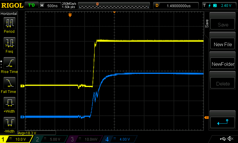

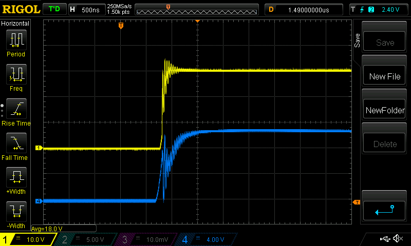

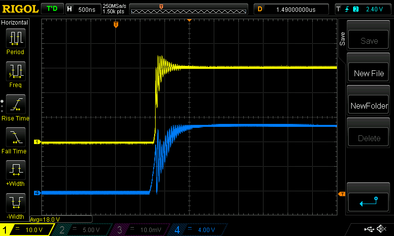

I have found a nice solution for surpression of oscillation.
All tests with 5A output at 15V, 30V in.
Dark Blue is gate drive for the switch, Yellow is voltage at the
I tried a large bead on the MOSFET switch drain, nothing on diode.
no bead on the switch, nothing on the diode.
no bead on switch and a synchronous rectifier instead of diode.
no bead on switch, a small bead on cathode of diode
(as suggested by Wiseguy. Mike, please check if this is so?)
It seems to help a bit...
finally, no bead on switch, a small bead on the diode ANODE or source pin.
This last configuration is the best I have seen so far. How will it go when the current levels are 10x ? That is the question now.
I tried a synchronous rectifier with the bead on the (now) MOSFET source pin
and it looks nearly as good.
Efficiency:
no bead 92.9%
bead on anode 92.3%
sync rect plus source bead 94.3%
nickskethisniks:
the small bead is again of unknown provenience. LCR meter at 10kHz with short thick copper wire as in last photo has it at 0.67uH - 0.42uH (offset of the test leads)
5 small beads on the wire take it to 1.72uH - 0.42 offset or about 0.26uH
And with this I find it now Beer O'Clock.

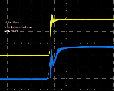

Interesting displays there Poida

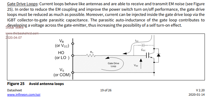

One has to ask, is it the drain oscillations feeding back into the gate via miller capacitance or the gate parasitic's causing oscillation and thus affecting the drain output.
You could measure that nice high freq oscillation and use an RC snubber from the formula in that PDF article to dampen it out.
Or see if the gate is causing it by increasing the gate drive resistance by several ohms, I would start at say 2r and increase to 10r in 1r steps, see what happens, if not much change place your bead on the gate drive mosfet pin; and make sure your scope probe earth lead is replaced by a short length of copper wire, its easy to get misleading measurements.

Here is a dia. of how the drain capacitance affects the gate drive, IGBT shown, but same for Mosfet.
keep the driver 21844 output to 10mm of your mosfet if possible, this reflects a lower impedance across the gate/source and helps prevent the gate voltage rising to turn on levels during any oscillation; Prob not possible without a final pcb design.

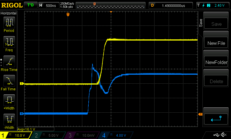

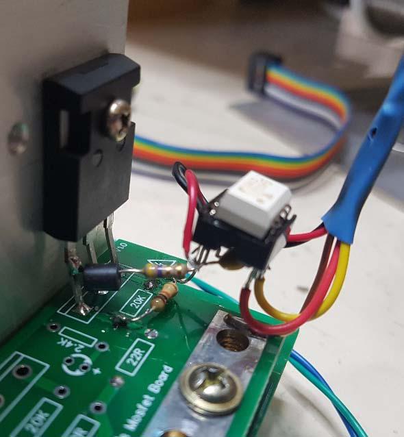

Posted: 01:38am 10 Apr 2020

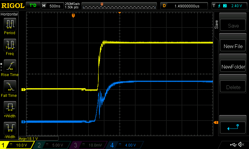

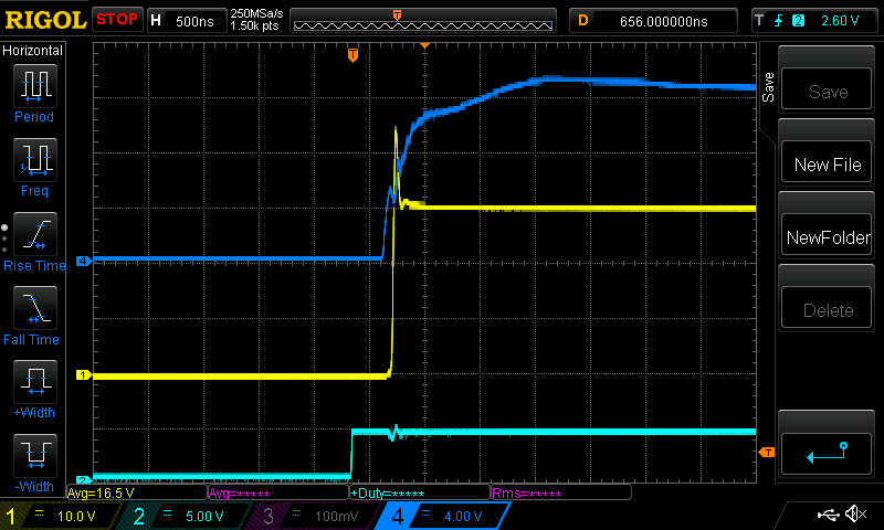

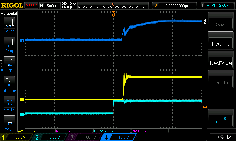

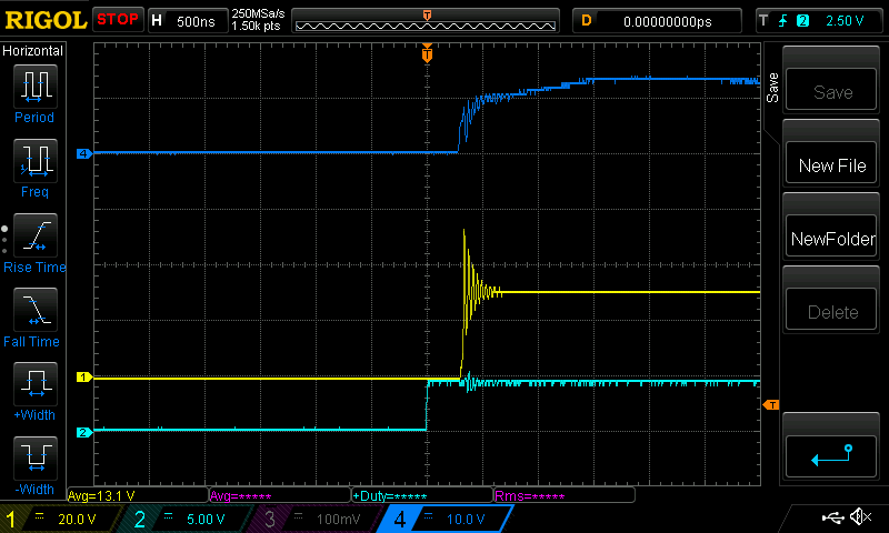

Solar Mike:

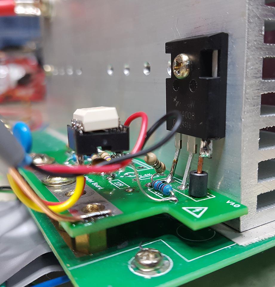

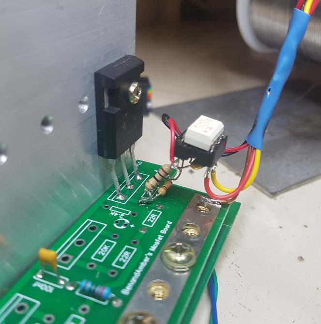

I have made a very tight gate drive loop as shown above.
Here is my attempt. There is a 10K gate to source pull-down and a 10R gate drive resistor.
I use the TLP 250 instead, this is what is required on the PCB.

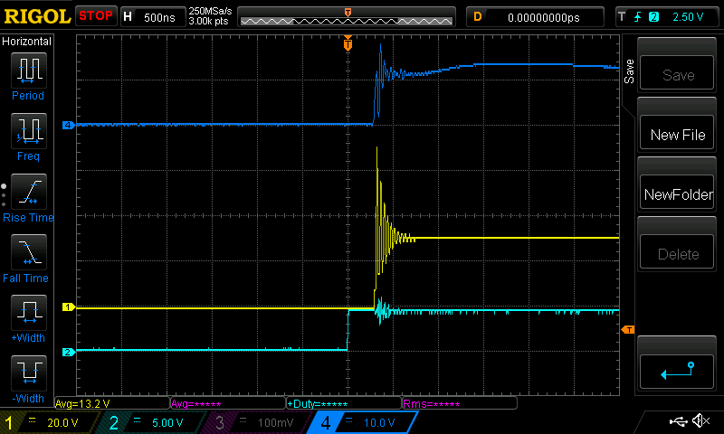

I show gate voltage, switch/inductor node and pwm logic drive
in Dark Blue, Yellow and Light Blue respectively.
Tests were done with zero gate resistance, 4.7R, 10R and the DSO captures are at about 5A output. The rectifier is a MOSFET with gate tied to source via a link.
No ferrite beads in the first 3.
Zero gate resistance:
4.7R
10R
Not real good looking situation, just less of the bad thing. With zero gate R
we see voltages in the order of 70V. This voltage also is across the diode.
Now I tried the MOSFET diode with the small bead on the source pin with 10R gate R.
Excellent. The gate of that MOSFET is pulled down with a 20K not a copper link and it permits the MOSFET's diode behavior to be rather softer/slower in it's commutation.
The combination of both appears to work well here.
But there is oscillation still and it's at the other end of the switch event, when
it opens. I wonder how we can reduce this?
Maybe a bead on one of the pins of the switch? Drain pin is my guess.

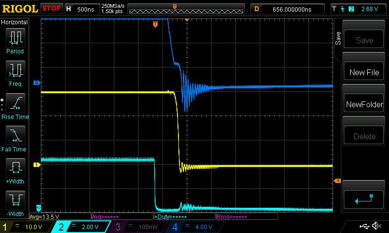

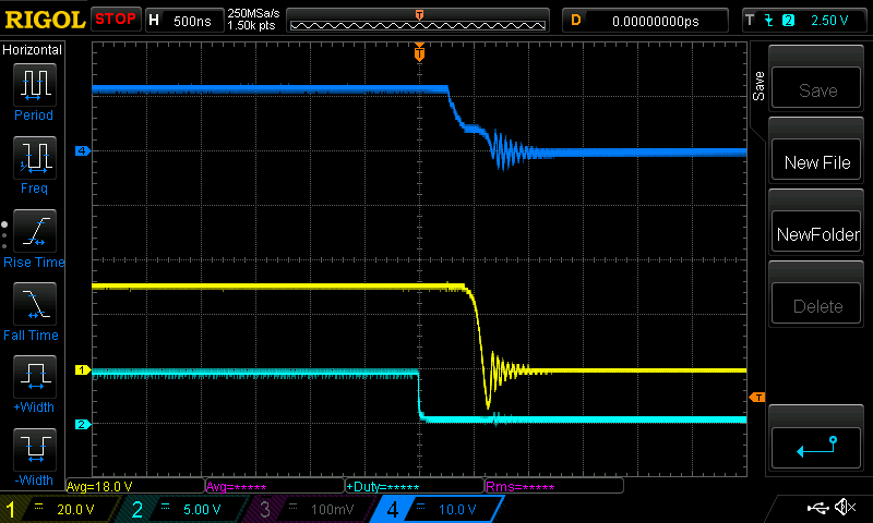

poida
Joined: 02/02/2017
Posts: 1515
Posted: 02:10am 10 Apr 2020

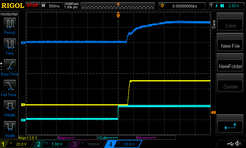

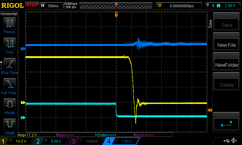

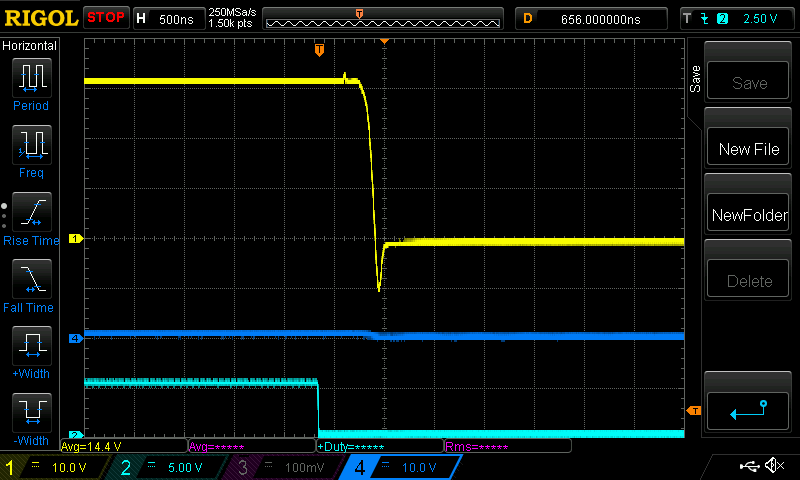

Ok, I put a short across the 20K gate pull down and this is a surprise for me.
Using the MOSFET diode with a bead on the source pin. (i.e. the best result)
First is the switch ON event, as with the previous post.
The oscillations are back.
and the switch OFF event:
These oscillations are gone!
So we can have one or the other sorted out but not both.
I now revert to the 20K gate pull down resistor.
This gives me some clues. Clearly I need a few.

What is consistent is the frequency of the observed ringing, this relates to the wire trace lengths in your circuit. This could be dampened by an RC connected across the rectifier diode to 0v.
As you have measured, the amplitude of these are dependent on the speed of the active switching devices, a larger gate resistor 10r slows down the transition and ringing amplitude reduces, however at larger output currents this may be less efficient.
1: I would try the 4.7r gate resistor with a bead over the mosfets gate lead, to dampen that HF oscillation.
2: Under the TLP250 add a 10uf electrolytic parallel with your ceramic cap.
3: Unsolder one end of the gate resistor from the pcb and connect it directly at the mosfet pin, near the case to lessen the inductance path.
4: Also try a 1 amp schottky diode parallel with the 4.7r, anode end towards the mosfet, this will allow a lower impedance path at turn off.

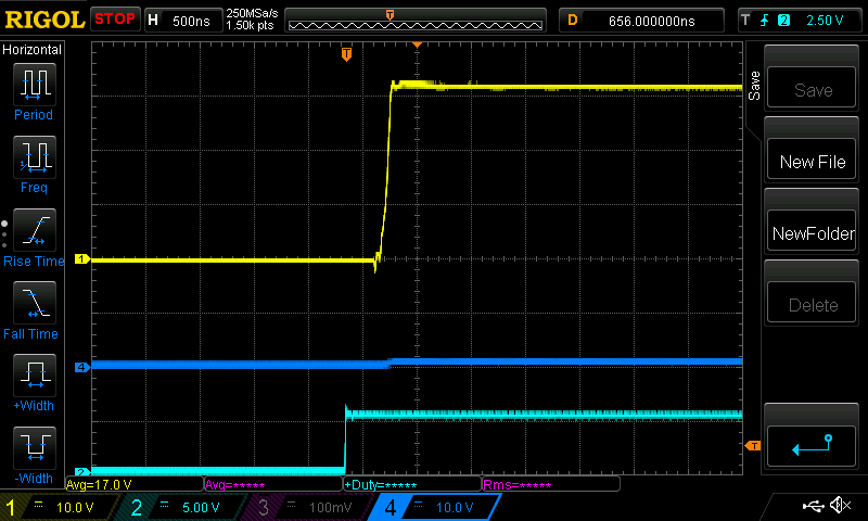

I tried most of your suggestions above. I replaced the 10R with 4R7 gate resistor and put a bead on it. I could not be bothered with a 10uF cap. Let's see if it's gate drive related...
Usual test condition, including the MOSFET diode with bead on the anode.
which gave me
and it looks a bit worse if anything.
Not gate drive related because I changed it in a large degree and no significant improvements seen.
Is it due to poor probe tech?
Here (the Yellow, on the switch/inductor node) I use the small spring ground wire.
One slip and I short the diode and likely blow the MOSFET switch.
oh no. So I have to repeat it all with good probe technique now?
here is the switch ON event with spring ground wire
I think I might call it sorted out for now. I have minor voltage spikes and ringing on the switch ON event and again minor ringing and spike in the OFF event.

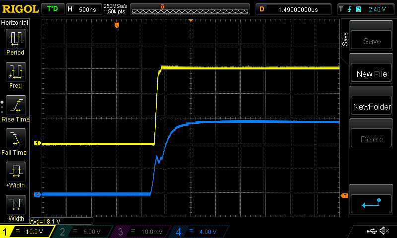

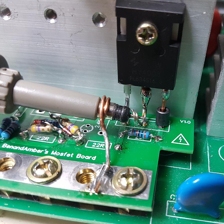

Ok, after getting a good probe setup, as seen below:
I now get excellent switch ON event voltages
And excellent switch OFF voltages
NO ringing anymore.
The setup is 10R gate drive resistor.
30V in, 15V @ 5A out
A small ferrite bead on the diode's anode (FET's source) pin.
Retain the 20K gate to source pulldown resistor, i.e. no short.
And a small ferrite bead on the switch source pin.
This is as good as I think it will ever be.
