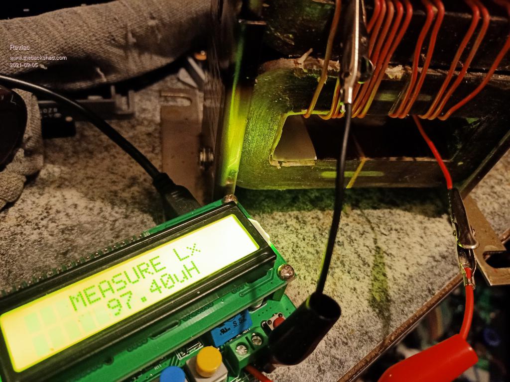

Now with 12 turns, I can see how it adds up, quite dramatic.
The little LC meter, Calibrated it each time as usual, tested with 12 turns and returned a reading of 74uH or something, so re-calibrated and tested 2 more times and got the desired result, apparently a wire contacting a finger will stuff up the readings, so best to check if not sure.
The air gaps are the same, I think the edge of the spacers are a little frayed.
94uH @ 391568Hz Close enough to the 97uH  would be some error margin with these meters.

That's the same meter I have, they measure a odd way which gives a consistent, but much lower reading.
From memory you can't change the frequency.
Have a look here https://www.thebackshed.com/forum/ViewTopic.php?TID=12027&P=33 Bottom of the page.

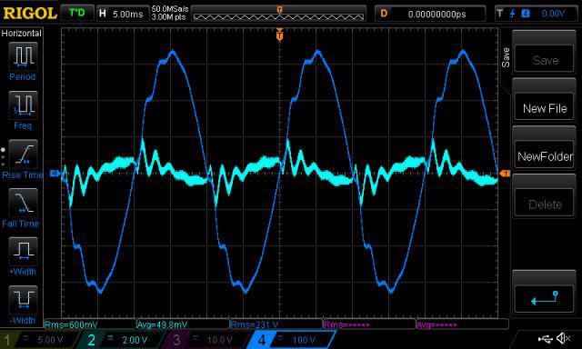

I would expect to see a horrible wobbly distorted waveform under no load, exactly as you describe.
The reason being the high series impedance of the choke decouples the transformer from the PWM waveform, which is what the choke is supposed to do. The greater the inductance the more free the transformer is to "do its own thing".
The transformer will have a natural resonance of typically a few hundred Hz, and that can be excited into ringing from a harmonic of 50Hz. These wobbles will be stationary because they are a direct harmonic multiple of 50Hz.
The resonant wobble below looks to be at about the tenth harmonic, probably 500Hz.
This is bad enough, but it can be a lot worse than this if its a lower harmonic.
People see this and realise its being caused by the choke, which it is, and think the choke is crap. That is entirely the wrong conclusion.
A good high inductance choke offers many benefits, but also creates an interesting new problem.
If you add capacitance across the transformer secondary, this obviously lowers the transformer resonant frequency. All that does is make the wobbles larger, as it now resonates at a lower harmonic where there is even greater energy to cause the wobbles.
But there is a trick !!
If you move the resonant frequency down to EXACTLY 1.5 times the inverter frequency (75Hz for 50Hz inverter) any slight resonant buildup of energy in one cycle ends up being out of phase and cancelled by the following cycle.
Its a kind of automatic self damping effect, and its very effective in reducing wobbles to the point where they are no longer visible.
This tuning process needs to be pretty precise to be effective, maybe 75Hz +/-1Hz works very well.  Just experimenting with a whole bunch of random capacitors will only make it worse.
The tuning process must be very deliberate and precise set to an accurate frequency.

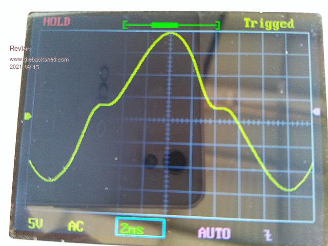

Found a photo of that choke when tested, can't find the notes I had written, but the photo was taken back about 2018 sometime, so there is a good chance that I never did check the resonance on that particular build at the time.
It was a lot worse before increasing the gap, before this photo was taken.
Each time the air gap was increased the sine wave improved, that gave me the idea that the uH was too high, there may well have been more going on than first thought at that time.....(still learning).
I plan on revisiting that one later.

Posted: 09:37am 15 Sep 2021
That waveform looks like magnetic saturation, not sure what is saturating though.
The only way to know for sure what is going on is to build a version of the choke saturation testing circuit.

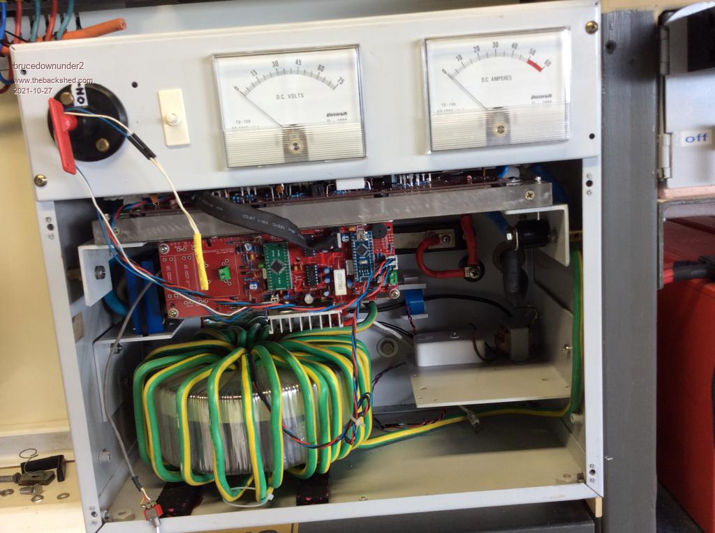

Hello Inverter builders.
Well, my 30 year old rectifier case has finally became a Busboy/Aaron inverter..well,nearly !
I've stripped the old rusty scavenged rectifier ,saved a few nice heavy trannies and lots of other parts .
 Hope to have it powered-up in a week ,thats a bruceweek,which often is very much longer than your normal week..
Oh, my good friend Aaron is the brains behind this project ,my 78 year old brain, is sort of corroded like some of my batteries !!!.

Thats looking very impressive Bruce, the old style gauges should be ok, most house loads are under 50A most of the time.

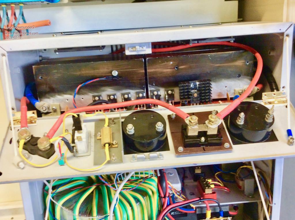

Time for an update.
Bruce sent some pictures of his inverter build, its almost finished.
I'm very impressed with the build quality, nicely done, every inverter build around here is a unique work of art.
Sure these thing's take some time to do a complete build, but it is a great adventure.

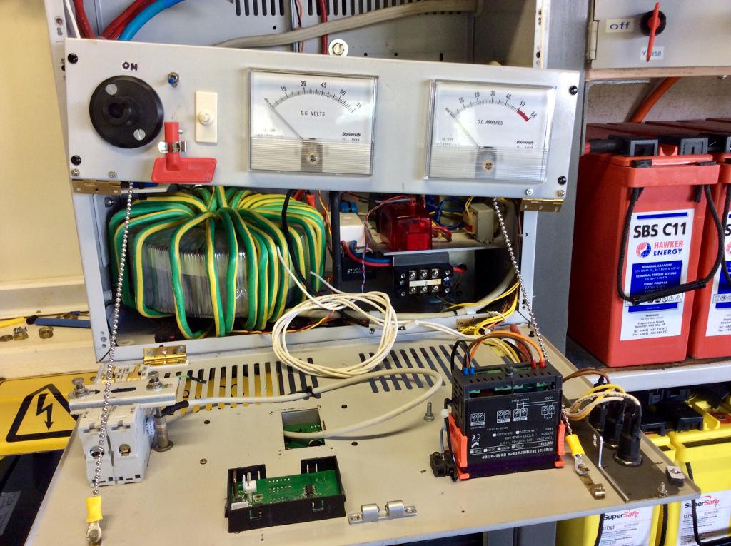

Nice, but that metal chain holding the door would worry me. You never know where the links go when the door is shut.
Better put some non conductive sleeve over it
Posted: 08:31pm 10 Dec 2021
That is a very neat well thought out build.  Well done !
Agree with Klaus, that chain has to go, fishing line or strong string maybe ?

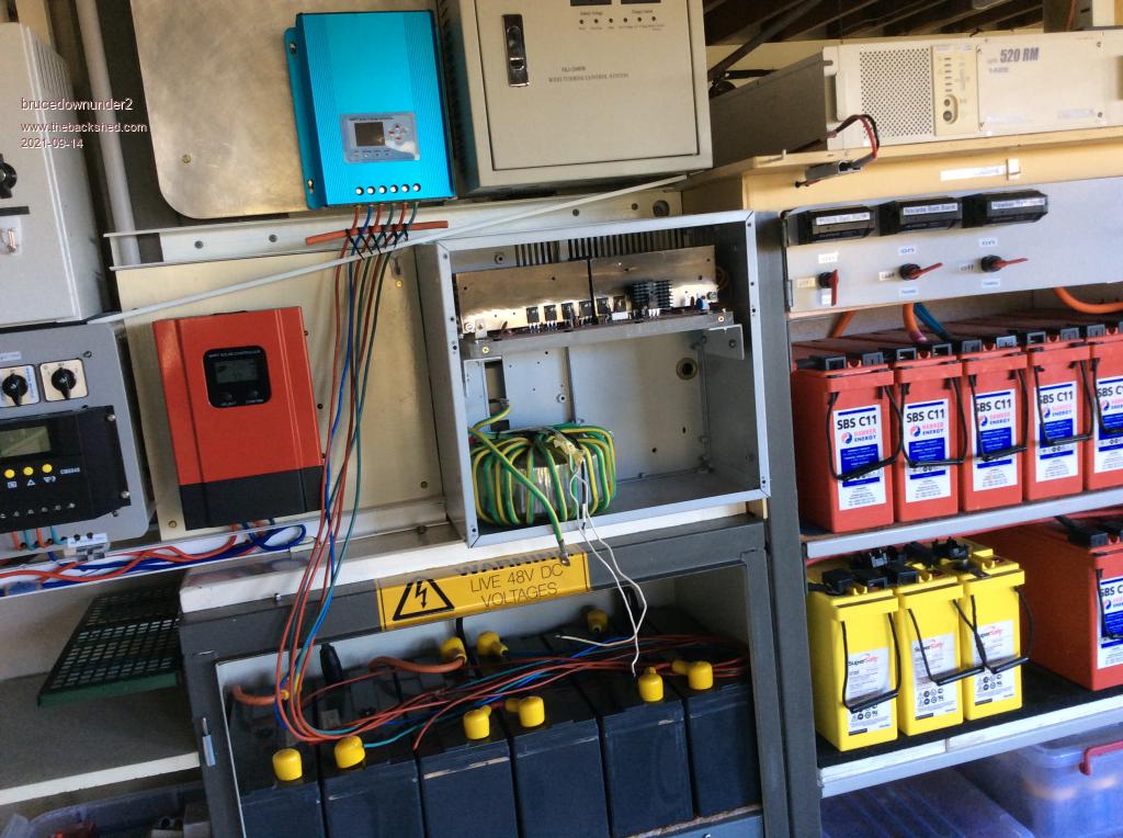

OK, thanks for the feedback , totally agree.
I have removed the small chain support and replaced it with that braided chalk line ,(polyester or something non-conductive).
This part was always at the back of my mind , but maybe I installed it just to get some progress with other parts..
Up to now , it's been a very satisfying project, very long winded, but with hospital every few days.travelling to and fro ,Etc. things around here take ages.(I have kidney failure in one, so that and other things take most of my time.
At this stage, I'd like to give a big "THANK-YOU,Aaron" for his support and assembly of the board for me....
I'm about to AC wire the inverter, breakers, external 8 way power distribution board ,Etc.( I'm retired15 years, so my sparky friend is keeping an eye on all things ,even though it's "stand-alone" exclusively. )

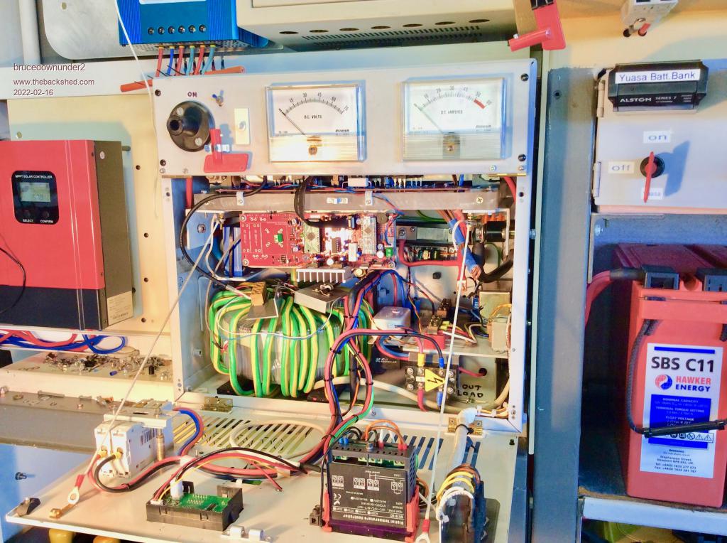

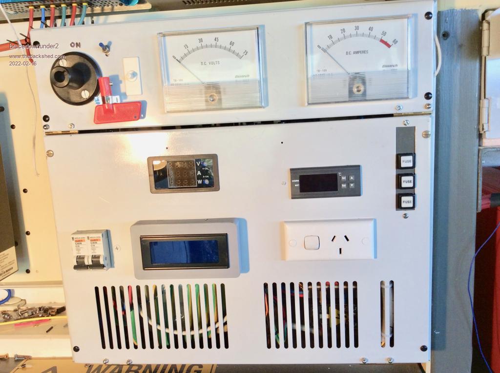

Hello Crew .  Looks like I have finished the inverter and all works .
Now I'm changing a display of the power being used from the batteries, so the panel mount digital display will be some time arriving.. (the only gripe I have with purchase of internet goods-never mind.)
It's been a nice experience building this inverter, my thanks going to the PCB designer and builder , and my good friend Aaron ,who, without his encouragement ,I may not have started, so a big thanks you to those two guys...
I built the inverter around an old Ericsson 48 volt rectifier  case I scrounged from work many years ago, stripping and sanding, painting.. Tight fit but after a few months of this and that , I somehow managed to make it very nice.
This project has taken me around 9 months, but not to worry , I'm very happy to see it finished,.
The unit itself has two hinged front panels, which allow me to service all the compact parts fairly easy and two fans in the top for cooling. All AC wiring is protected and adequate fusing is incorporated throughout .  Likewise with the DC cables .   I have an external earth leakage protected 4 way MCB housing that distributes light and power .
I'll post a couple of photos,

Happy to have helped with the build, Always like to see others put there own work and ideas into practice.
Certainly is a work of art with the effort and skills put into it.....Excellent Work.

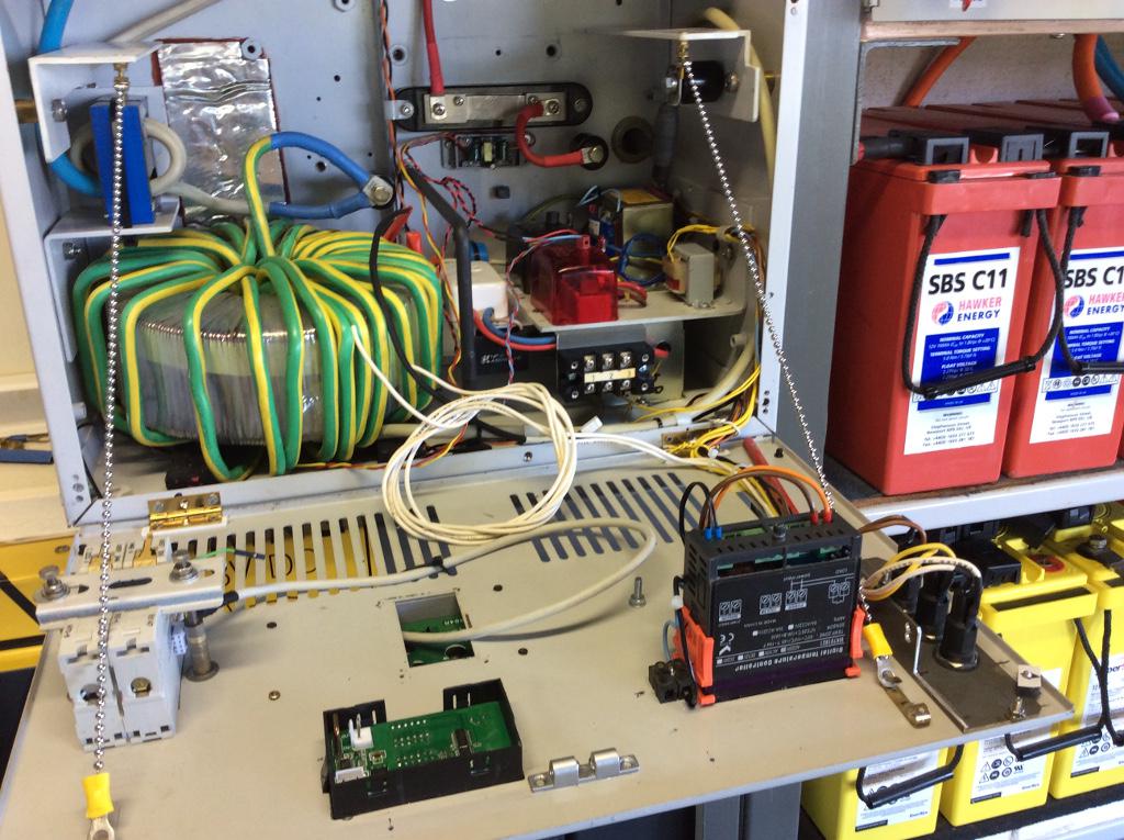

The inverter now has a power meter installed but appears to no be working properly...The new meter is a ...pzem -025 digital multi function meter, now it looks like it requires a 12V power supply unlike most others from the same maker.
Problems are, the current is not being read and the voltage is not reading correctly, it is powered by a voltage converter, I thought it might be floating the negative to the meter but after it was check with a meter there was only .3V between the battery negative and the negative out of the converter, so still not sure.
Found a video on aliexpress pzem -025 digital multi function meter
I Didn't see any voltage converter on the video, but it looked like they were reading 100V?
The video is a bit small and fast, difficult to understand.
Perhaps someone can look at the video more closely.....it would be so easy if it Didn't need the converter to run it.
Any HELP would be appreciated
