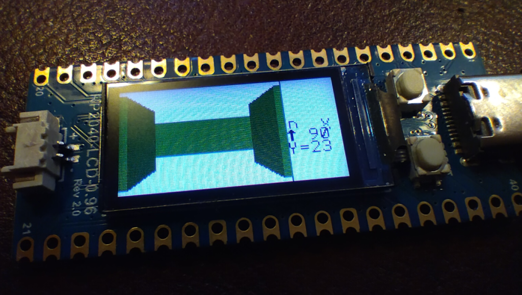

Hi Martin, thank you for the code!
I copied the program text out of your posting and pasted it in to the text file "maze.bas" - then I fired up MMEdit, loaded "maze.bas" and pressed F2 for "Deploy". After 5.3 seconds it was loaded into the RP2040. After that I take PuTTY to connect again and RUN the program.
It feels like DOOM but where is the gun?
-andreas

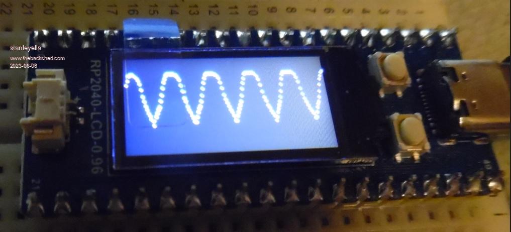

  stanleyella said  Mine arrived today. From Andreas I used his
OPTION LCDPANEL ST7735S, LANDSCAPE,GP8,GP0,GP9,GP25
It does graphics fine. Thanks all. Do I use above or
SYSTEM SPI GP10, GP11, GP12
LCDPANEL ST7735S, L, GP8, GP12, GP9, GP25
Hello Stan,
as Mick told you there is a even better configuration.
Currently I'm using this.
> option list
PicoMite MMBasic Version 5.07.07
OPTION SYSTEM SPI GP10,GP11,GP28
OPTION AUTORUN ON
OPTION COLOURCODE ON
OPTION HEARTBEAT OFF
OPTION DISPLAY 50, 100
OPTION LCDPANEL ST7735S, LANDSCAPE,GP8,GP12,GP9,GP25
Micks procedure to get there:
OPTION RESET
OPTION SYSTEM SPI DISABLE
SETPIN GP28 OFF
-andreas
Posts: 2807
Posted: 10:33pm 07 Jun 2023
Thanks Andreas, that worked ok and overclocking works ok.
This would be nice for a beginner as there is no wiring for a display.
Edited 2023-06-08 10:10 by stanleyella

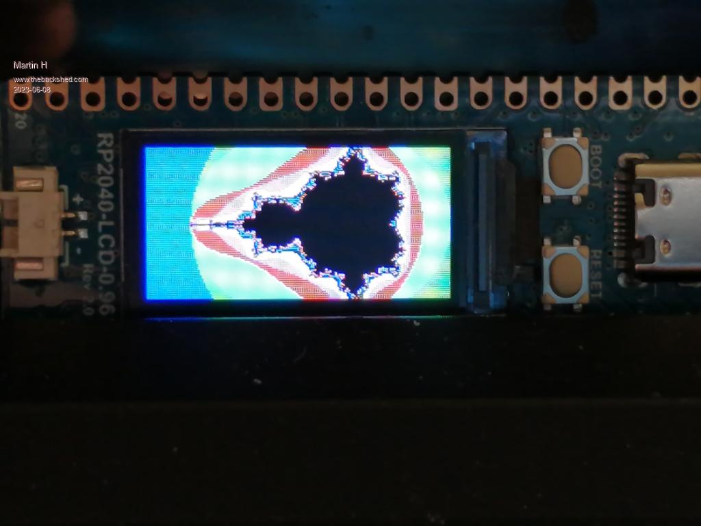

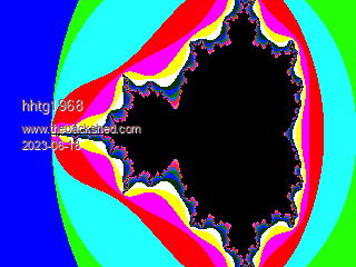

still testing
'Mandelbrot
' for 160x80 LCD
'inspired by Matt Heffernan s 8-BIT BATTLE
'https://www.youtube.com/watch?v=DC5wi6iv9io
dim col(16) as integer
Restore colors:For f%=1 To 15:Read col(f%):Next f%
CLS
' max x and max y
DX=160:DY=80
For py=0 To DY-1
For px=0 To DX-1
 xz=px*3.5/DX-2.5
 yz=py*2/DY-1
 x=0
 y=0
 For i=0 To 15
   If x*x+y*y>4 Then Exit For
   xt = x*x - y*y + xz
   y= 2 * x * y + yz
   x=xt
 Next i
Pixel px,py,col(i)
Next px
Next py
colors:
'--Colorscheme accordung to matherp
Data RGB(BLUE),RGB(GREEN),RGB(CYAN),RGB(RED)
Data RGB(MAGENTA),RGB(YELLOW),RGB(WHITE),RGB(MYRTLE)
Data RGB(COBALT) ,RGB(MIDGREEN),RGB(CERULEAN),RGB(RUST)
Data RGB(FUCHSIA),RGB(BROWN),RGB(LILAC)
actually the picture looks better than in the photo
Speed:
> option cpuspeed 127000
> RUN
22918.171
> option cpuspeed 252000
> RUN
11496.921
> option cpuspeed 378000
> RUN
7655.455
Edited 2023-06-08 16:55 by Martin H.

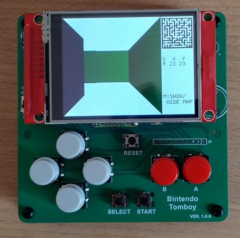

Posts: 4405
Posted: 06:55am 08 Jun 2023
Didn't want to be left out, but rather bigger (100mmx100mm) - don't need the keyboard though:
Martin H.
Joined: 04/06/2022
Posts: 1565
Posted: 06:58am 08 Jun 2023
  thwill said  Didn't want to be left out, but rather bigger (100mmx100mm) - don't need the keyboard though:
and much nicer
With the 320x240 LCD you could keep the Original Resolution so the map remained readable
good work Tom
Edited 2023-06-08 17:00 by Martin H.
'no comment
Posts: 4405
Posted: 07:15am 08 Jun 2023
  Martin H. said  With the 320x240 LCD you could keep the Original Resolution so the map remained readable.
Yes, this is a descendant of the version that I had running on the PicoGAME VGA.
It's a pity you never added the T-Rex.
Thanks for the program.
Martin H.
Joined: 04/06/2022
Posts: 1565
Posted: 06:59am 09 Jun 2023
Feel free to add Rex
But for "3d Monster Maze" you'll need another kind of maze with multible possible ways to the exit.

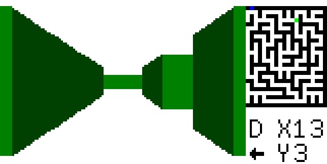

I have polished up the LCD version so that the maze is now displayed correctly.
'Maze Game by Mart!n Herhaus 2022
'Version for 160x80 LCD 2023
Font 1
cw%=RGB(white):WallC1%=0:WallC2%=RGB(RED):cP%=RGB(green)
'Read the XY-Coordinates of the Wall Elements Corners
Dim Wall%(6,4,2)
For N%=0 To 5 'Walls
For C%=0 To 3 '4 Corners
 For F%=0 To 1 '2 Coordinates (X,Y)
   Read Wall%(N%,C%,F%)
 Next
Next
Next
MazeW%=20:MazeH%=24
' create array and fill
Dim Maze$(MazeW%,MazeH%) length 1
restart:
For x% = 0 To MazeW%
For y% = 0 To MazeH%
 Maze$(x%, y%) = "#"
Next :Next
'generate random Maze
generator
MovDir$=Chr$(146)+Chr$(148)+Chr$(147)+Chr$(149)
Map%=0:CLS cw%
'place Player
PlrX%=MazeW%-1:PlrY%=MazeH%-1:PD%=3
'place Exit
Ex_X%=2:Ex_Y%=0:If Maze$(Ex_X%,1)="#" Then Inc Ex_X%
Maze$(Ex_X%,Ex_Y%)="E"
If map% Then Box 243+Ex_X%*3,3+Ex_Y%*3,3,3,,WallC2%,WallC2%
Colour 0,cw%
Text 122,58,"D  X "
'Text 244,130,"KEYS:"
'Text 244,140,"W:FORWARD"
'Text 244,150,"A:TURN L."
'Text 244,160,"D:TURN R."
'Text 244,190,"M:SHOW/ "
'Text 244,204," HIDE MAP"
' --- Game Loop ---
Text 122,70,Mid$(MovDir$,PD%+1,1)
Text 136,58,"X"+Str$(PlrX%)+" "
Text 136,70,"Y"+Str$(PlrY%)+" "
Draw_3D
Select Case PD%
 Case 0:XS%=0 :YS%=-1
 Case 1:XS%=1 :YS%=0
 Case 2:XS%=0 :YS%=1
 Case 3:XS%=-1:YS%=0
End Select
If map% Then Box 119+PlrX%*2,3+PlrY%*2,2,2,,cp%,cp%
Key$=""
Do :Key$=Inkey$:Loop While Key$=""
 Key$=UCase$(Key$)
 Select Case Key$
 Case "A",Chr$(130)
   Inc PD%,-1:Inc PD%,4*(PD%=-1):Box 0,0,120,80,,cw%,cw%
 Case "D",Chr$(131)
   Inc PD%:PD%=PD% And 3:Box 0,0,120,80,,cw%,cw%
 Case "W",Chr$(128)
   OX%=PlrX%:OY%=PlrY%
   Inc PlrX%,XS%:Inc PlrY%,YS%
   If Maze$(PlrX%,PlrY%)="#" Then PlrX%=OX%:PlrY%=OY%
   If Map% Then Box 119+ox%*2,3+oy%*2,2,2,,cw%,cw%
   Case "M"
   Map%=1*(Map%=0)
   If Map% Then
     Box 120,3,38,25,,cw%,cw%
     Show_Maze
     Box 119+Ex_X%*2,3+Ex_Y%*2,2,2,,255.255
   Else
   EndIf
End Select
If PlrX%=Ex_X% And PlrY%=Ex_Y% Then Exit
Box 10,15,99,48,,0,cw%
Font 7
Text 12,20,"   WELL DONE!   "
Text 12,28,"PRESS Q TO QUIT "
Text 12,36,"OR ANY OTHER KEY"
Text 12,44," TO TRY ANOTHER "
Text 12,52,"     MAZE       "
Font 1
If Key$="q" Then CLS 0:End
GoTo restart

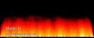

a little firey treat.
as it is able to Display more than 16 Colors
also runs on MM Basic for Windows or with other LCD types
H=80:W=160
Dim C(101) As integer
Dim Lne$(h,w) length 1
R=0:G=0:B=0
'Flamecolors
For f=0 To 100
C(f)=RGB(R,G,B)
Inc R,8*(R<247)
Inc G,4*(f>32)*(G<250)
Inc B,12*(F>80)
Next
CLS
'For f=0 To 159:Lne$(H,f)=Chr$(0):Next
 For f=1 To 50
 px=Int(Rnd*w):CL=Int(100-(Rnd*30))
 Pixel px,h-1,c(CL)
 Lne$(H,px)=Chr$(CL)
 Next
 For f=h-1 To h/2 Step -1
   For n=1 To 158
       cl=Asc(Lne$(f+1,n-1))+Asc(Lne$(f+1,n))+Asc(Lne$(f+1,n+1))
  cl=cl/3: cl=cl-(Rnd*5):If cl<=0 Then cl=0
  lne$(f,n)=Chr$(cl):Pixel n,f-1,c(cl)
  Next
Next
have a nice Weekend

I tried to write simple scope code for waveshare 2040 with lcd but it's rubbish. Had better results with 328.
Searched for scope code and not much.
How many samples could I expect at 378000 ?
Anyone made a picomite scope? This works... sort of, no sync.
 dim count%
 Dim samples!(160)
 Dim old_samples!(160)
 SETPIN GP26, AIN
 cls
 for count%=0 to 159
   samples!(count%)=PIN(GP26)'get new samples
 next count%
 for count%=0 to 159
   samples!(count%)=(samples!(count%)*20)+10 'scale 3V samples to 0 to 79 pixels
 next count%
 for count%=0 to 159
   old_samples!(count%)=samples!(count%) 'copy samples to old_samples
 next count%
 for count%=0 to 158
   line count%,samples!(count%),count%+1,samples!(count%)+1,1,rgb(white) 'draw first samples
 next count%
 do
   for count%=0 to 159
   next count%
   for count%=0 to 159
   next count%
   for count%=0 to 158
     line count%,old_samples!(count%),count%+1,old_samples!(count%)+1,1,rgb(black) 'erase old_sample
     line count%,samples!(count%),count%+1,samples!(count%)+1,1,rgb(white) 'draw new sample
   next count%
   for count%=0 to 159
   next count%
 loop
end

Use the ADC command and you will get up to 500,000 samples per second
hhtg1968
Joined: 25/05/2023
Posts: 244
Posted: 07:16pm 17 Jun 2023
to martin h:
this is the look alike on picomiteVGA:

  matherp said  Use the ADC command and you will get up to 500,000 samples per second
Hi Mathew. Thanks but replaced reading pin for command and NOT the same, if it does anything.
 'SETPIN GP26, AIN
adc open 1000,1
 cls
 'for count%=0 to 159
   'samples!(count%)=PIN(GP26)'get new samples
   adc start samples!(160)
 'next count%
I tried adc start samples!() and no display
"The size of the arrays defines the number of
conversions." so dim samples!(160) is 161 samples
Edited 2023-06-18 06:52 by stanleyella

  Quote  I tried adc start samples!() and no display
Look at Volhout's posthere
Posts: 2807
Posted: 10:12pm 17 Jun 2023
Cheers but I don't see the relevance. From the manual it should fill the array with samples, or maybe not.
To add joy I can't get pwm working
setpin gp2, pwm 1
pwm 1,1000,50,50
RUN
[8] PWM 1,1000,50,50
Error : Pin not set for PWM
I'm using gp0, gp1 for sound.
I wanted to drive the scope with a wave from tone then try from pwm.
Posts: 9194
Posted: 06:06am 18 Jun 2023
You can always recover a pin before doing something else with it:
SETPIN GP0, OFF
ADC keeps reading the pin and putting it into the array, at the speed you set. It does it in the background so it's very fast. Once the array is full it stops running, so you can plot that array then restart the ADC for the next set of points.
Follow Volhout's code for the ADC:
Set the ADC frequency (he's used  formula because of what he's doing. You don't need to)
Dimension a float array for the number of samples.
ADC open adc_freq, 1, ready_int opens the ADC for 1 channels and trigger interrupt when array is full.
ADC start array!() starts the ADC run and stores the values.
DO:LOOP We do nothing here, just wait for the ADC.
END
At the end of the scan the interrupt routine runs. You plot the values here.
Sub ready_int
ADC close
End Sub
You'll have to tweak things a bit because you want to keep re-trigggering the ADC after each plot, I suppose. For a scope you would often use a Trigger input to start the scan. Or you can keep triggering it automatically after each plot.
Posts: 2807
Posted: 02:49pm 18 Jun 2023
Thanks Mick,it's working better.
