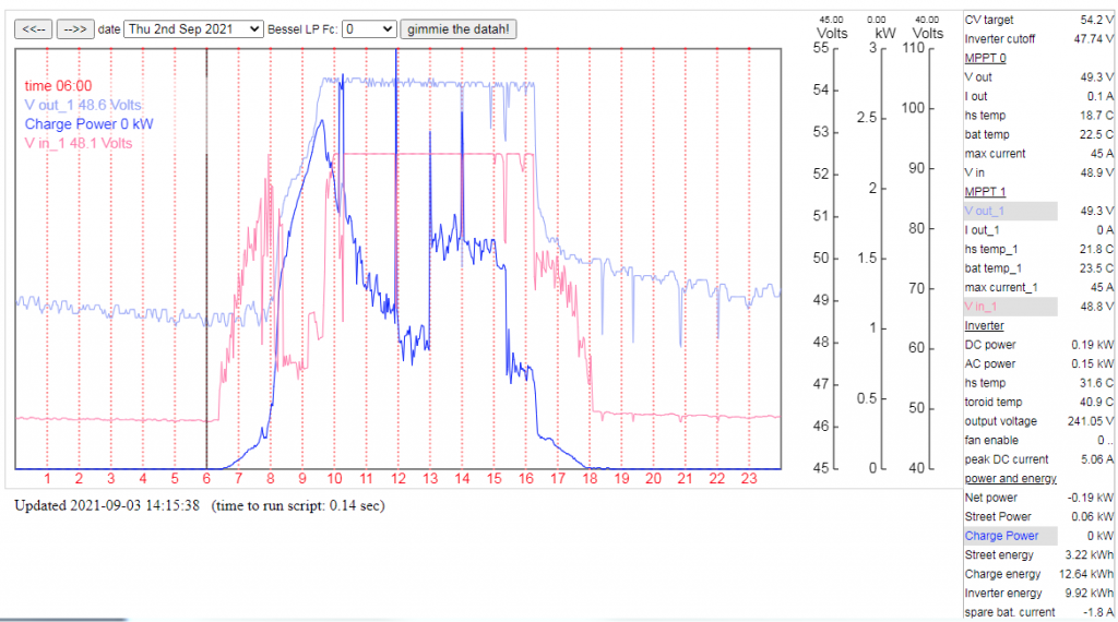

flyingfishfinger
Joined: 12/09/2020
Posts: 120
Posted: 11:14pm 02 Sep 2021
Thanks for the files, I'll give it a try!
For the other question - yes, buck converters only work when Vin > Vout + Vdropout - that's clear.
  Quote  I estimate about 1 volt.
That's pretty good from an electrical engineering perspective for something homebuilt / discrete, nice.
What I was wondering about though, and your answer doesn't quite make clear to me yet is this:
  Quote  If it was running in MPPT or ABSORB, and input drops below setpoint,
it goes to NIGHT mode and stops the converter
If the device is running in MPPT mode and find the MPP is lower than the set point, it enters night mode, okay. However, then we're no longer drawing a load from the cells, so the voltage rises as we travel up the IV curve. Then we exit night mode.... wouldn't we then oscillate in and out of night mode?
I must be missing something here, or is the above the accepted operating mode when conditions are marginal?
R
Edited 2021-09-03 09:17 by flyingfishfinger
Posted: 11:32pm 02 Sep 2021
What happens is the maximum power voltage never changes much from dark to mid day.
What does change is the panels ability as a current source to supply current.
What the MPPT software does is to increase/decrease the loading on the panels to hold the voltage at the max power point (whatever that voltage happens to be).
As sun power diminishes at dusk the MPPT finds that to hold the voltage up, less and lass current is available. Eventually the duty cycle falls to zero.
As it gets even darker, the voltage falls further, even though there is zero load current on the panels.  It cannot cycle, it just slowly fades away and shuts down for the night.
flyingfishfinger
Joined: 12/09/2020
Posts: 120
Posted: 11:37pm 02 Sep 2021
  Warpspeed said  What happens is the maximum power voltage never changes much from dark to mid day.
Ok, that was the missing piece. So if the max power point is below the set point, I'm hosed either way.
Thanks for the clarification!

here is data from the MorningStar 60A MPPT controller I had first
before the home built mppts.
I show what it calls Sweep Vmp and Sweep Voc  (V max power and V open circuit)
They use a different scale than battery voltage.
They are also maximum values found during the mppt sweep.
So it's likely Voc was maximum at the start of the sweep when
very little power was sent out to the battery.
But once the dc-dc converter starts, the input voltage surely drops to
BV - MOSFET/diode drops
During the early morning Voc was 53.17V, battery was 48.46V so let's rock and roll
and make power! The power generated then was 10W.
I think you are examining these borderline conditions, am I correct?
Similarly, data for my mppts is below:
we can see Vin is about 0.5V less than Vout (or battery, same thing) at 6am
when it is still rather dark here.
Note again different voltage scales. The vertical line is at 6am and the exact values
are shown on the left side at that time.
Please ignore the charge power curve. It is the sum of two 3kW arrays,
one not making any power, the other doing most of the work.
I can explain what's going on with this curve but that will be a long story
and we can't have much interest in that right now...
My mppts will be checking every minute at all times if Vin > Vout.
IF so, do the mppt scan and run the converter
If not, wait a minute.

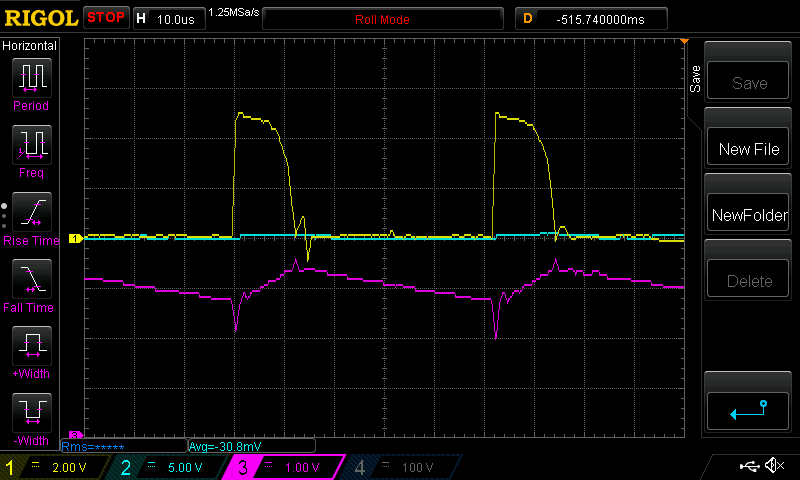

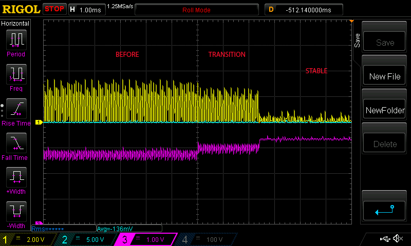

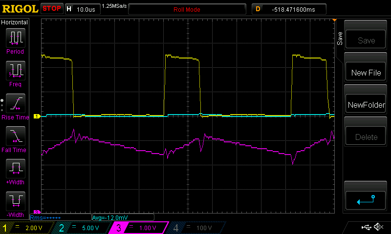

Here are some DSO captures of the short on the output event.
Yellow is PWM signal going to the TLP-250 input diode
Purple is the current sensor output after the trimpot divider,
which is also FET gate voltage.
Light Blue is not connected.
This is the event before & during the short.
The graph is not nice to see due to the huge time compression.
No idea why the current is constant during transition period.
Would it not increase steadily? (edit: this is due to the time taken
for the "switching" of the screwdriver short-out. Sometimes there is
no transition 'cos I was much faster with the screwdriver)
Close up of before short.
Transition.

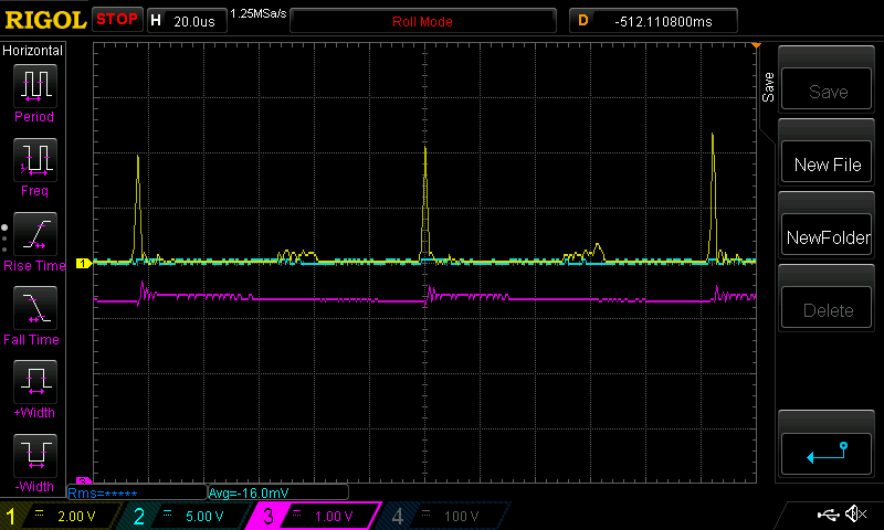

Close up when things are stable. It's alternating a short pulse then
a nearly nothing pulse.
You can see the current sensor output/Gate voltage rise to the
required voltage for the IRFZ44N to conduct the 5V PWM drive
This voltage appears to be 3.3V or thereabouts.

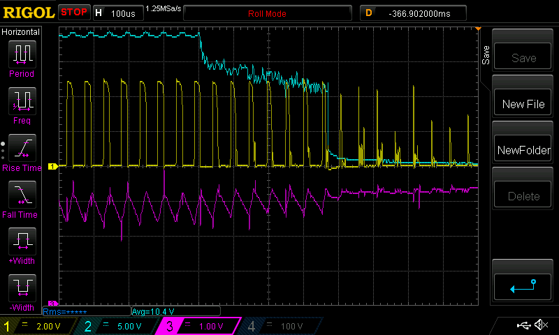

Finally here is a capture of when the screwdriver made contact.
(the Gate voltage now shows effects of too low drive current thanks to
the trimpot's setting. I had it set at about 35 Amps max current)
The left most pulses are when inductor current is below 35 Amps
The middle pulse is the first to be altered by the FET
And the last 2 are clearly getting smaller.
(For those who may not know, pulse width is proportional to inductor current.
Longer pulses means higher current)
Since the Gate voltage trace is 1V/div, and the threshold is about 3.3V
the equivalent current is 10 Amps/div approx.
We can see the current rise rise from about 25A to 35A over 5 pulses
or 250 uS
The combined response time of the LEM sensor and the FET seem to be more than
fast enough for this task.
