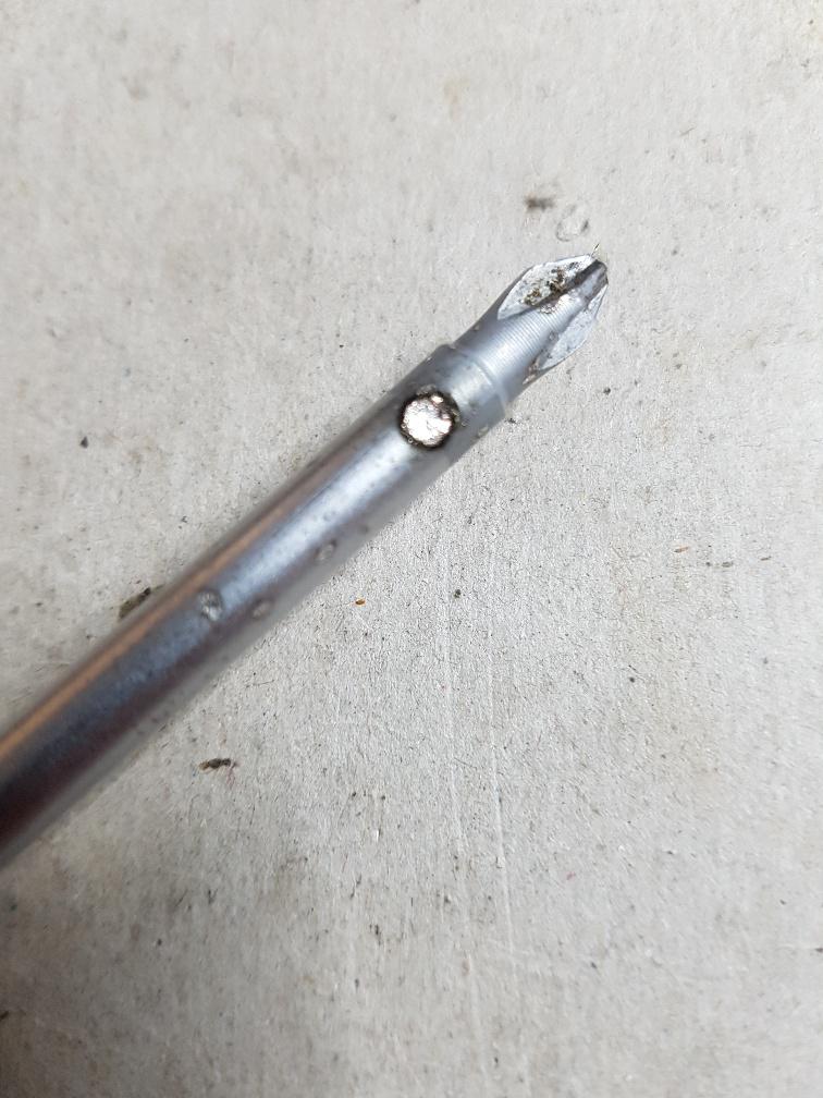

The damage to the screwdriver:
All in the name of science. (as Photinicinduction would say)
Code changes now look for a short and modify the PID loop
whilst shorted. This prevents voltage overshoot when the short is removed.
This is a great start for a home brew big current, big voltage power supply
for the bench and ebike charger.
I want well over 60V and 20 Amps and for it to be indestructible.

reminds me of the time I dropped a screwdriver on a 48v bus bar before the fuses... literally made the section between contact points disappear,  never found it..
and it was a big screwdriver...
lesson learned,  moved + and - much further apart..
I think it works !!

Noneya, big current can be impressive.
And when it's DC, it is even a better show.
My only, so far, mistake was to let a nice 13mm ring spanner
short a + and - on a 4 x 200AH SLA bank at 24V. It only just chewed
a little off the side of the handle.
During testing of the above, I had the firmware not looking for short circuit
and just trying to attain the voltage setpoint, while the FET/current sensor thing
was doing it's thing.
I could set the OC protection to about 35 Amps and let the screwdriver graze
a conductor and nearly maintain an arc. 35 Amps at less than 0.5V is not impressive
but it still bites a hole in the metal.
All this and not blowing up 2x nice MOSFETs.
Maybe I could adapt this to be a TIG welder..probably not.

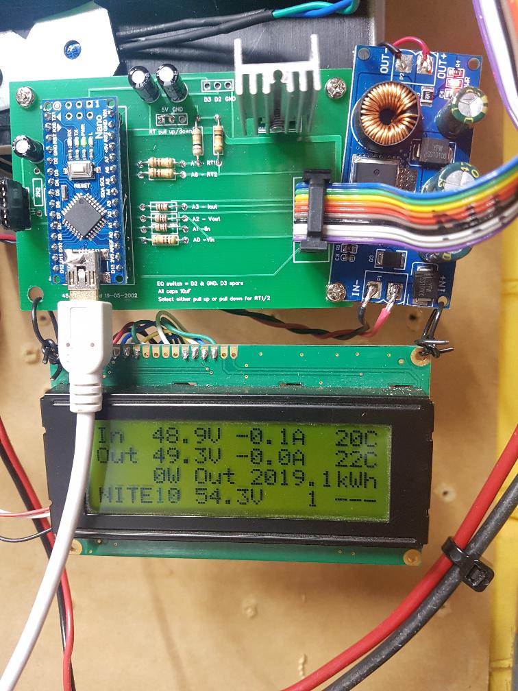

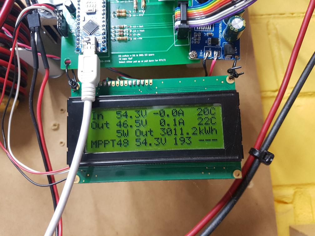

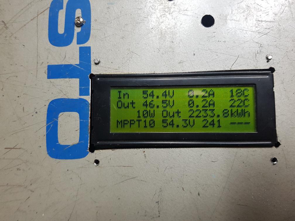

Milestone time again.
I must again thank you all here for your help in developing this project.
I run two of these mppt controllers.
One has a 3kW array facing East
One is 3kW facing North.
The East facing array:
and the North facing array:
They just work and work well.
3 MW.hr of energy has passed through them.
And with an efficiency better than 92%, frequently
in the 95%.
Heat sink temps never more than 35 - 40 C
The North array mppt controller gets to 45 Amp limiting conditions
often, but for short periods of time now it's nearly Summer.

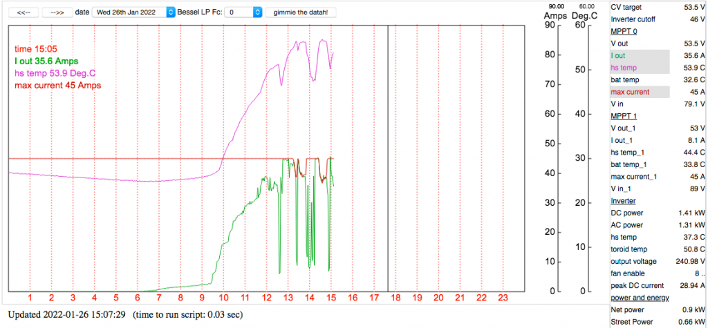

Today it is hot.
the mppts are working well and I have one doing a lot of work
and so the heat sink is getting hot.
I have the output current throttle setting to start at 55 DegC
to reduce output current limit from 45 Amps to zero Amps at 65 degC
It works well. We can see the output limit become lower as the HS temp
exceeds 55 degC and the output current flow suit, never exceeding it.
It's also a bit cloudy so there is not enough power
some times.
data from today so far:
output current is Green
Heat sink temp is Purple
Output current limit is Orange

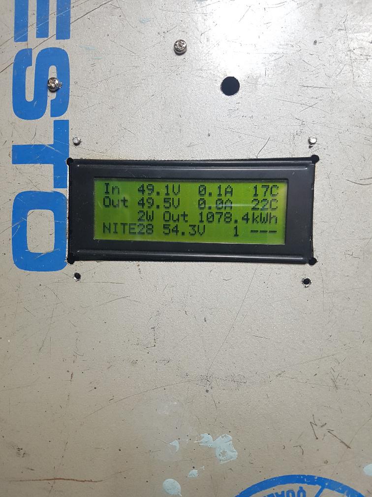

Posted: 07:39am 30 Apr 2022
milestone time again
5 MW.Hr from the two mppt controllers.
Both working without any issue
So pleased to see this
I can reconfigure them while they are running via the serial ports
that are connected to the raspberryPi and I did this remotely from work.

  poida said  milestone time again
HaHa, funny typo, one would think you have a personal power station there .
Your two MPPT's are a lot busier than my single one. It just passed 1100KWh, running with no problems. Back when we had those really hot days the fan came on a few times but had no trouble cooling it while it was charging at 50Amps.
This project was a lot quicker to get going than my inverters were .

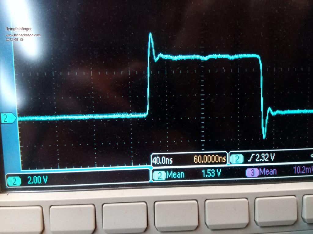

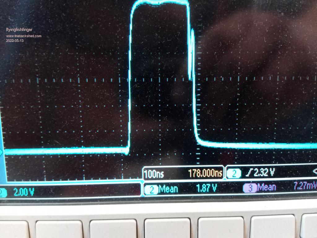

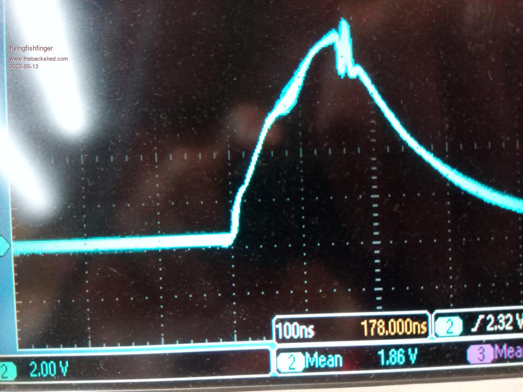

So I finally got around to firing up some test code. First off, it works! Yay!!! But I have some questions.
I'm using the code that was posted for testing, the DCDC converter code (buck_converter_nics_1_b4_nano_pwmserial_bb), but I modified it for use with my Nanocontroller with I2C LCD.
Upon running it, I found that both the input and output voltages read by the Nano do NOT correspond to the actual voltages. The input voltage seems to read a good ~10V higher than it actually is. Also, the current readings are negative.
I've checked my input (and output) voltage dividers, they're correct according to the Powerboard BOM & schematic I have (R5 & R7 are 47k, R6 and R8 are 2.7k).
But that means the scaling coefficients in the code are wrong (also, if the voltage dividers for Vin and Vout are the same, why are the scaling coefficients different?).
For xVin the code has 0.1564 and for xVout it has 0.102. The latter is NEARLY right, it results in the reading being about 1V too high.
Then I saw one post where you said it should be 1k and 47k to get a higher input voltage range, but the xVin coefficient doesn't work for that either.
So I "fixed" the coefficients and put in xVin=0.234 (using the 1k resistor) and xVout=0.09 (using the 2.7k resistor).
For the current sensors, the coefficients are also odd. The offset should be 0.6V, but is set in the code (oIin and oIout) to 127, which is a bit higher than 0.6, so the "zero" current reading is negative. I reduced it to 122. Then, the scaling seems a bit off as well: An ACS758 which I have used puts out 60mV/A over a 5V range, so the scaling should be 0.0816 instead of 0.792...I think.
These are better, but I think I can dial them in even closer.
Question: Were these values meant for different current sensors or a different setup?
I tested this up to 120W for the moment, since my benchtop power supply will only put out 5A.
I checked out the PWM waveforms. Out of the Nano:
Output of the optocoupler before series resistor (note different time scale):
Gate of the MOSFETS (after series resistor). This one looks odd, but after reading the datasheet for the FDH055N15A, it's actually not that bad. The normal turn-on delay is 35ns and the turn-on time is supposed to be 67ns....which is about what we see here.
Question: 100ns on time seems very short for this MOSFET. But these screenshots might have been measured with NO load, so having basically 0% duty cycle makes sense for this case. Am I right there?
How do you characterize inductor saturation? Shunt / clip current probe? Will look at it again under load.
you need to change the calibration factors within the code to suit.
eg:
Vin reading is 50V but measures 40V so you alter factor for Vin by 40/50 X existing value
I have done this numerous times for the 4 different board I built.
poida
Joined: 02/02/2017
Posts: 1515
Posted: 11:00am 13 May 2022
the values were for my particular boards.
they are not meant for anything in particalur.
I figured others who might use this would use actual volt meters on input and output
and current sensors etc and measure what they find.
This is what you have done already and it's the way to go.
The 100ns on time is not meant to do anything at all just keep running as it were.
This is a minimum PWM width and probably generates very little output voltage.
Typical PWM widths can be calculated from your DCV input and DCV output.
It is the ratio of Vin and Vout
eg.
60V in
30V out
PWM will be 30V/60V or 50% or about 400 clocks or 10us approx.
This is a reasonable working value for PWM
In my case it's more like 75V in, 50V out so it's 50/70 or about 570 clocks
(I've had a few drinks and so the maths could well be RONG)
the waveforms look fine and include some inductance from the CRO lead earth clips I think. This is not a problem.
