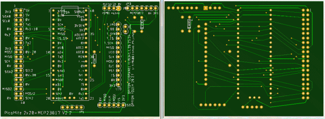

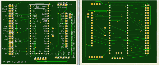

Posted: 07:38pm 23 Jun 2021
  Mixtel90 said  I'm starting to feel the urge to design a replacement MicroMite backpack pcb to take the PicoMite instead of the MX170. :)
Probably premature, and not exactly MM2 backpack style, but I think all the parts are now in place (PCBs untested).
PicoMite hat with SPI LCD (ILI9341 or ILI9488), SD module, ESP-01 module, RTC module and 20x2 expansion port allowing 2 Com, 2 I2C, 2 SPI ports, 3 ADCs, PWM and a few free pins:
Gerbers (for sending to, for example, JLCPCB.com): picomite_mcp1.2_2021-06-23.zip
Eaglecad sch & pcb files: picomite_1.2.zip
And the same with a socket for an MCP23017 module to add 16 more (simple) I/Os:
Gerbers: picomite_mcp2.2_2021-06-23.zip
And Eaglecad files:picomite_mcp2.2.zip
JLCPCB cost for 5 of the first and 10 of the second with slow boat shipping to Canada, $21.39US.

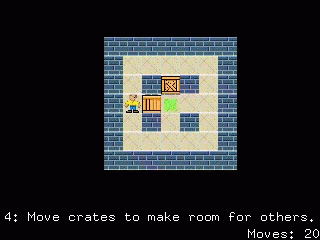

Posted: 12:54am 24 Jun 2021
VegiPete's CrateAway on the Picomite
Zip file with capico.bas and .bmp files for sprites:
capico.zip
Program also runs on F4 with SPI ILI9341 and on the CMM2 in the CrateAway15 folder along with CrateAwaySprites.png and GetFileDialog.inc.

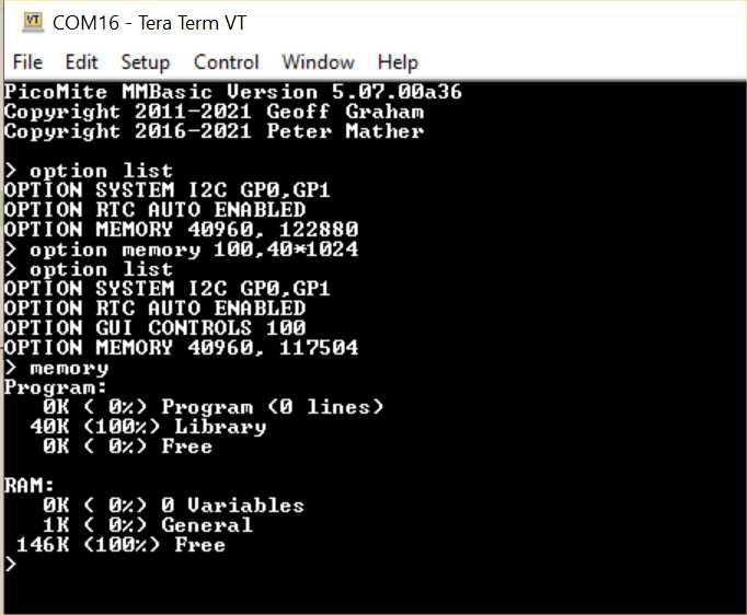

Posted: 09:21am 24 Jun 2021
a26
PicomiteV5.07.00a36.zip
Preparation for GUI implementation and memory flexibility - please test
Couple of new commands
OPTION RTC AUTO ENABLE/DISABLE
With this option enabled the system will load the time from the RTC on boot up and every hour thereafter. If the option is enabled and the RTC is not connected then a warning message will print each time it attempts to update the time unless a program is running in which case a hard error is generated
OPTION MEMORY No_of_GUI_controls, program_memory_size
The PicoMite memory is now treated as a pool of 160Kbytes which can be flexibly allocated by the user. This command is how it is allocated.
By default there are 0 GUI controls and 80Kbyte of both program and variable memory
Each GUI control will take 52 bytes and the memory required will then be rounded up to a 256 byte boundary
The program memory size can then be up to half the remaining memory out of the 160K. It cannot exceed half as the program would then be unable to be edited or loaded
Posts: 6220
Posted: 09:36am 24 Jun 2021
@Peter: I understand you want to give people much flexibility in memory assignment, but it may confuse.
i.e. the 10 flash slots can contain various programs, should each of these programs control it's own memory map.. guess not... would require a cold/warm boot, so chaining may become impractical.
I probably will leave the settings at the defaults always, just to make sure it always works, and for everybody.

Posts: 12096
Posted: 10:13am 24 Jun 2021
You can only use the defaults if you don't want GUI functions. The GUI memory has to come from somewhere
