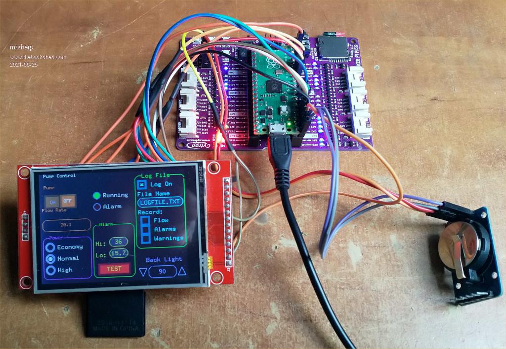

Posts: 12098
Posted: 09:06am 25 Jun 2021
a37
PicomiteV5.07.00a37.zip
NB: file replaced at 10:40 UTC
I think I've removed the bug from OPTION MEMORY
Full GUI functionality now implemented
DISTANCE function now implemented (Take care HR-SR04 need 5V and PicoMite pins are not 5V safe - use a level converter)
NB: FLASH commands should work OK independent of MEMORY setting. Flash spacing is always 80K but save and load are based on the setting of the MEMORY option
' Demonstration program for the Micromite+
' It does not do anything useful except demo the various controls
' Modified for ILI9341 by Phil23
' Geoff Graham, October 2015
Option Explicit
Dim ledsY
Colour RGB(white), RGB(black)
' reference numbers for the controls are defined as constants
Const c_head = 1, c_pmp = 2, sw_pmp = 3, c_flow = 4, tb_flow = 5
Const led_run = 6, led_alarm = 7
Const frm_alarm = 20, nbr_hi = 21, nbr_lo = 22, pb_test =23
Const c_hi = 24, c_lo = 25
Const frm_pump = 30, r_econ = 31, r_norm = 32, r_hi = 33
Const frm_log = 40, cb_enabled = 41, c_fname = 42, tb_fname = 43
Const c_log = 44, cb_flow = 45, cb_pwr = 46, cb_warn = 47
Const cb_alarm = 48, c_bright = 49, sb_bright = 50
' now draw the "Pump Control" display
CLS
'setpin 18,dout
'pin(18)=1
GUI Interrupt TouchDown, TouchUp
' display the heading
Font 2 : GUI Caption c_head, "Pump Control", 10, 0
Font 2 : GUI Caption c_pmp, "Pump", 10, 25, , RGB(brown)
' now, define and display the controls
' first display the switch
Font 2
GUI Switch sw_pmp, "ON|OFF", 10, 45, 70, 30, RGB(white),RGB(brown)
CtrlVal(sw_pmp) = 1
' the flow rate display box
Font 2 : GUI Caption c_flow, "Flow Rate", 5, 75,, RGB(brown),0
Font 2 : GUI Displaybox tb_flow, 5, 100, 105, 25
CtrlVal(tb_flow) = "20.1"
' the radio buttons and their frame
Font 2 : GUI Frame frm_pump, "Power", 5, 140, 105, 90,RGB(200,20,255)
Font 1
GUI Radio r_econ, "Economy", 20, 160, 10, RGB(230, 230, 255)
GUI Radio r_norm, "Normal", 20, 185
GUI Radio r_hi, "High", 20, 210
CtrlVal(r_norm) = 1 ' start with the "normal" button selected
' the alarm frame with two number boxes and a push button switch
Font 2 : GUI Frame frm_alarm, "Alarm", 115, 115, 90, 115,RGB(green)
Font 1
GUI Caption c_hi, "Hi:", 120, 150, LT, RGB(yellow)
GUI Numberbox nbr_hi, 150,MM.VPos-6,40,MM.FontHeight+6,RGB(yellow),RGB(64,64,64)
GUI Caption c_lo, "Lo:", 120, 175, LT, RGB(yellow),0
GUI Numberbox nbr_lo, 150,MM.VPos-6,40,MM.FontHeight+6,RGB(yellow),RGB(64,64,64)
GUI Button pb_test, "TEST", 125, 200, 70, 25,RGB(yellow), RGB(red)
CtrlVal(nbr_lo) = 15.7 : CtrlVal(nbr_hi) = 35.5
' draw the two LEDs
Const ledsX = 125, coff = 50 ' define their position
ledsY = 50 : GUI LED led_run, "Running", ledsX, ledsY, 8, RGB(green)
ledsY = ledsY+25 : GUI LED led_alarm, "Alarm", ledsX, ledsY, 8, RGB(red)
CtrlVal(led_run) = 1 ' the switch defaults to on so set the LED on
' the logging frame with check boxes and a text box
Colour RGB(cyan), 0
GUI Frame frm_log, "Log File", 210, 10, 110, 160, RGB(green)
GUI Checkbox cb_enabled, "Log On", 215, 20, 20, RGB(cyan)
GUI Caption c_fname, "File Name", 215, 45
GUI Textbox tb_fname, 215, 60, 100, 20, RGB(cyan), RGB(64,64,64)
GUI Caption c_log, "Record:", 215, 85, , RGB(cyan), 0
GUI Checkbox cb_flow, "Flow", 220, 100, 20
GUI Checkbox cb_alarm, "Alarms", 220, 120, 20
GUI Checkbox cb_warn, "Warnings", 220, 140, 20
CtrlVal(cb_enabled) = 1
CtrlVal(tb_fname) = "LOGFILE.TXT"
' define and display the spinbox for controlling the backlight
GUI Caption c_bright, "Back Light", 230, 190,,RGB(200,200,255),0
GUI Spinbox sb_bright, 210, 210, 110, 25,,,10, 10, 100
CtrlVal(sb_bright) = 100
' All the controls have been defined and displayed. At this point
' the program could do some real work but because this is just a
' demo there is nothing to do. So it just sits in a loop.
